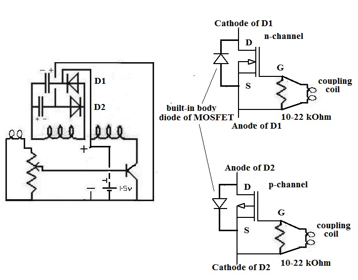

Hi hotrod68r,Originally posted by hotrod68r View Posthi gyula. thankyou also for your input and the merlib rv. pointer. i read "cancelling lenz laws-methods", overunity.com. wondering if synchronous rectification with mosfets, or something like it could replace the diodes and/or could a transistor be timed to play with coil shorting in my current setup to reduce the deficit ? cheers.
I edited your schematic to show a possible 'syncronous rectifier' solution to place first in parallel with one of your existing diodes so that you could see its positive effect what hopefully happens: the resultant rectifier will have a less than 100-150mV drop only instead of the present 300-350mV your diodes have.
The 100-150mV drop is a rough and worst case estimate from me, this depends on entirely the ON channel resistance of the MOSFET used. Say you use N-channel type BS107A it has ON resistance under 10 Ohm, 2N7000 has about 5 Ohm, BS170 has 1.2 to 5 Ohm, these all have TO-92 casing (not SMD style).
For P-channel types there are BS250 with about 9 Ohm, known also as TP0601L or T, VP0610L or T, the case style is also TO-92.
Of course there are many many other types, I deliberately choose the some hundred mW dissipation types with max 150-400mA drain current ratings because these have much smaller inner capacitances than the power MOSFET types. You can use what you can obtain easily, if you write which big component seller you prefer (Farnell, RS Components, Digikey etc etc), I will try to look for what I think is good here, ok?
All you would have to do is build a P-channel and an N-channel circuit as shown in my drawing, the coupling coil could be similar to the one you now use for the bipolar NPN transistor, you would two more of them. the resistors across the gate-source pins helps to discharge the gate capacitance to speed up the switch-off of the MOSFETs. The N-channel MOSFET will switch-on for the positive waveform of the oscillating AC wave and the P-channel MOSFET will do it for the negative parts of the AC waveform, I assume normal zero-crossings in the induced waveforms. Observe the placement of the N and P channel types with respect to your D1 and D2 diodes.
Gyula
