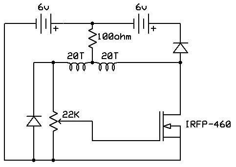

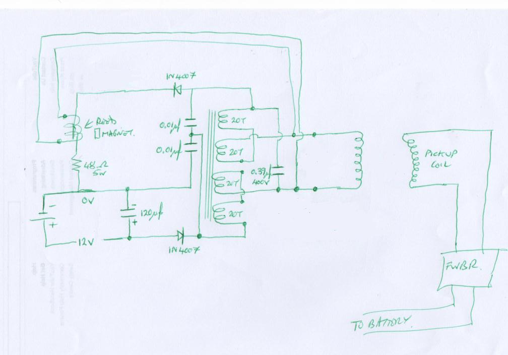

          • hi janost and all. i got this from another thread on this forum.the contributor said that it had been running for months and recommended having 2 bats in series,driving the circuit with b1 and return going to both.then b2 was said to drive a smallish load indefinitely.(not sure about a reed switch lasting indefinitely though).

                • Originally posted by hotrod68r View Post
                  Hi hotrod68r,
                  Thanks for this, it would be a good test to run this setup on capacitors to see how they charge up or discharge... Also the high wattage resistor in series with the reed switch may dissipate valuable power that never gets out to the output I think.
                  Regarding your notice on replacing the diodes with controlled rectifiers (i.e. MOSFETs) I think yes and I will draw a possible circuit for it. But I do believe that by adding a 6 or 7uF poly cap in parallel with your collecting coils may cause a more useful inner LC impedance increase (loaded Q of the tank may get higher) and this may involve higher gain than reducing the diodes losses.
                  Of course, no need for adding the full switching circuit shown in the rv schematic, only to test the 3 capacitors method for energy extraction from the LC tank and this involves adding a single cap in your case, that is all I think. The 3 capacitor ratio as shown insures that the LC tank would not be overloaded by the load from the transistor whenever it is ON.
                  Thanks, Gyula
                    Yes, I'm also experimenting with a dual battery setup at the moment.
                    It improves the charging because the charged battery is not under a load.
                    • This is ingenious.
                      Why didn't I think of this before?
                      When the coil charges it does so from the left battery only.
                      When the coil kicks back, it drives current through the diodes to both batteries and balancing the charge between them
                      • If I dont get any balancing between the batteries they may need to be connected in parallel with one connected to the diode on the gate?
                        • This works extremely well.
                          I started with the left battery at 3.62v and the right battery was at low level of 1.55v
                          The left battery is still at 3.62 and the right one has climbed to 1.7v
                          • Originally posted by janost View Post
                            You do not readily get balance between the two batteries because the run battery first loses charge and receives it back from part of the collapsing field so ideally it stays on level but the other battery continuously receives charge and does not lose in this process.
                            What counts it can only turn out on the long run: will the run battery gradually lose its charge or stays on its starting level? This is a long process to test, you may wish to use high value capacitors instead of the batteries to speed up this.
                            Gyula
                            • Originally posted by gyula View Post
                              Gyula
                              If you look close at the schematic the collapsing field is across both the batteries in series.
                              • Oops, you are right, I disregarded the diode on the left for a moment...
