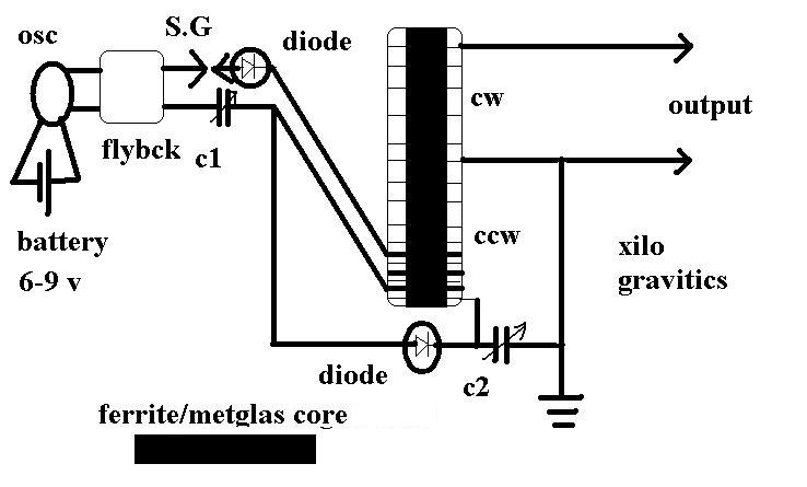

            • schema
                Hi Harishsingh I was talking on this schematic:

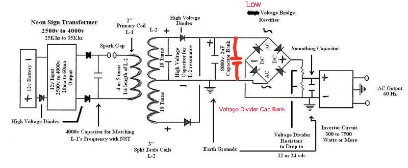

                Hi Guruji,
                The bridge rectifier is used after the voltage divider. Depending on the capacitor values in the voltage divider cap bank, the current draw can be engineered to desired values. Diodes can also be in parallel-series to handle desired wattage.
                There is another more significant advantage with this scheme.

                • Originally posted by xilo View Post
                  schema
                  Okay Xilo,
                  I look at that circuit and can imagine a spark gap impulsed primary generating a wave passing through the metglass from bottom to top. That wave also reactively tuned by C2 and the CCW winding, thus enabling resonance and transducible output.
                  But the primary and CCW are field coupled, each is also circuit connected, and thus any Metglass resonance is closed loop electromagnetically controlled, so where could any possible 'electrical' advantage come from due to this particular arrangement ?
                  What about component values and frequencies; and is the core a rod or closed toroid ?
                  Have you tested and videoed this arrangement in order to establish proof of advantage such that your publication here might be validated ?
                  Cheers ............ Graham.
                    Hi Guruji.
                    I wonder if I might here make an orbservation.
                    Your mirror image spark energised secondaries are high voltage rectified and thereafter DC charge an high voltage capacitor.
                    Whatever voltage that capacitor is loaded down to, either via a series resistor divider or any other load, will set the potential at which the high voltage diodes must shunt the tuned secondaries and *kill* resonance.
                    Has anyone ever tried inserting a choke between the junction of the high voltage rectifiers and the high voltage capacitor ?
                    I could imagine a 100 metre roll of 16 or 24 x 0.2mm cable being useful here as long as the centre of the roll former is card and not metal. (Or a 500m roll if the energising spark frequency is low.)
                    (Similar to arrangements in old fashioned thermionic power supply circuits.)
                    This arrangement will further decouple the spark gap from any final loading by phase shifting rectifier current conduction with respect to spark discharge induced resonant voltage, thus allowing the resonant induced waveform to remain more continuous, possibly even with wire coil advantage being 90 degree tunable via insertion and adjustment of a ferrite core, and possibly the spark to be quieter and more plasma like.
                    This would also reduce the voltage developed across the high voltage capacitor.
                    Cheers ............... Graham.

                    • Originally posted by harishsingh View Post
                      Hi Guruji,
                      HS
                      Hi Harishsingh the bridge is after the bank in the schematic that was posted.
                      and says Low voltage diodes.

                      Thanks GSM for your input. I'm using Bruce setup not that setup to charge the bank.
                        Hi Guruji,
                        "The bridge rectifier is used after the voltage divider"
                        The rest is all engineering.
                        HS
                        • Originally posted by GSM View Post
                          Okay Xilo,
                          do not imagine. try it
                          XILO
                                Hi Guruji,
                                HS
                                Are we seeing same schematic???
                                I was talking on this one posted again.
