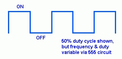

Hi All,
I need some help building a circuit that will achieve the following ( see attatched diagram & logic diagram below )
555 output,,,,,,,,,, MOSFET-1,,,,,,,,,,,,MOSFET-2
ON,,,,,,,,,,,,,,,,,,,,,, +12V,,,,,,,,,,,,,,,,,,,, 0V
OFF,,,,,,,,,,,,,,,,,,,,,, 0V,,,,,,,,,,,,,,,,,,,,,, +12V
I already have a 555 curcuit that achieves half of what i need, basically a 555 controlling a MOSFET with variable frequency & duty, bu ti am stuck as to how to achieve the above.
The reason for needing this circuit is that by attempting to replicate the logic table above "by hand" by dabbing the terminals of the circuit onto the battery i have noticed some very interesting effects and wish to study this further and report them to you guys. I should mention that MOSFET-1 will be connected to winding-A of the Rodin coil, and MOSFET-2 will be connected to winding-B of the Rodin.
So, basically i just need a circuit that takes the output from the 555 ( pin-3 ) and controls TWO mosfets as opposed to just one ).......and...it doesnt matter wether each mosfet has a shared power supply or individual ones, though i prefer to use a seperate power supply for the 555 part of the circuit which is how i am doing it at the moment.
Any Help GREATLY APPRECIATED.
Thanks,
David. D

just to add to the above, using transistors instead of mosfets would be ok for me too, anything that gives me the logic table above to drive both windings on the rodin coil..Originally posted by rave154 View PostHi All,
Thanks,
David. D
