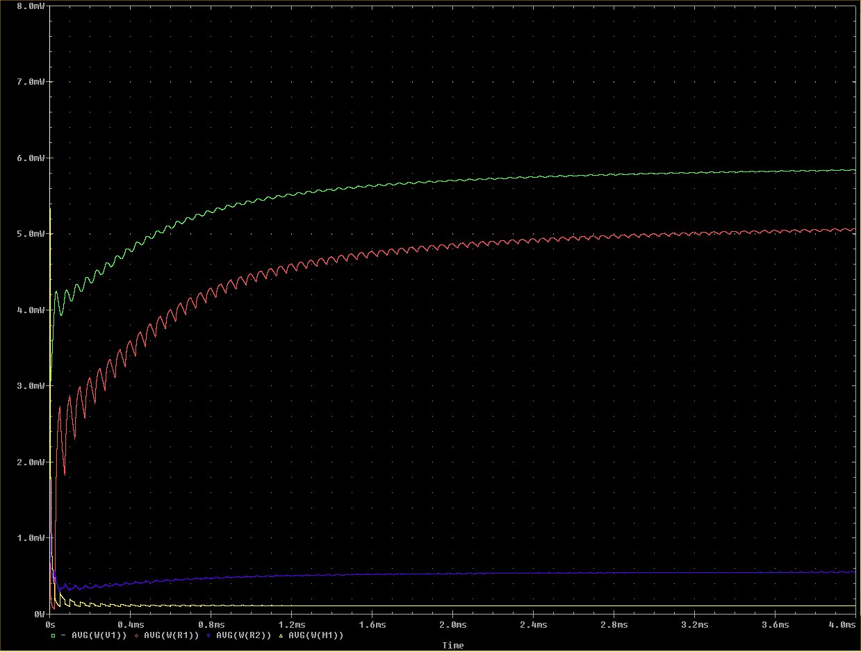

So the new results don't show overunity. The COP is now 0.867:1 (using R1 power/source power). See the attached scope shot of all the dissipative powers, which almost add up perfectly btw.

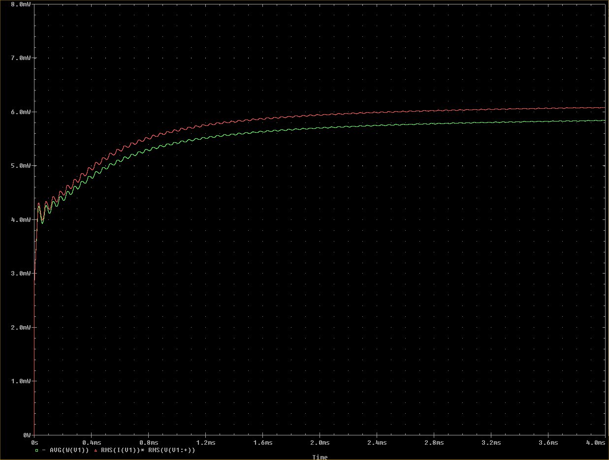

I have found a strange thing in how PSpice does an Average power calculation though. I plotted the V1 power using two methods: 1) by using Vrms x Irms for V1, and 2) by just using the built-in Average power math function for V1. The two values are not quite the same as you can see by the scope shot.
Any ideas why the difference?
