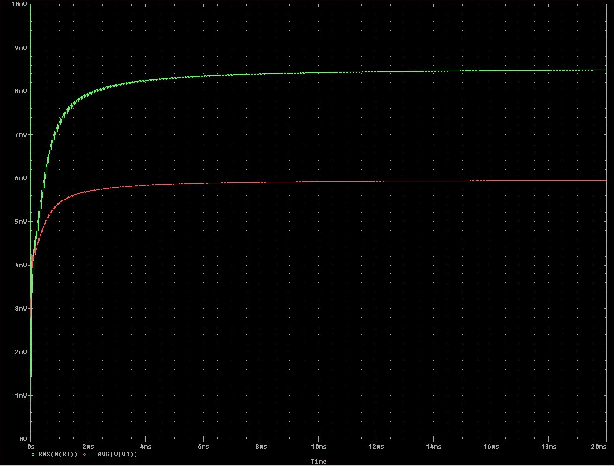

    Dear poynt99,
    In your last picture I can see AVG (W(V1)) for the input supply power and not RMS like for the output resistor.
    I wonder if the software could consider the RMS power taken from the supply, or it is the same in this case? Sorry, I am not fully familiar with this pspice terminology.
    Thanks, Gyula

        Gyula,
        Yes, this is the confusing thing about using SPICE, and I am sure it has caught many people. I myself am unsure sometimes what I am doing and have to check and re-check my thinking to keep things straight.
        RMS power in a device is calculated (by SPICE) by calculating the instantaneous power (instantaneous V times instantaneous I), then performing a running average of this for the time shown on the display. That is why the calculation has a lot of "ripple" at the beginning of the curve and why it smooths out over time.
        Now for RMS, I believe it does not matter the polarity of the product, i.e. + or -, there is probably an "absolute value" inherent in the process. RMS is concerned with equivalent DC level so it converts all to one polarity. It does not matter if a resistor is heating because of positive or negative current, it is heating and dissipating some power and that is all that matters. This is exactly what is done for calorimetry tests is it not?
        For the V1 showing AVE, yes I choose that rather than RMS because the value does not come out correct otherwise. I have done a manual calculation for the V1 source taking into account the switch duty cycle (i.e. current from the source) and it works out the same as SPICE using the AVE function.
        I'd be happy to try some simple tests with wave forms and RMS measurements if anyone wants to, to verify the validity of what I'm saying here. I'm not perfect, and could very well be making an error here myself.
        .99

              MH,
              Why does the running average trouble you?
              It does indeed come to the correct value when checked against a manual calculation. I have tried it with a worst case wave form I came up with.
              A pulse train of 0.05% duty cycle with alternating positive (+2V) and negative (-4V) pulses. Using the formula I posted in the document for gotoluc, PSpice calculates the RMS running average to be right on my manual RMS calculation. And to emphasize again, you do not use a range from "here to there" really, although you do specify a time range (but you do anyway for all transient analysis types), you are only interested in the final value (infinite time) that the averaging comes to. It WILL settle to a final value and IT DOES NOT MATTER AFTER THIS POINT WHERE YOU TAKE THE MEASUREMENT. The value has plateaued to the equivalent DC value.
              This is of course with a PERIODIC wave form that DOES NOT CHANGE IN RMS AMPLITUDE WITH TIME, and this is precisely what we have here with these pulse measurements.
              Hope that makes sense to you now
              .99

                  I doubt that very much. How long of a run would you like to see to convince you that the values I have obtained from a 2ms run will be substantially the same?
                  .99
                  • #24
                    Here is the run again but at 20ms. This is 10x the original time.
                    .99
