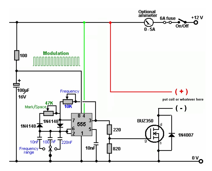

                          • Pwm
                            heres the PWM circuit that im using.
                            its basically the right hand half of the circuit Dave Lawton uses for HHO production, only difference is that pin 4 goes to positive. caps at bottom can be switched for frequency range & adjustable by pots, both frequency and duty cycle are adjustable.
                            • Correction
                              small correction to circuit of my previous post, pins 4 AND 8 go to 100Ohm resistor coming from the "+"
                              feel free to delete my previous post
