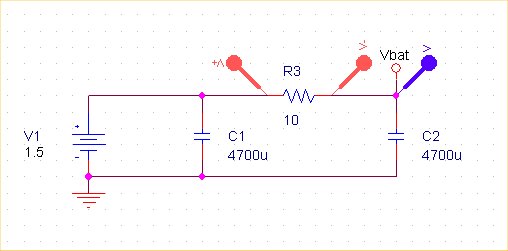

          • Easier Input Power Measurement
            Luc,
            Here's a simple circuit suggested by aethertech and similar concept by gyula to ease input power measurements.
            I had never tried this before so I PSpiced it up to check against the more direct method.
            I'm happy to report that it seems to work quite well. All you need is a couple fairly large electrolytic capacitors and a sufficient wattage 10 Ohm resistor (or close). Connect as shown in the diagram here. If you use a wire-wound 10 Ohm it will filter even a little more.
            Take two cheap DC voltage meters (both set on "DC Voltage"), one across R3 to measure the voltage across/current through it (I=V/R), and one across the Vbat point on the diagram to measure output voltage V.
            Input power to the circuit is now Pi = V x I
            Hope that helps.
            .99
            • ok, now i have removed the input bulb, still have cap across the output bulb, voltage is 6.32VDC ( zero VAC ), bedini Cap voltage is standing at 101 VDC,
              the 6 VDC across the bulb seems correct as the does appear to be about 50% bright ( being a 12V bulb of course )
              amps through the input side 6.5 mA with no input bulb,
              amps through output bulb, 56mA

                • Originally posted by poynt99 View Post
                  Luc,
                  Hope that helps.
                  .99
                  Thanks .99 for looking into a more simple approach for me to use
                  The highest identical value caps I have that can handle hi voltage are 3900uf. Do you think it would still work?
                  So I measure voltage across R3 and divide it by the value of R3 which is 10 and measure the voltage across C2 and then what ... I'm not kidding! this is all I can understand from those letters, symbols and your instructions. I never learned this stuff so how would I know to use them.
                  One formula I learned and understand is: V x V / R = P
                  If you say I=V to me that means that amps is equal to voltage then divide it by the resistance value. It's like your writing an equation backwards.
                  Sorry for not understanding what may seem so simple to you.
                  Is this circuit basically keeping the voltage to a flat DC even though the circuit is being pulsed?
                  Thanks for your help.
                  Luc
                          Yes, these should work well too.
                          Ohm's law is the minimum all need to learn Luc. Without it, it's like walking in the dark without a light. Use this as your starting point if it helps:
                          V = I x R (easy to remember "VIR")
                          Which is: Voltage is equal to current times resistance.
                          By simple manipulation, you can solve for any of the 3 parameters. For example: I = V/R (current is equal to voltage divided by resistance).
                          So for R3, you have measured the voltage across it, and you know the resistance, so you can calculate the current I from the above equation.
                          You measure the voltage across the output capacitor C2, and that gives you another voltage to use in the power equation which I keep writing in all my posts (hint hint ):
                          P = V x I (Power is equal to voltage times current)
                          So from the above, we have calculated the current I in R3, and we measured the voltage across C2 which now provides us the two values to plug in to the power equation.
                          In the diagram I posted, let's say the measured R3 voltage was 100mV and the measured voltage at C2 was 1.45V.
                          First the current: I = 100mV/10 Ohms = 10mA
                          Second we already measured VC2 as 1.45V
                          Third: P(in) = 1.45V x 10mA = 14.5mW of power.
                          Yes, this the P = V x I I have been chanting all along. V/R is I (as I mentioned above).
                          I hope I didn't say that, that is not correct
                          No apologies necessary
                          Luc
                          It's actually keeping the current through R3 "smooth" (or flat) so it is easy to read with any meter. The voltage at C2 should already be fairly steady, so again easy to read with a meter. So now you have two easy to read values which when crunched through your calculator will give you an accurate value of power taken from the source battery or source supply.
                          .99
