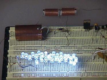

                      Hi, I'm new to this thread but I have been following this for a long time. Thank you Dr. Stiffler. I decided to give it a go and was successful in replicating the simple circuit that Mutten posted. I had to ordrer the transistor but today I built the coils using Mutten's excellent photos and instructions. Just for fun I tried the circuit with a TIP3055 Radio Shack transistor and got it to run on 4 volts and light the neon. I also found that if I put the variable inductor inside the bigger air coil inductor (on the positive rail) I got better results. It was sorta like a transformer effect.
                      I have much to learn about this topic Dr. Stiffler but a long journey always starts with a single step-- as the Chinese say. Here is my first step:
                      YouTube - Dr Stiffler SEC -----My replication

                        Nice job Lidmotor
                        Once you get the right transistor things will start moving fast.
                        Its actually a bit of a surprise seeing a tip3055 working.
                        I did get it working for a few minutes last night with a 2n2222. Not nearly as robust as the MPSA06. I'm still combing through datasheets looking for other possible candidates.

                          @Lidmotor
                          FYI I am a bit surprised the 3055 in the TO220 works, although years ago J.L. Naudin, Hartmann and myself built a number of interesting circuits using the 3055 in the TO3 case design. If memory serves me correctly the transistor use to be of a Planar Geometry and it was thought that this allows for some strange artifacts, I would have thought they would have changed it by now. I have seen where Aromaz and others following his work are using the 2N2222 and 3055 in a Negative resistance configuration for oscillation in some circuits.
                          Anyway it could be working and maybe not, only looking at the spectrum would tell that. Also are you using the 1M resistor as the base current start resistor? If so this thing is going nuts drawing +300mA. This amount of current will not of course be supported by the MPSA06. I have seem Exciters running 90mA and they were just not quite tuned right. The 4V input is a good result. K4ZEP and another gentleman had a deep fascination for PN100 and PN200 transistors. If memory is correct I think K4ZEP had an exciter running very well at under 2V.
                          You should not have in excess of +2'C over ambient in normal cases and in special cases a bit more interesting.
