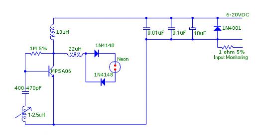

I've also noticed theres a couple of sweet spots where my scope goes nuts and I can't get the trigger to focus on a complete wave form, its just chaos all over my screen. I *think* this might be UWBO mode.

I think the cap I was using was 22pF so if you don't have a 470 like the circuit says just try different ones.
