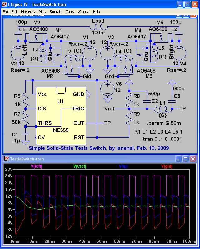

Simplest Solid State Tesla Switch!
simulation with transformer
I am copying also the .asc model file for my latest transformer version. Just copy and past into a text editor and save as "TeslaSwitch.asc". Hopefully this will work. My simulation result is attached. You can get LTspice free.
Version 4

TEXT 536 440 Left 0 !.tran 0 .1 0 .0001
TEXT 32 480 Left 0 ;Simple Solid-State Tesla Switch, by lanenal, Feb. 10, 2009
TEXT 560 368 Left 0 !.param G 50m
TEXT 504 408 Left 0 !K1 L1 L2 L3 L4 L5 1

I've just discovered your Simplest Solid StateOriginally posted by lanenal View PostI am copying also the .asc model file for my latest transformer version.
TS (transformer) circuit diagram.
[Screenshot attached as thumbnail]
Just this afternoon I was 'doodling' with paper
and pencil and came up with a strikingly similar
version! Questions have come up on the
'other thread' regarding a solid state implementation
so we've been collectively working towards a
solution.
With some time to kill I decided to peruse the
forum Index in order to see if there were any other
topics of interest and stumbled into your thread
here.
We agree on the number of MosFets and the
manner in which they must be driven as
'floating' switches. I notice however, that
you've used a mix of P-channel and N-channel
to manage the switching scheme. I've used
all N-channel in my version.
I notice you're using transformer coupling to
drive the MosFet gates. Do you plan on
driving the gates with a single pulse signal
rather than 'complementary' signals devoted
to the two separate 'groups' of MosFets?
I'm unclear on interpreting the construct of
your driver transformer, or transformers.
Are you using several transformers or are
you using a single transformer with multiple
secondary windings? It appears that it is
a single transformer...
What provision do you plan to incorporate for
're-setting' the core magnetism between
drive pulses? Possibly C2 is the means?
Your output line contains the two series
capacitors C4 and C5 (100 uF each) which
apply alternating current to the load.
What is the intended purpose of the
capacitors?
Have you yet constructed the circuit to
