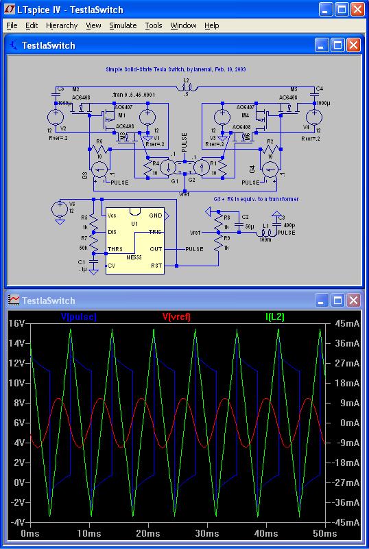

Meanwhile, I am throwing this out for those who are interested, or who might got a better background than me. Anyway, I do think this is a simplest solid-state Tesla switch plan, to the best of my knowledge. If you do know similar plans, please share it with me, so that I can regret on my own wasting of time in reinventing the wheel
Joit, maybe you are natural in making things, but for me, I need to learn a lot. I don't even know how to use a iron yet, I just bought a multimeter and I am learning how to use it. I am following some of the most basic tutorials on youtube and learn those basic skills. And I am not quite confident yet -- what if I messed one little thing up to fail immaturely -- for example, a false soldering? But, I will learn -- though it will take time.
