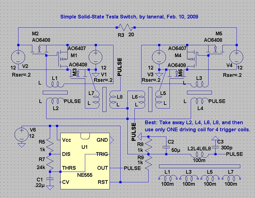

        the MOSFET version
        Here is the MOSFET version, which is recommended.
        Originally posted by lanenal View Post
        Thanks for the encouragement. I did not use transformers directly, but rather use something equivalent in the simulation. The transformers are Voltage transformation for the transistors. I will post a complete circuit with MOSFET and 555 timer later when I got some extra time.

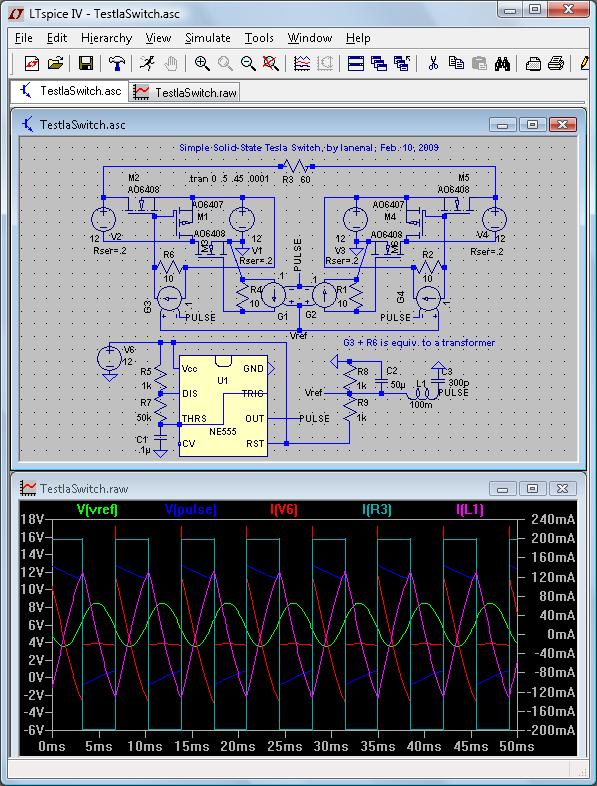

          Good looking, can you show the analysis graphs at R3 too?
            Sure thing
            Sure, I am giving a detailed plot below. I am also using L1 to mimick the current effect when a transformer is used. To keep the reference voltage (Vref) effective and save energy, capacitors are employed.
            How clean is the pulse on the load!

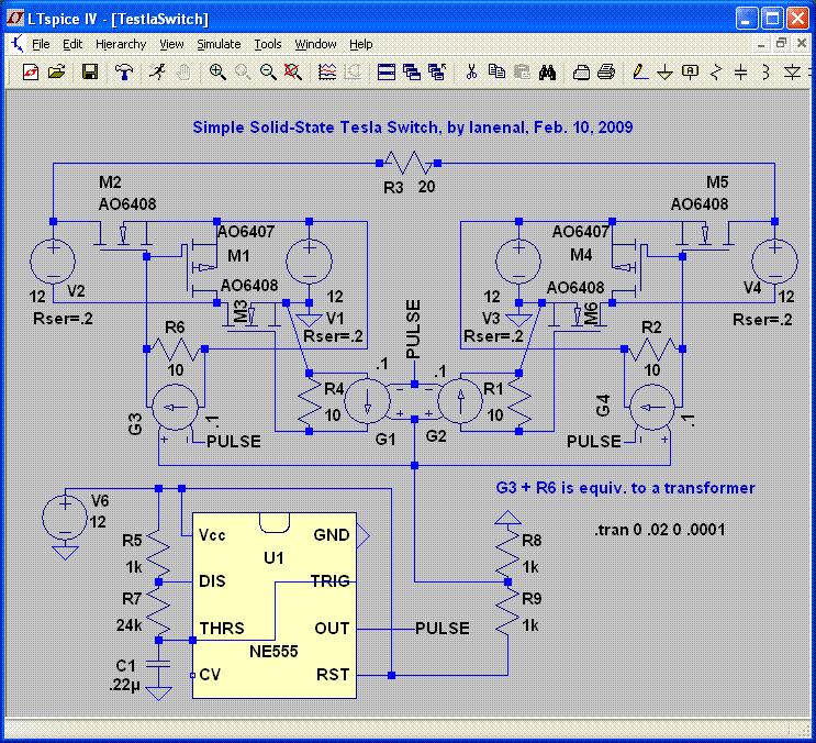

              To better understand the plan, please also see the drawing below.

                If you want to have very clean switching, MOSFETs are recommended. If you use BJT transistors, there shall be current in the trigger coil, and it will take some time to shut off. With MOSFETs, NO current will be present in the trigger coils (which also implies that you can wind trigger coils with very thin wires), and therefore you can have very clean switching. Hope this helps.
