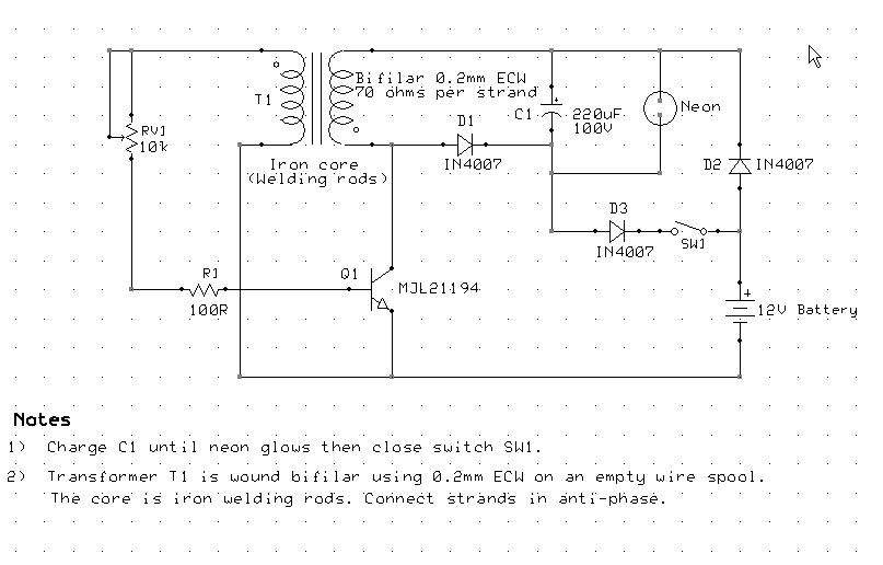

  • Hoppy
    replied
    Originally posted by StevanC View Post
    1. Ain't we 'milking' the trigger strand in 0V mode instead of "milking" the power strand on the "COM" mode?
    8:-)
    2. Could we milk them both in a way?
    3. The FWBR type is the further variant (no contact to source)
    It crossed my thoughts this morning:
    A. As all energy vortices ("electrons") have spin (*vortices* just happen to be spins of stuff ;-) ), all electrons inherently have spin.
    B. brought to existance by a uniform sharp gradient of a collapcing mag-filed, the electrons (vortices) should all receive an uniform, ordered spin with all axles parallel to the mag-fields axis?
    C. As the event passes along the conductors, it both transfers and aligns axes of other vortices nearby
    D. in the end we have a L.A.B. filled (re-plenished) with electrons of like spin.
    Could this be the source of the unusual properties of the charge?
    Where would further expanding of this idea lead us to?
    Give schematic a try. I make no claims but its interesting. I forgot to add on the schematic that it may need starting by tapping a magnet on one end of the coil and leaving it there.
    Hoppy
    Edit: Please note that I have drawn the capacitor the wrong way round. Positive should face D1.
