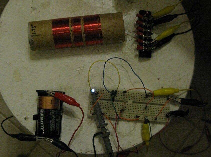

I removed unnecessary "dots" and put missing ones in place. There are two caps, marked at pF range, which I believe was a mistake. I put (what I believe
) correct values.
