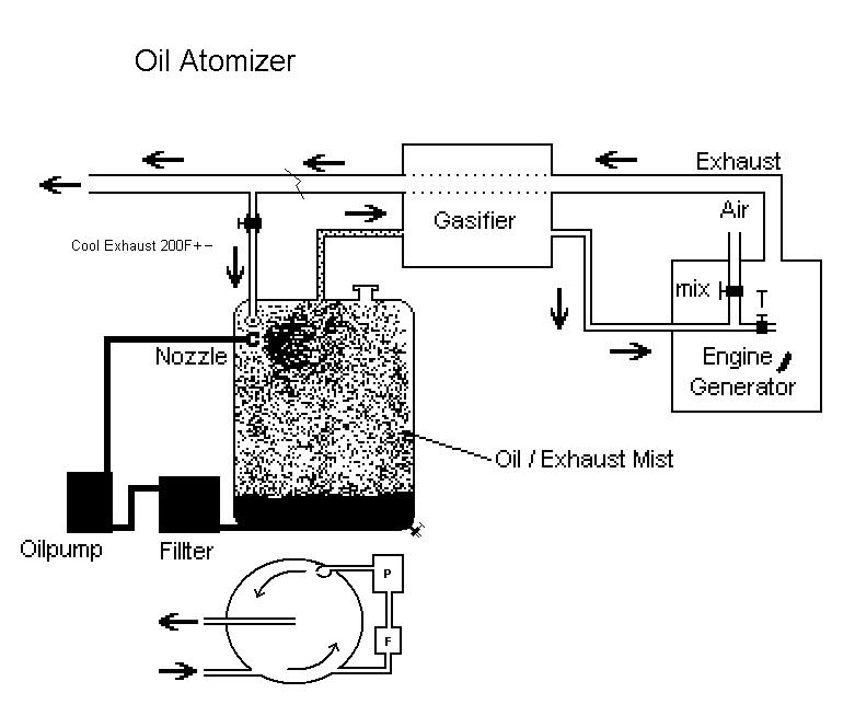

My idea on the whole vaporization of gasoline was the foundation of my earlier understanding of how to get better mileage out of gasoline and extract the full potential of energy from it. Ever since I bought a car Ive been experimenting with new designs on how to make the process work on my vehicle. As some may have seen my new video I posted on YouTube I was attempting to run my car on just pure vapor from gasoline.
So far I haven't tried heating the gasoline up to maintain the temperature to a reasonable degree, but so with my only set up I was able to get my car running on the first 5 to 10 minutes on it before shutting down. I have had my car on the road with this set up, and have had it slowly accelerated to 25 to 30 mph, then slowly dieing down. My next design im looking on trying some stronger spark plugs to ignite such a lean mixture and may be get the water spark plug design working hand and hand with this set up, maybe better results! I was thinking that the plasma spark plug would be working on the principle of catalytic cracking and producing smaller molecules made of hydrogen gases that gives more power and effeciency?
