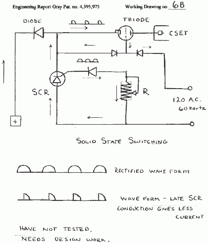

              • drawing up a new potential
                Aaron,
                In thinking of my efforts to construct a working energy discharge system
                with your plasma burst methodology, it has struck me that what it does
                is nearly the same only opposite of how the patents describe how it should
                work. With the HV plasma pulse being on the trigger and the LV bank sitting
                as an open positive potential, this is a reverse situation.
                Recently what I've been experimenting with is using a setup that is very
                similar to the patent version, only instead of using 12V from a battery I've
                boosted it with a mosfet driver feeding a small transformer into 400 or so.
                The 3-point electrode setup as shown in my videos has been taken apart, and
                without it I'm seeing negligable results so rebuilding it will be my next step.
                In the meantime what I'd like to ask you to reconsider is how the HV plasma and
                grid interact in your system. With a pulse from the coil going to meet with
                the open LV side and subsequently cause the radiant discharge, it will be that
                charged up cap bank being shorted out with the plasma as I'm sure you're aware.
                What I'd now like to bring forth is that in the system patented by Gray, the
                LV positive potential must pass through a charged HV capacitor in order to continue
                on to the cathode of the battery, versus as I've just previously described
                where it will only be encountering the airgap to the grid and the resistance
                of the drive coil.
                The proposition I would make at this point is that the AC being fed into the LV
                cap bank be utilized by the likes of a cascade multiplier into charging up an
                additional source of high voltage that will be coupled with the battery in the
                position of the pickup grid. When the plasma burst hits the open LV-side diode,
                it would then theoretically cause it snap shut as before and smack its way
                through the new HV cap on the grid and drive coil (not shown).
                This is the way I'd imagine it would be constructed -
                Uploaded with ImageShack.us

                          • my circuit
                            hi aaron
                            this is my circuit
                            have wonderful day

                            • @Pranav
                              Looks good Pranav, congratulations! I saw the vids when you posted
                              them - looks very stable.

                              • Well guys, in my previous experiments with the CDI ignition and variac
                                method of charging up the LV side cap bank, apparently the limiting factors
                                in producing negative results on charging the battery were -
                                1) The CDI ground from the (-) ignition coil was not on a spark gap to
                                the cathode of the battery. The Ground wire on the 3rd point ought to
                                have been on a gap with the CDI ground on the other side away from the battery.
                                Not doing so was bumping the current draw.
                                2) The various operating parameters of the variac and inverter were drawing
                                extra current to stay operational while also powering the coil-driver circuitry.
                                Aaron, I've rebuilt your system once again, this time completely by the use
                                of the pulse-width modulated 555 & 393 mosfet circuit designed by the RM Cybernetics
                                team. The outlay of the entire thing is identical besides the use of a variac and
                                inverter.
                                The results I've obtained in this manner are quite promising.
                                Attached is the matching diagram, and might I convey that while it was working there
                                was an unmistakable charging effect on the battery.
                                Due to what I believe is a fault in the circuitry for driving transformers the
                                system did not last more than 5min before frying the mosfets without overheating
                                them, while also disabling a number of timer & pulse-width chips. I've hence
                                rewired a diode to be positioned across the MOT primary to subside any spikes
                                that might be causing the problem and it has unfortunately worked to reduce the
                                output to a minimal value.
                                How indeed I might progress to rebuild it to stay running is almost
