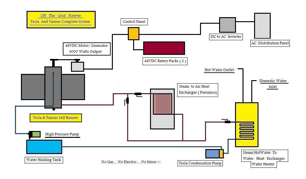

        • Guys...
          Heres a little idea I came up with for a self sustaining system.. the main problem, is finding a "water Injector" of some sort to simplify the "water drop" system Llyod uses. Not that there's anything wrong with the drop system.. It Works.!! Just trying to simplify and make it a "set it and forget it" machine.
          If anyone has any idea's please let it be known..
          Paul

                • For proper "leverage" and pumping, doesn't the flow in a Tesla turbine pump have to be from the outside circumference to the center? This would mean that your outlet from the steam turbine (at the center) would have to be directed to the outside of the air turbine and then the outlet from the center of it routed to your heat exchanger. Correct?
                  • Originally posted by everwiser View Post
                    No. I think his idea is that after going through the turbine the steam will have given up enough of its heat to convert back to hot water(condensate) and the pump will send it to where it can be utilized.
                    little_old_lady:
                    Paul said it well but I have one question. Where is the motive force for the friction heater(s) coming from? There is no way it will be a self-runner and turn a generator also! Can you imagine the fuel/electric bill? You'll be swapping money with the fuel/electric company!
                    My research of the Tesla turbine shows it needs to be built to precise dimensions just to be competitive. Unfortunately, no one seems to know exactly what those are and there are thousands of possible combinations to be designed for with each one unique to its application. There are many groups around the world that are trying to come up with an efficient design and the best I have seen is about 25-30%. If this thing was so awesome, some company would have developed one and others would have knocked the design off already! I don't buy that there is a conspiracy against it. Markets will eventually find the most efficient use of resources and adjust to use it. As a pump, however, it does have its place.
                    • Everwiser...
                      The first stage on the Tesla device is a turbine.. just a simple turbine. Steam enters from the outside spins around in a spiral path ( draging the discs with it ) then exits out the center. Tesla's working turbine was 25" in dia with steel discs with a total width of all the discs being about one inch. Using 125 psi and 300 degree heat the turbine produced 200 HP. The Fasinating thing about the turbine is that the exhaust temperature was reduced by 1/3 and the pressure dropped from 125psi to less than 3psi...
                      The second part of my turbine is an air pump.. a simple air pump. Air or in this case steam.. enters at the center and the discs ( driven by the turbine) add the veloscity to the steam needed to get to the furnace or water heater or where ever it is needed.
                      As far as the question about being able to drive the boiler and the generator with this single turbine.. I can't say for certain.. But according to everything I've read about Tesla's " greatest invention" it is capable of 10 Hp
                      per pound. Please go back and read posts 203, 206 207 and 210 by Rickoff
                      There are some very good files to be found there. I figure I need about
                      12-15hp from the turbine to run the whole thing... Very do-able with the Tesla turbine.
                      Paul
                      • Thanks for the info. My intent was not to dissuade nor to criticize the proposed plan but only to comment upon what I had seen/read about the Tesla Turbine up to this point. The outside-to-in operation was the way I've seen it configured in the various articles, posts, and alternate sites I have visited thus the post I made.
                        It seems to me that if the it's necessary for the flow to originate from the outer circumference to "spin the turbine up to speed" and generate its shaft power, then flow in the reverse direction would have the opposite effect thus making the device less efficient. If this thinking is incorrect, then I'm in the right place to learn but I won't learn otherwise if I don't ask.

                          1. How many cfm were required to make 200 hp?
                          2. I hope you or some one else builds one so we can see if it works. A Tesla turbine built with high efficiency will require R&D,$$$$$$$$$$, and powerful flow modeling software that doesn't exist yet, and optimized for your specific application. As it is, you'll be lucky to build one better than 20% efficient( I doubt even that ). And how many cfm or lbs/hr will yours require? Lloyd's heater only produces abour 125,000 btus.

                            • nonubinns...
                              This is what all of pervious attachment all work towards... This is where I want to be... and I think it just might be possible with Tesla and Tanner together..
                              • everwiser...
                                Yes you are correct.. The air pump will take power away from the turbine and you will never be able to get the pressure or heat back up to the level that enters the turbine.. without an external power sourse. Used in the way I laid it out.. the exhaust (heat and pressure) from the turbine is quite a bit less than what entered. Using the air pump (which also has fewer blades)
                                the power used will be minimal compaired to the power generated.
                                One thing you must remember.. These are just my Ideas.. even though Tesla's and Tanner's machines work and work very well.. I can't possitively
                                say for certain that changes won't have to be made to my Ideas to make it work like I want it to..
                                I'm not an engineer.. I can't do the math calculations and tell you it will work without building it first . If someone can... I'd love to here from you..
                                Thanks Paul
