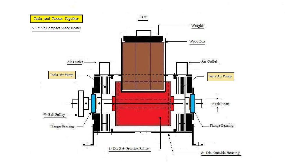

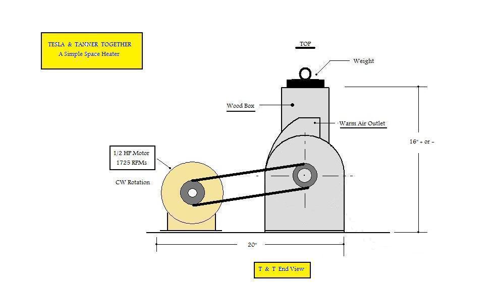

                I finally got a "sky dive " account so I can post pics to the Forum.. Thanks for the advise. Here is a pic of my garage heater that I am constructing. Although, not a scaled down model, it will be rather compact in size, compaired to Llyods original design. I will post more results when completed.
                Paul

                • Rick,
                  I really like your design for a heater, though there is one problem that jumped out at me. You forgot to account for the change in the weight of the wood as it is burned. This will cause the amount of friction to vary over time as the pressure against the spinning disk would change with weight.
                  The combination with tesla turbine is a nice touch and would probably help prevent your bearings from getting too hot!

                    • Originally posted by rileydad48 View Post
                      Rick..
                      Paul
                      [ATTACH]2017[/ATTACH]
                      [ATTACH]2018[/ATTACH]
                      Very nice!
                      Can you go one step further and use that hot air?
                      • Little Old Lady,
                        Thanks for the comments. As far as your concern about the varying pressure, the wood blocks will be (3) 2x4 green oak pieces 10 to 12 inches in length. The steel weight will be 8 lbs. That should make the pressure about 12 lbs with new wood pieces and never less than 8 lbs at the end of the "burn". ( for the lack of a better word ). Hopefully, this should not vary the temperature a great deal. I will say one thing though, after the heater has run for a while, I'm sure I will have to remove the wood and let the roller cool before it is shut down completely. I can't see the wood sitting for long on top of the hot roller with out the air pumps cooling them. Can we say "Fire in the Hole".
                        One thing that does have me a little concerned, is the ash residue left over after the "burn" ( for the lack of a better word) Will the air pumps pick it up and blow it on the garage floor. What will the temperature of this ash be after going thru the exhaust turbine??? Won't know that till it's built. It may not be a concern at all..?? Might need to put somekind of spark arrestor on the exhaust ports..?? Hoping the Tesla air pumps move enough air to keep the temperature on the inside below 300 degrees, well below the ignition point of oak.. but plenty of heat for the garage.. Gonna have to finish it before I can answer these question..
                        Thanks again, glad you liked it.
                        Paul
