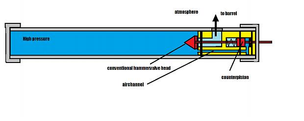

            Now some more links with very important information:
            Piston Valves
            Piston Valves Explained Visually
            how to make a piston valve
            I gotz a 35 bar pushbutton valve : )
            piston valve without pilot-waste..
            making the blow-forward breech work
            Semi-auto valve for under $20
            DIY 3/2 DCV (video)
            How-To Database (NOT FOR HELP-ME POSTS!)
            Also use the search function to answer your questions!
            We will very soon be covering the differences between steam injection (think paintball system) and HHO injection (think firearms) and discussing the different properties of each system and potential applications in engines for producing work done.
            We will also be covering valve types, QEV dump chambers (high volume, low pressure), Hammervalve (high pressure, low volume), and combinations of both, Old Shatterhand
            We will also be examining the potential for delayed blowback via magnetic energy storage and reciprocation with the point of maximum potential energy being at the point of maximum instability, which is a tickle past zero point.
            Very soon we will be moving to advanced concepts involving wireless transmission of power, magnetic valve actuation through pressure walls (no seals and no leaks), and highly streamlined designs involving fuel generation, phase change, detonation prime mover, and fluid shaping from sub to super sonic, all within one assembly, built around pneumatic and hydraulic principles. Everyman... remember ?

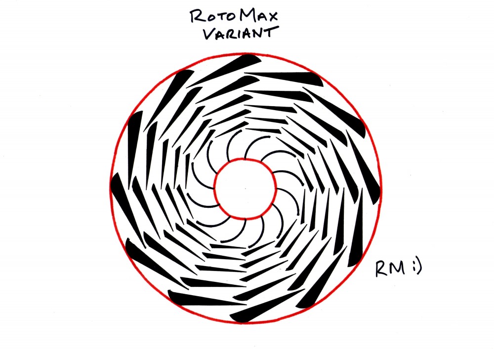

                    I have been thinking about Mark Beyers development direction and it got interesting...
                    A radial compressor of some sort to create the temperature differential we need in the Vortex tube nozzle, has the energy of fluid flow required to create a relative partial vacuum over a venturi, and can therefore suck the fuel into the airflow for ignition at a controlled variable rate.
                    An ultrasonic transducer with a fuel such as gasoline, producing vapor in the 10 micron or less range. Additional HHO bubbled up either through the gasoline, passing through both hydraulic and pneumatic elements of the ultrasonic waves system. Or alternatively, introduce the HHO into the pneumatic gas phase at the top, before it enters the venturi and then the airflow to the vortex tube. You can introduce them seperately if you want because the vortex behaviour of the fluid flow provides a thorough mix of the fuel and air before injection into the combustion chamber.
                    Now you have a solid state thrust nozzle powered by gasoline vapour and HHO from the battery supply, which also supplies your start up compressor and ultrasound vibration plate. Once the engine is running we can do a power take off with a PMA to take over those functions. The engine vibrations can also be tuned to produce a vibration frequency in a thin plate to produce ultrasonic vibrations.
                    The engine though, what do we do for that...
                    I suppose we could consider running a RotoMax hybrid variant with both a turbine and a pump on the same shaft, in the same housing, seperate chambers for both functions of course. Biomass steam reforming and phase change manipulation of near supercritical system fluids, within the engine, is a possibility.
                    RotoMax Rotary Engine... Tesla - Wankel - Mason HHO Hybrid

                      • Here we have a RotoMax Variant, which can be used as a blade spacer profile in a HELP / HELT supercritical water biomass fuel processing system.
                        The blades are made of ceramic, follow an airfoil in shape, and are angled correctly for maximum deflection by impulse, aerodynamic flow and optimum cutting angle. This is a DC powered rotary shredder blade pump, whose spacer blades act as both pressure inducers / absorbers (HELPump / HELTurbine) and also as slicing experts.
                        The non electrical conducting nature of ceramic as well as its high temperature operating capability make it perfect for electrical isolation in a supercritical water working fluid (supercritical solvent). A biomass processing system such as this will have a maximum particle size it can accommodate in the slurry, this also applies to HELIS. Wood pellets might be a good way to go for a guaranteed uniform size.
                        The advantage of the HELP in AC mode as a heat pump is obvious with the control over temperature it gives you. The DC mode performing electrolysis functions is an unknown potential in a supercritical water solvent working fluid at 374 C and 3200 psi.

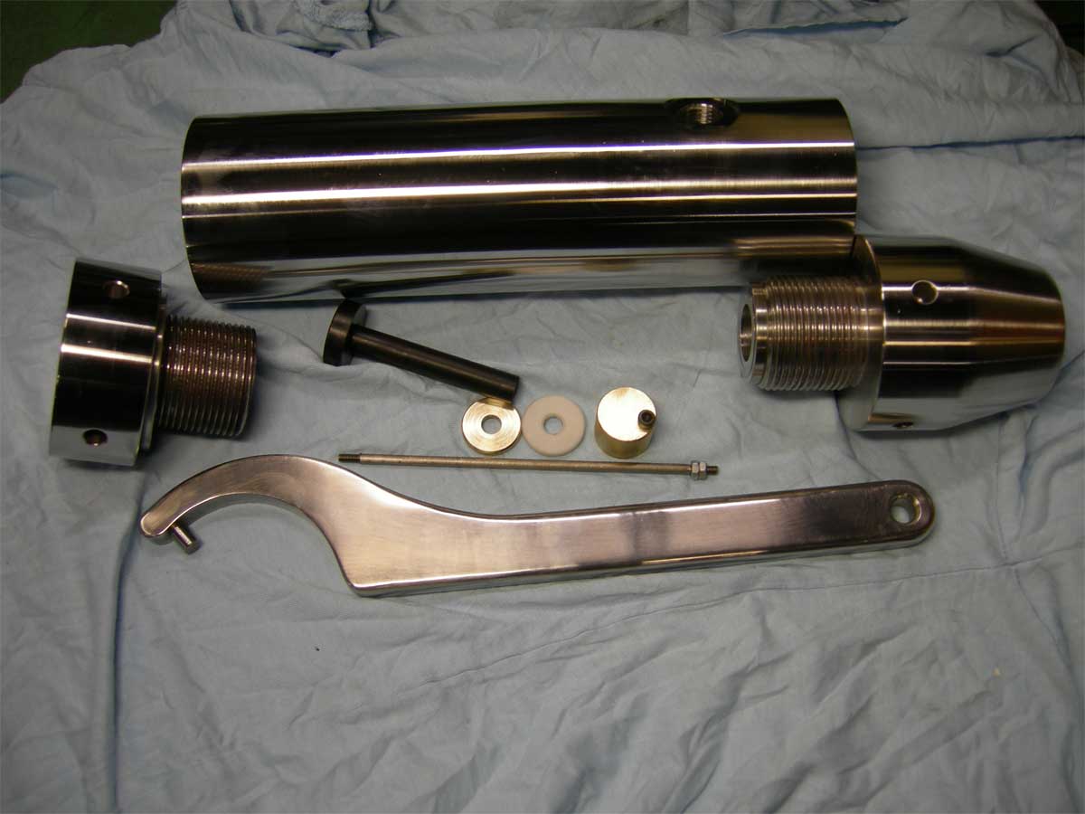

                        • Self Governing Piston Dump Valve for Working Fluids
                          How to build a self actuating pressure differential piston dump valve...
                          We start with the piston QEV dump valve principle for instantaneous power:

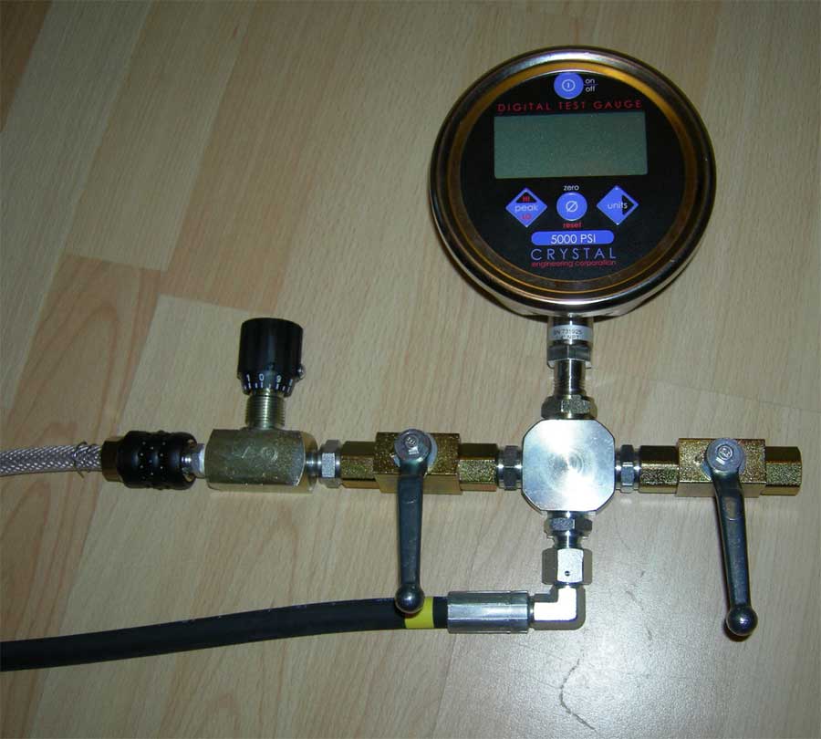

                          We then need a method to pilot the valve:
                          and a successful replication, one of many:
                          update(core pictures)BTB pushbutton valve
                          a recent elaboration by Brian The Brain which explains the principle clearly:
                          Push type QDV explained.
                          and Poland Spud's automatic pressure differential (potential difference) actuator which triggers the pilot, which triggers the piston, and dumps the chamber pressure out through the De Laval nozzle to create a supersonic shockwave:
                          semiauto MK III - vids
                          So, when the three technologies discussed here, the piston dump valve, BTB's counter-balanced valve, and Poland Spud's oscillating actuator are combined into one assembly in a specific order an automatic pressure differential governed valve is the result.
                          Pressure comes in through a restricted inlet (annular tube gap), pushing the piston valve forward to seal the chamber outlet. The pressure is balanced equally in BTB's balanced valve, which is kept closed by the spring bias. Through an annular gap around the piston valve piston a restricted flow fills the chamber. As chamber pressure builds Poland Spud's actuator piston depresses the spring resistance gradually, and eventually extends far enough with enough force to trigger the spring bias in BTB's balanced valve. The pilot chamber dumps to atmosphere, causing a negative pressure differential between the piston dump valve and the chamber pressure, causing the piston dump valve to slam away from the outlet dumping the chamber pressure. The chamber now being at atmospheric pressure allows the spring in Poland Spud's valve to assert force and reset the actuator piston. The process now repeats, and should if the annular restrictions and spring pressures are set correctly oscillate very fast. You have now achieved pulse width modulation of positive pressure potential in an oscillating self governed cycle while maximising power by approaching Time = 0 piston dump valve opening time and shaping the flow to achieve a laminar shockwave.
                          Have fun...

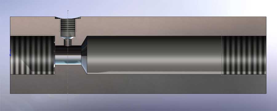

                          • Bearings | Oilite Bearing Bushes | Imperial | Metric | Flanged | Plain | Bronze Rods & Bars |
                            Brass Rod mates very well with Oilite bushes. I am using 8mm which measures 7.95mm OD, Oilite bushes are normally slightly oversized to allow for final reaming on assembly which is very handy as the 7.96mm ID of the bush gives me a perfect off the shelf, self lubricating, piston assembly with the very small annular gap restriction I require. I rarely see custom piston assemblies with tolerances this good except on very expensive high end stuff.
                            8mm Brass Round Bar Rod CZ121 Varies Length Options | eBay
                            Brass Bar / Rod has been selected as it is easy to cut a Metric thread using a die to accept Metric nuts, and it should last a good long while:
                            OS Live Steam Locomotives
                            I will also be using Oilite bushes to build the floating Oring Assy's, an Oilite bush inside an Oilite bush, with an Oring is a match made in heaven. If I have to ream out the ID of the larger bush the pores can be closed preventing oil release, however, as I will only have to modify the ID of the outer bush the inner bush will remain untouched preserving lubrication properties. Add backup rings as necessary:
                            Nuts, Bolts, Washers and Fasterners from Nylon Alloys Ltd online shop
                            I will be initially running tests on compressed air for safety using a small 12V compressor:
                            Halfords | Halfords 12v Leisure InflatorSpark Plug Thread Adaptors Brass 1/2" Pipe down to 14mm | eBay
                            As a spark plug has the live electrical connection through the center and grounds to the body...
                            DON'T TOUCH IT!
                            Or you will get electrocuted... Same safety protocol as the Davey / Savic AC electrode boiler, so please be careful...
                            Later on I will look at designing an inline version with neodymium magnets allowing me to actuate through a pressure wall, removing the need for floating Orings to seal and also allow me to get rid of the compression springs, unless I decide I want to exploit the potential difference between Hooke's Law and magnetic fields.
                            Have fun...
                            Rob

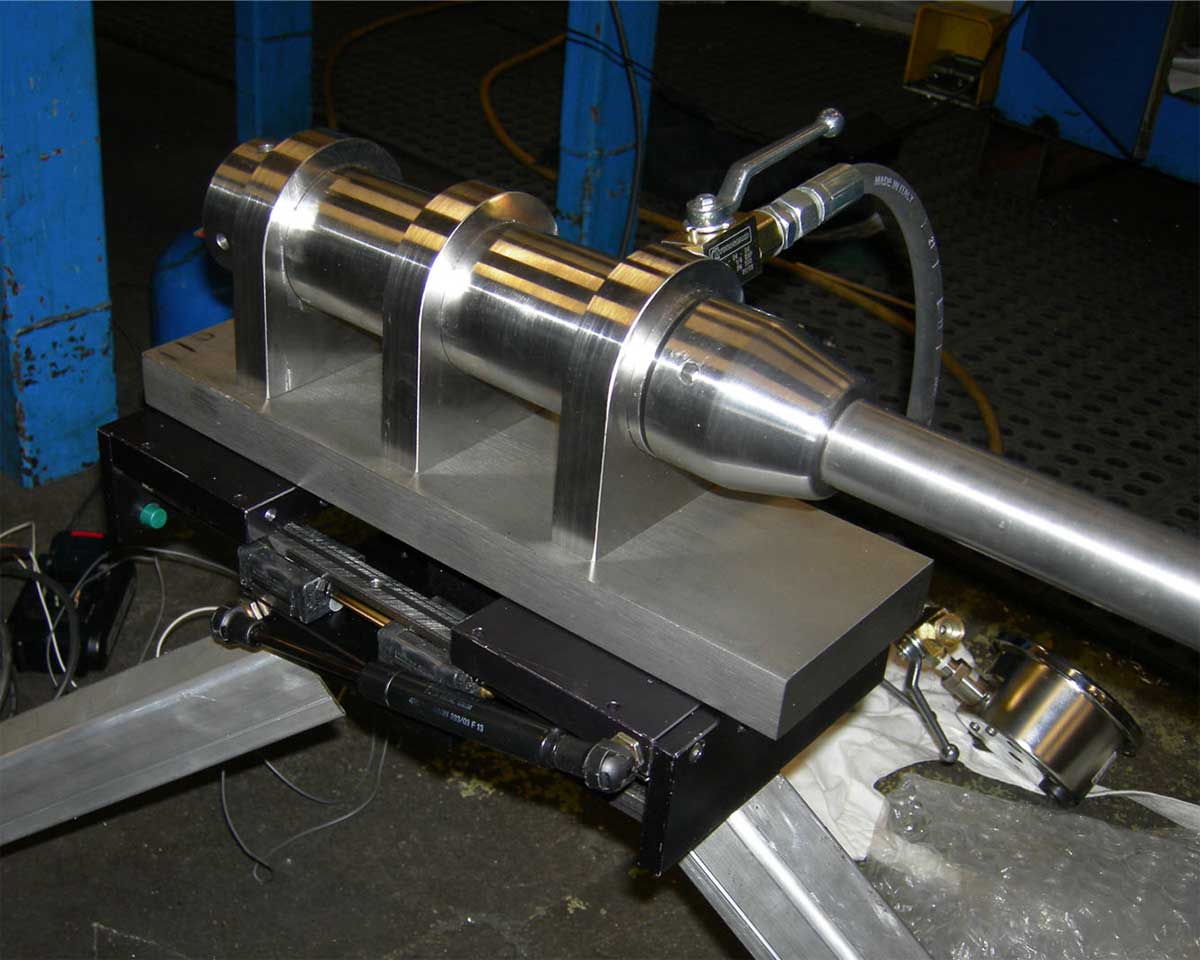

                            • Pulse Detonation Engines
                              Returning to a main theme, some interesting information:
                              Mythbusters SO9E18 Drain disasters
                              Shockwave Stun-Cannon
                              Shchelkin spiral - Wikipedia, the free encyclopedia
                              What is the LFV ?
                              Rob

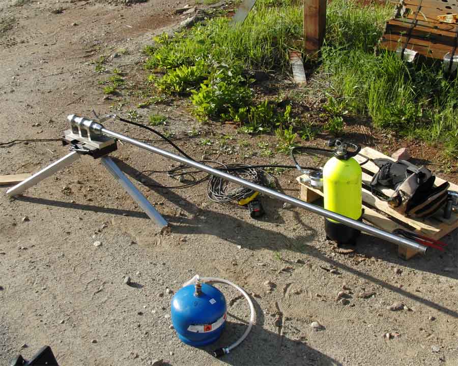

                              • MARCHLABS M13 - YouTube
                                Possible upgrades:
                                Single chamber HHO shockwave shaped by an automatic De Laval valve, LFV.
                                Dual chamber design available with PPR allowing air and fuel injection, either liquid or vapor (with respective potential energy densities), HHO shockwave detonates stoichiometric air / fuel mixture and a thermobaric shockwave forms at the area of maximum compression. This second shockwave is injected into the RotoMax and impacts with the liquid water (can be injected % under phase change temperature ie. 10% under = 90C) at the area of maximum compression in the rotor of the engine.
                                The thermobaric pressure wave crushes the liquid water and applies high temperature causing a phase change, or two. Run air and water compressors, via direct drive pumps from the output shaft or AC / DC motors via the PMA and battery.
                                A thermobaric shockwave rotary engine.
                                Common Fuels for Combustion Spudguns - Spud Wiki
                                HHO Gun possibility?
                                Harnessing DDT (deflagration to detonation transition)
                                Detonation Powered Cannon?
