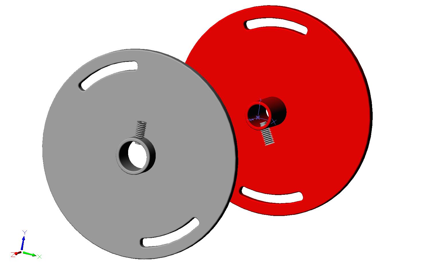

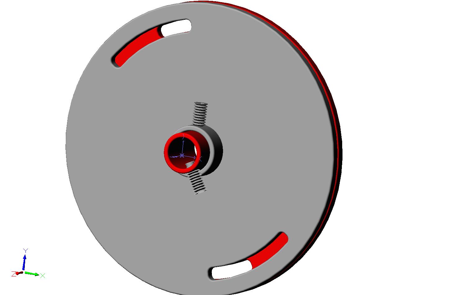

  • Jetijs
    Hi Carl
    Thank you for reminding me about the shutter idea
    I was going to use a timing device that is something like that I have on my genset, I mean like this:
    This allows quick and easy timing adjustment on the fly, but this does not allow me to adjust the ON time. Your idea solves that very easily With my last setup I had to machine a timing wheel for each ON time variation I needed, but your idea will solve this
    Thank you!
  • hh1341
    Jetijs,
    So good to see you are back working on your motors.
    It warms my hart to see a version of my shutter idea adapted to your design.
Name:	Vari-Shutter EX 1.jpg
    Can't wait to see this one fly.
    Carl
