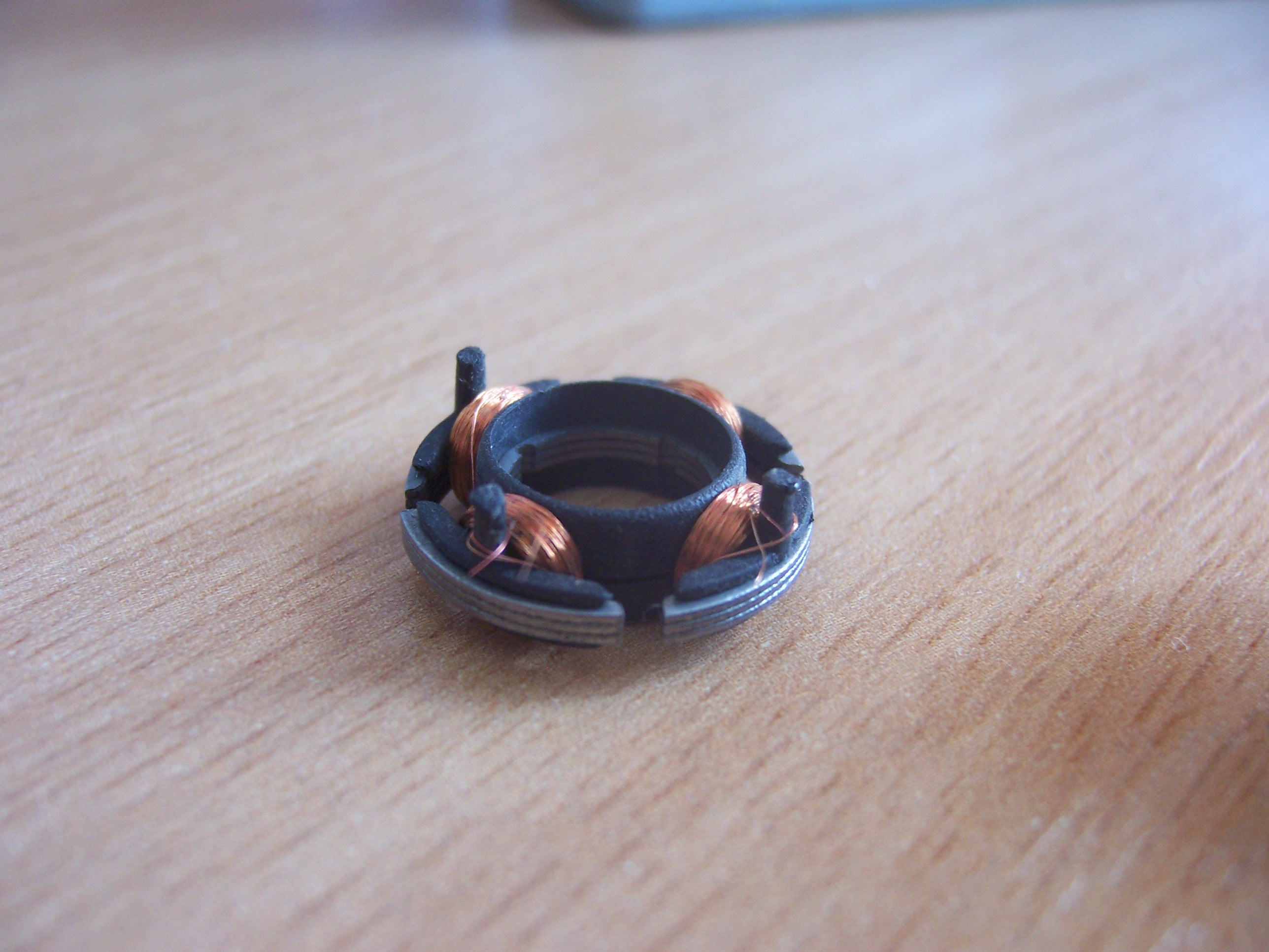

        Actually what I did is carefully take off the circuit board and left the wires on the existing posts.
        Most of these appear to be dual phase coils, which means theres 2 outside end of coil wraps on two of the post that are already there and the inside wraps (beginning of the coils) on my versions were wrapped together on the third post.
        If you take a magnifier and look at the three post that are existing you will see 2 wires on one of the three posts. (yes they are extremely fine, which is why a magnifier is a must) and i left the coils the way they were, cause they were already designed for these machines and if you look at the label you will see what kind of current they drew originally so you will know what kind of current to expect out of them.
        Makes things easier. Some of these are bi-filier and some are single wound. That really doesnt matter , what does matter is one of the post will most likely have 2 wires on it.
        If it does, carefully take a fine tip soldering iron and start to heat it taking care not to melt the plastic and unwind the two fine wires from that post and then gently separate them with the fine tip of the soldering iron, pay attention to your heat and if the plastic starts to get a little mushy where the post is, pull off and let it cool for a second and then try it again.
        Once you get the two off the post and separated, wind one back on gently, if there is a 4th plastic post with no wire post on it, the easiest way to add a 4th wire post is to do the method on the film where you are just taking the diode and gripping with hemostats to absorb the heat so you dont burn your fingers and pressing it into the plastic.
        I started a hole with a small drill bit glued into a plastic wire nut. and just started to turn it in the center of the 4th plastic support that had no post on it. that keeps it centered and you have a better chance of getting it right. Gently push with the hemostats as you are heating it with the soldering iron, just about 1/16th to a 1/8th inch into the plastic so it will be rigid.
        And then clip it off at the same height of the other ones. This is the best method I have tried. Then wrap the 2nd wire you took off the post and wrap it around that one. now you have 2 sets of coils that were designed for that stator. Put a little solder on it, and add your wires using an ohm meter to check continuity. Let me know how it turns out.
        HI
        i have 3 posts
        1st have 2 wires
        2nd have 2 wires
        3rd has no wire
        where exactly should i cut them
        thanx

          check continuity
          I have not encountered every coil made but i would carefully scape the ends
          (be carefull , if the inside wrap wires (start of wrap) break and get too short you will have to scrap or rewrap or get another fan but you can get these for next to nothing from computer repair shops bad power supplys or radio shack or new egg etc.)
          and then check continuity with an ohm meter you will probably find continuity across two of them , that will be one set of coils then check the other two and they will probably be your other set then prepare component leads as instructed on vid to prepare the extra post and you are set good luck.

            Wow yours does not look like mine. yours does not seem to have metal posts.... You will have to come up with a way to separate each wire to a certain post. Perhaps hot melt glue? You might have to get creative on this one.
            What i did was to cut one of the wires off the post. Note, before I did so I looked to see which of the wires would be easy to unwrap on of the wires was buried in wire and would not of let me unwrap it.
            After I cut the wire, I carefully unwrapped the wire from the coil till it gave me enough wire so I could wrap it back on the coils to the new post. The new post was a resistor wire that I found fit very snug into the hole of the 4th post. I applied heat to the post carefully till it melted it. You might want to try superglue or other means of securing it, but this worked for me. As mentioned before it is very easy to over heat the post.
            Then to strip the wire so I could solder it to the post I burnt it with flame again careful not to damage the rest of the wire or coils. This I wrapped a few times to the post. One thing to note is you want to post to be even height with the other posts. I found out the hard way....
            Then after all the wires were mounted I then tested with the ohm meter to find which wires went to which coils... If it does not give you an ohm's then it is not connected to the other coils.
