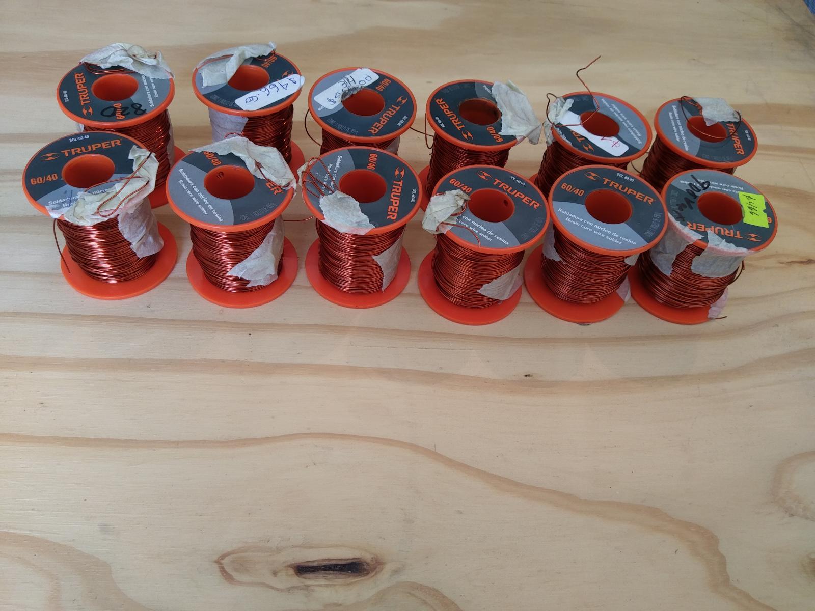

        I started the construction of the coil proposed by turion
        12 threads 253 23
        The first challenge was how I made the count of each coil.
        the first was by manual counting, then I put the reel in a winding machine that I built, and I passed the wire to a new reel, and so I knew how many laps each reel had to have
        I show you the photos
        • contruccion de la bobina de turion

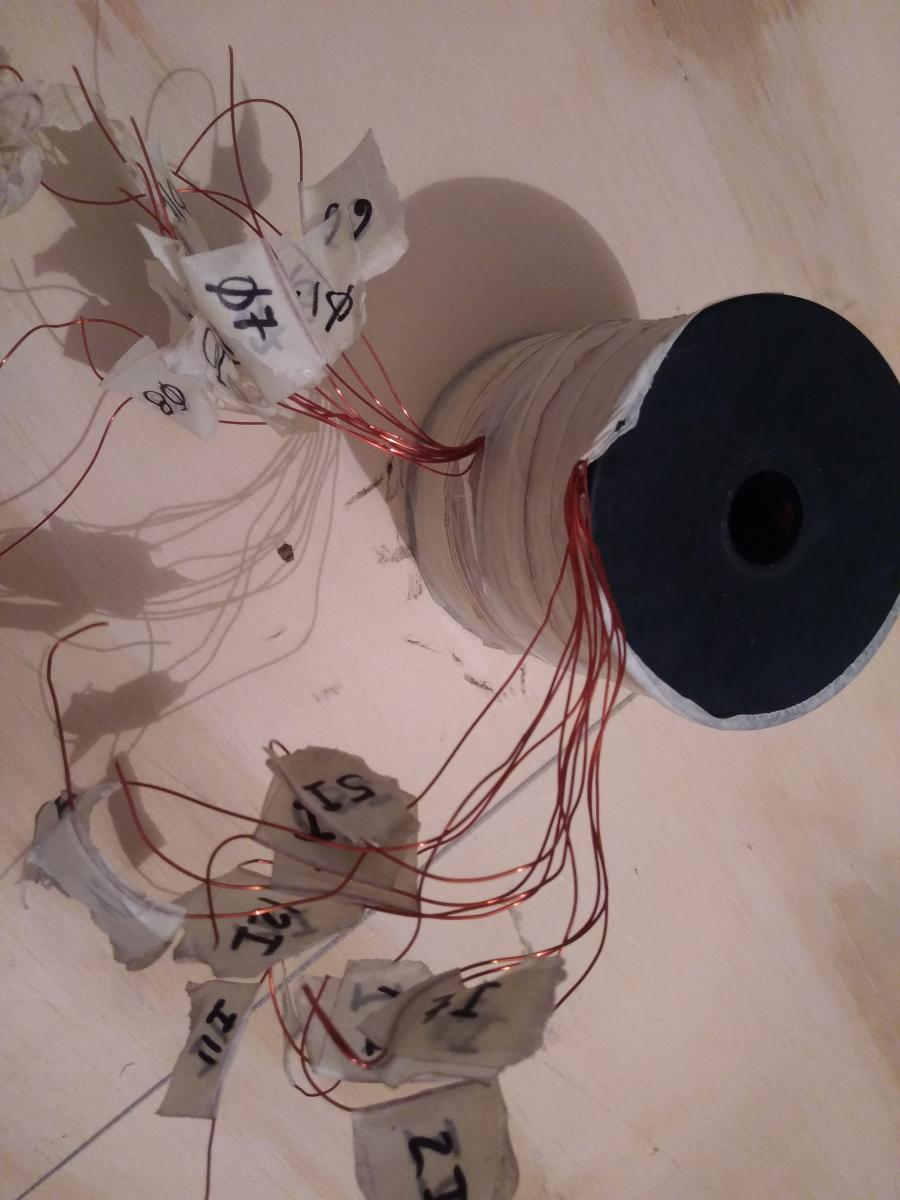

          then go to the construction of the major coil, where first place all the reels in two sections of 6, to be able to manipulate them better
          but first mark each thread at the beginning with tape, and also finish it since they had each one, which made it easier for me to verify each thread afterwards
