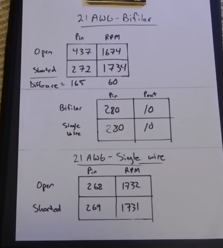

    I've been thinking about the debunked video. The fellow gets exactly the same .035 efficiency from the bifilar coil and the mono coil.
    There is an effect which can come in to play, see link

    Efficiency = (power output) / (power input) * 100%. Look it up.
    {From the debunker video}
    Using bifilar coil at load, power out = 10 watts, power in = 280 watts, efficiency = 10w/280w*100% = 3.57%.
    Using single wire coil at same load and same conditions, power out = 10 watts, power in = 280 watts, efficiency = 10w/280w*100% = 3.57%.
    Exactly the same. This is what I've been saying from the start. There is no advantage at load. All the "speed-up-under-load" coil does is to increase loss at no load.
    Turion, Thane Heins, BM or anybody else has never shown a valid comparison of the bifilar, or "speed-up-under-load", coil to the standard wound coil. They all compare their coil loaded, or shorted, to its no load condition. And yes, RPM increases and primer mover power reduces because their coil has inflated loss at no-load, not because it offers advantage over a standard coil under the same load and same conditions.
    The debunker performs a very concise and valid test. All the equipment and instruments are the same (even the core) except for the one variable, the coil. He then tabulates his data and presents a chart.

    • Yes, it takes a bit of following. Mono coil is easy 10 /280
      for the bifilar the pin is first measured shorted 270 and when the load is added, the short is removed and the resistance of the load added 280. The effect of the load is the reverse of the mono coil.
      I've just seen something quite odd, the mono coil is 268 open and 269 shorted so the load on that goes up too with the resistance of the load added.
      I'm confused!
      • The braking effect of the open circuit bifilar is amazing. Who would have thought an idling coil could eat up 165 watts?
          I'm confused!
          Also interesting, power in for bifilar shorted = 272 watts & 269 watts for the mono. Essentially the same.
          Bifilar unconnected = 437 watts, mono unconnected = 268 watts. That's 169 watts more while the bifilar is 58RPM slower. That's it in a nutshell, all the bifilar coil does is increase no-load loss.

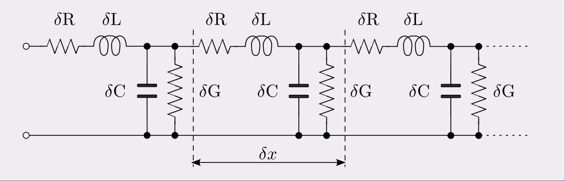

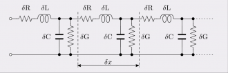

            It helps me to visualize the bifilar coil as a transmission line equivalent circuit.
            image from: https://steemit.com/stemng/@kaydee/c...ir-performance

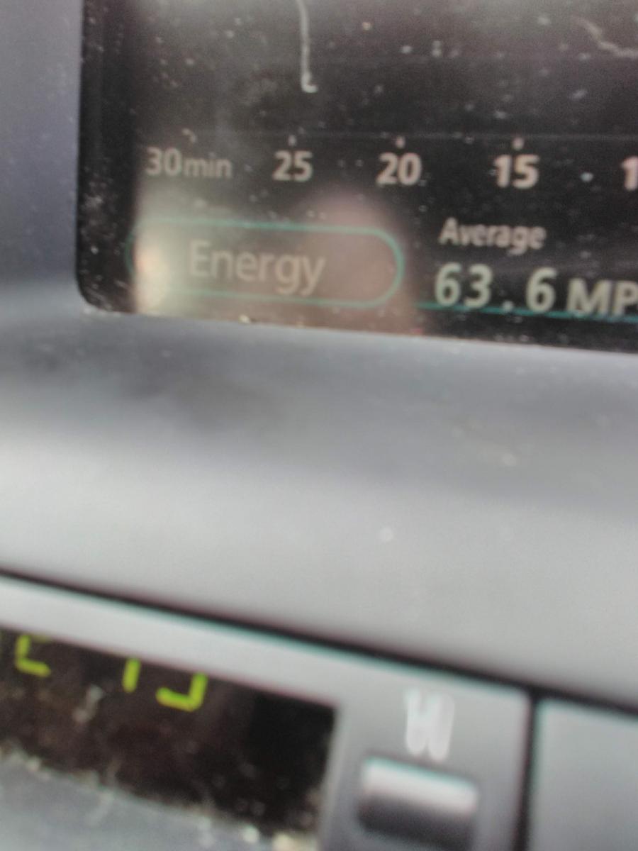

            • Prius is a motor generator which appears to be relatively efficient.
              • You can knock 20/mpg off that battling a headwind, with the heating on, the lights on, the wipers on and a couple of passengers.

                    When you look at the extra input vs output it is pretty good. For the bifilar it works out at 10/8 which is 125%.
                    For the ordinary coil it's 10/11 which is 90%. So if you had 30 bifilar coils you'd get 300 watts out for 240 watts
                    in plus the 270 iding which is total input 410 watts. 300/410 which is 73% overall efficiency.

                    Input power when the coil is shorted doesn't enter into any type of efficiency calculation.
                    The only reason I see that he took that data was because Thane and others used to short circuit the coil leads to demonstrate speed-up-under-load. But the short circuit of the coil output leads necessarily sets the load (output) voltage to zero making any efficiency = zero.

                            I see the speed up as the result of removing 165 watts braking effect that the open circuit bifilar coil is causing.
