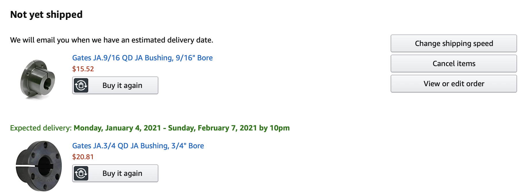

          • Waiting for parts to run the generator. This one has a different size shaft than previous version to make it stronger. I do not have hubs for that size shaft or for the MY1020 razor scooter motor, as I have always connected the motor directly to the generator shaft, and this time I am using a belt drive system for a smaller footprint. Almost exactly the same as the one my friend showed in his video, except I think his MIGHT have been a chain drive at the time he took that video. He is converting it over to belt drive also.
            I have a sleeve that will fit on ONE of the MY1020 motors that I turned the shaft down on manually by using a file and running it, but still lack the actual size hub that will fit on the unmodified motor and the one that will fit on the generator shaft. I am having another sleeve made for another MY1020 motor, and it will be ready next weekend. I still await the 3/4 hub to fit the generator shaft. When it magically appears, I will be ready to move forward. But not until then. I'm in no rush. I have plenty of other projects to work on right now.

                send me that link again where you get those hubs
                • I bought several hubs and two pulleys. I intend to buy a couple more pulleys and some different sized belts and use this system for running anything I need to run with motors. Buying different sized pulleys will give me varying gear ratios, and the different hubs will allow me to use motors with different sized shafts. It's a bit of an investment, but I am adapting a motor to run on an electric go-cart, so I am looking at different options.

                    • https://www.pcimfg.com/products/stai...hubs-bushings/
                      It is best to have both pieces

                        • bro,
                          The pulley I am using takes the place of the "ring" you show, and serves the same purpose. As you tighten it to the hub with the bolts, it compresses the hub onto the shaft. That's why I showed the pulleys FIRST. I'm not missing any "pieces" in what I have shown.
