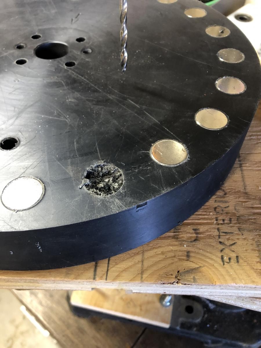

        • Not too messy. Good job.

            ... All I want to do is prove that what I have been saying is true.
            Me too.

              Drill a small hole on the outer rim center of the magnets you want to remove, use air pressure to blow it out...
                Hi dragon,
                Good idea, but say at 150, or 200psi and maybe 1 sq.in., I imagine magnetic attractive force is greater than that 200 pounds provided by the compressed air. However such a small hole as a vent may have made assembly much smoother.
                • Assuming a 1" diameter 0.5 thick N50 Neo magnet with a 0.125 gap between them the attractive force would be just slightly over 100 lbs. Of course I'm making assumptions on the "gap" between them that was machined into the rotor. Anyway just a thought... It's worked well on some misgivings of projects in the past.
                    Looks like I was too quick on my assumption. Maybe it would've worked. Worth a closer look and possible try next time if needed. I looked at attractive force calculator on KJ Magnetics web site. Notice that attractive force is same to steel plate as to another magnet.
