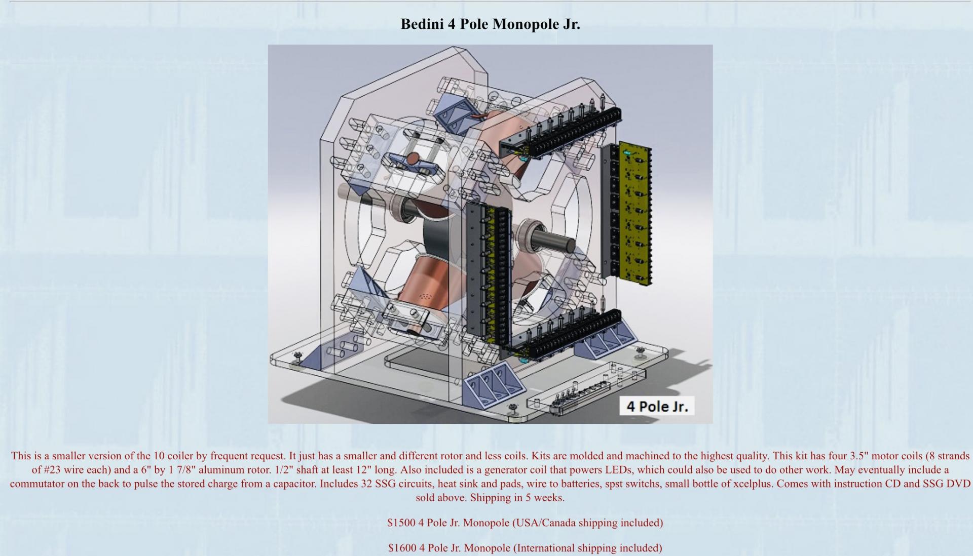

    The machine is nothing special it is the 4 pole Junior kit Rick Friedrich sold when he was with John. I use the normal 3-1/2 inch Pittsfield spools, as supplied in the kit. I will show some footage at some point, when I have time.
    What typically happens to the amp draw and the rpm of the rotor when we add another salient pole to a motor, in parallel?
