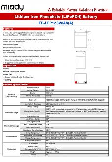

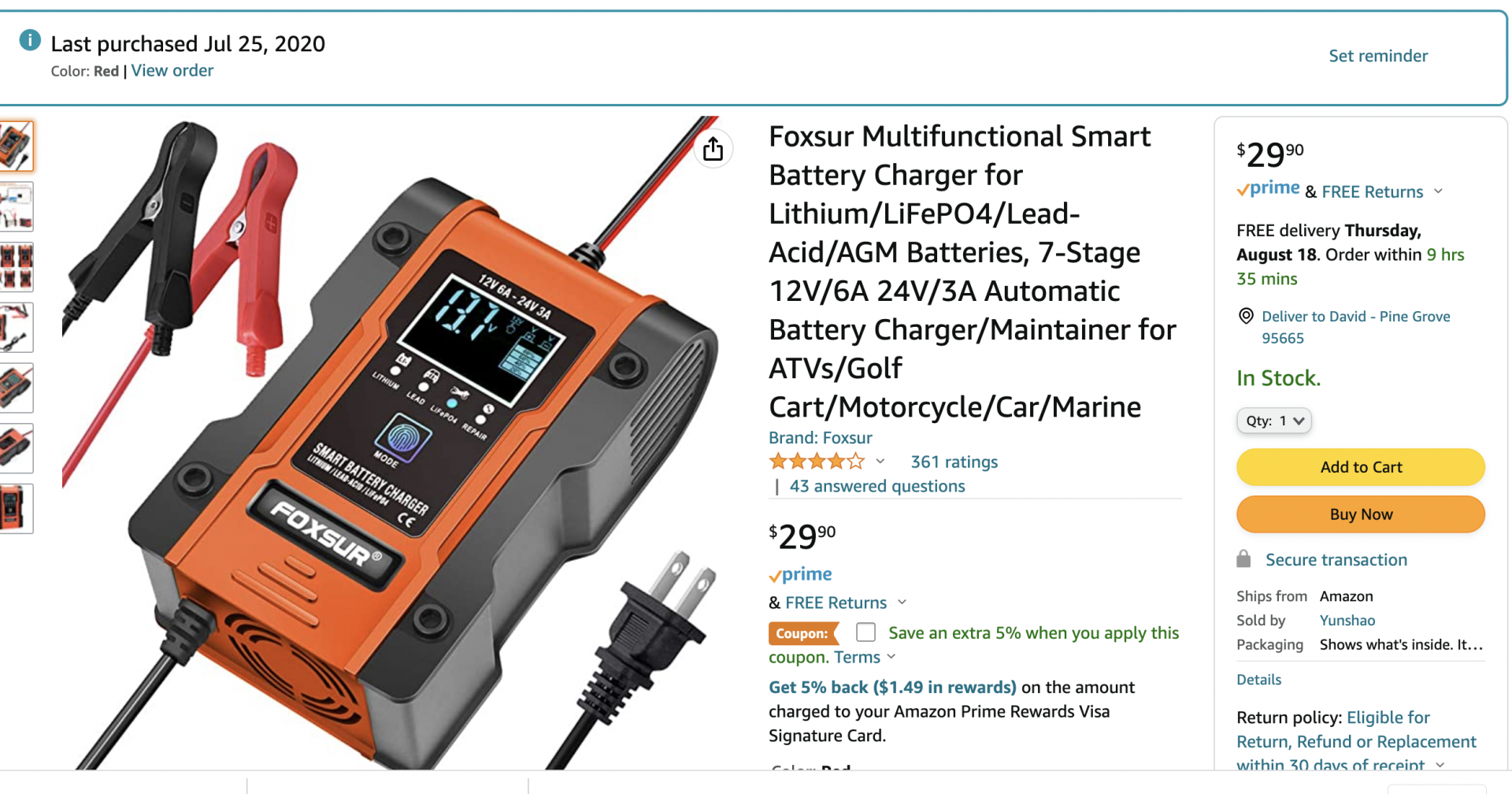

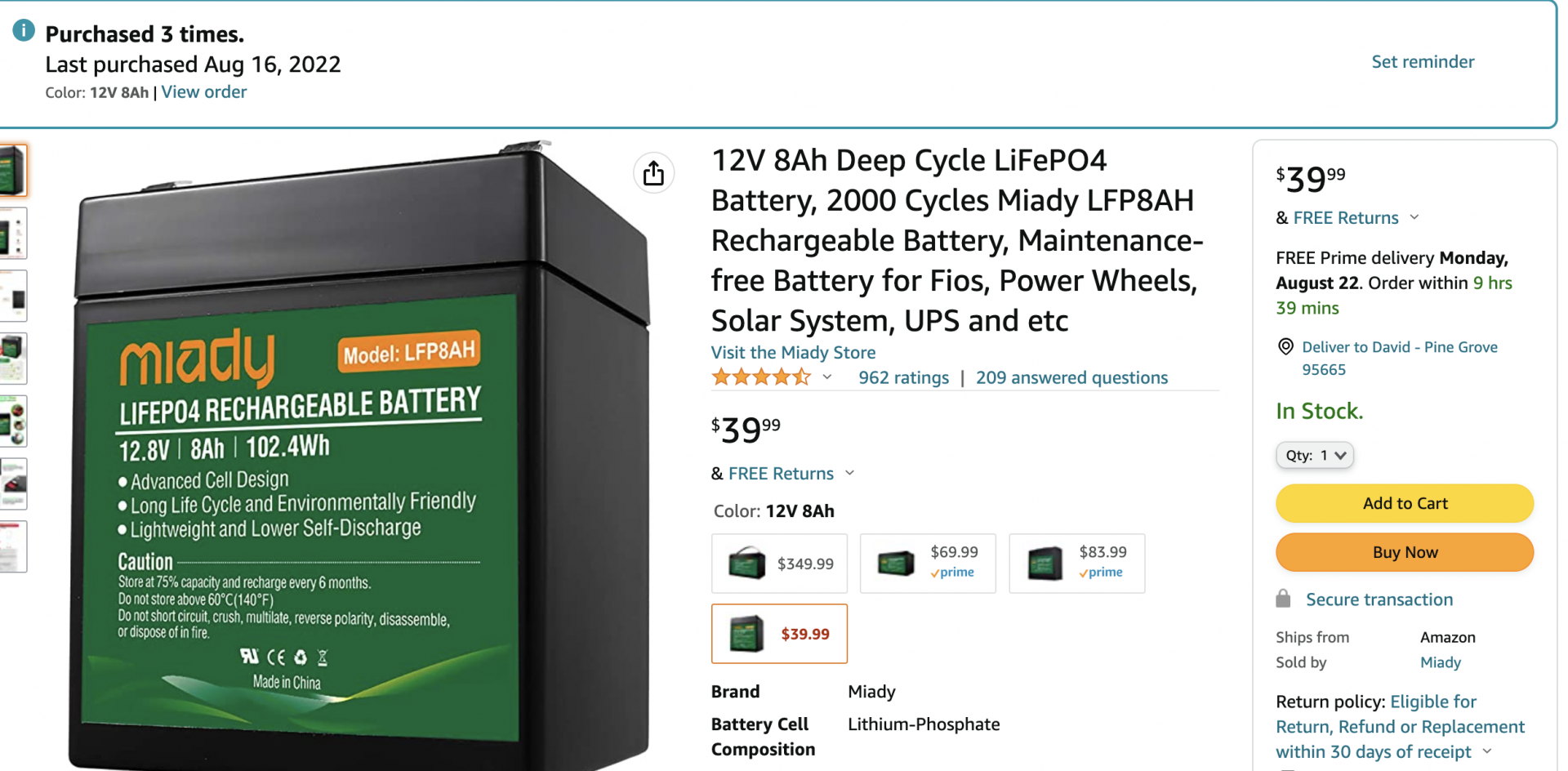

        I'm curious. Which Lithium battery are you using? And which charger? There are so many available at reasonable cost.
        • Here are the batteries and the battery charger that I purchased from Amazon. I just purchased three more batteries today, which will give me 9 total. Click image for larger version
Name:	Battery Charger.png
ID:	511097 Click image for larger version
Name:	Current BAtteries.png

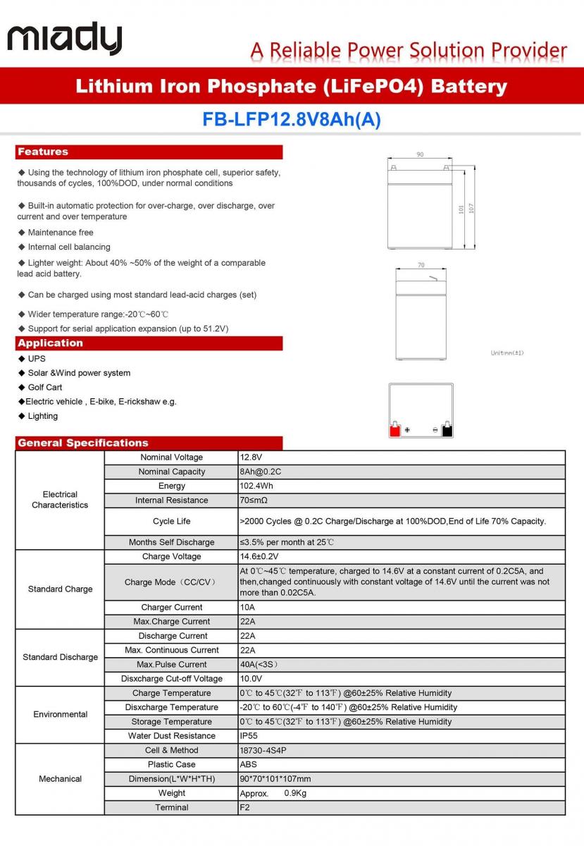

          • Thanks.....

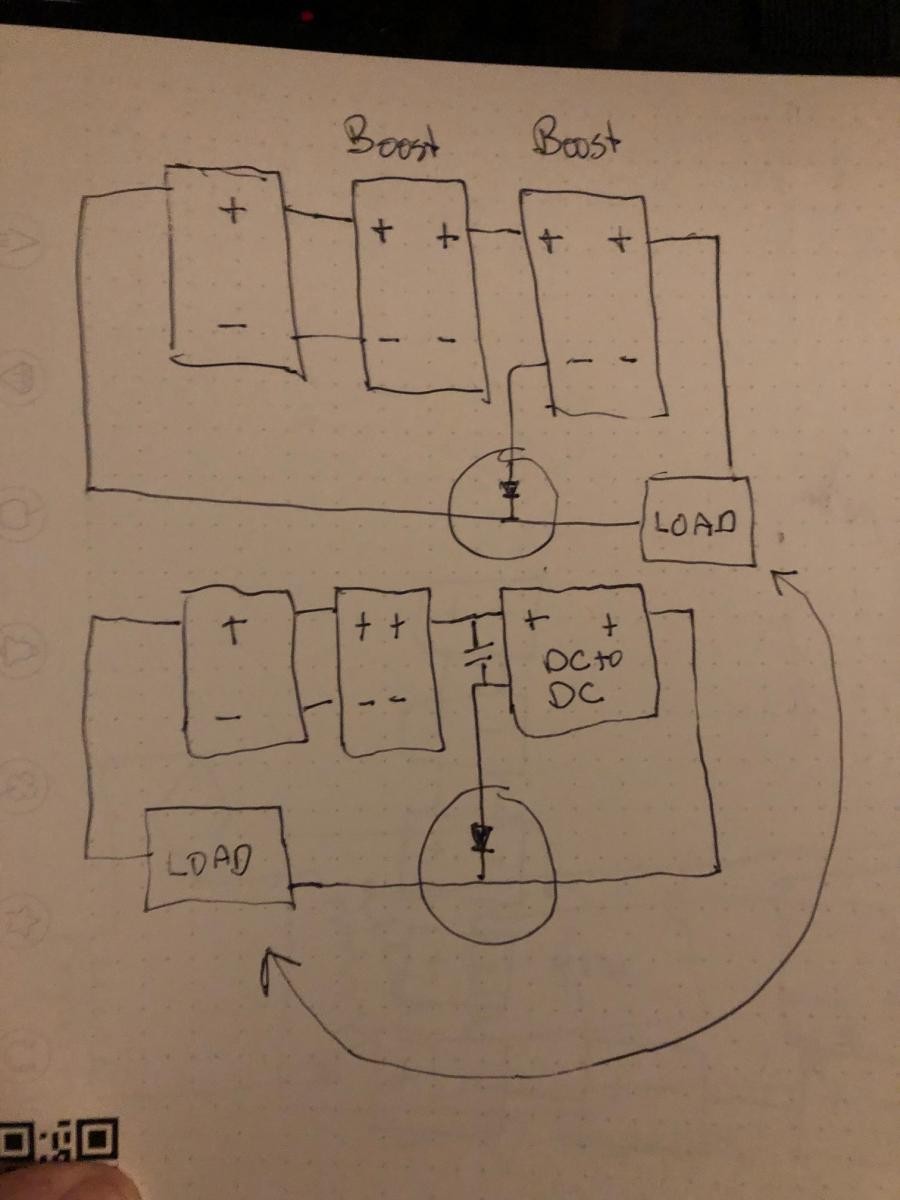

              You should listen to someone who knows what they are doing and that's obviously not ME. I guess I wasn't thinking when I drew that schematic. Here is what I am ACTUALLY running. Instead of a second boost I am running a DC to DC converter, which acts much the same, but is more efficient. And I have a cap across the input. It probably isn't necessary, but that DC to DC is like $130 rather than $30, so I take no chances. I am changing the picture on the previous post to the correct one. The main ISSUE is which side of the diode the LOAD is on. It changes the relationship between potential differences. No wonder bistander asked if I had ever run that circuit before.

              If the DC to DC converter is isolated, does not the negative output need to be connected to the load?
              • Glad I have you to find all my mistakes. If you are running just boost modules it will run as shown. And that's all I would encourage any of the folks here to spend money on. When running an ISOLATED DC to DC converter the ground DOES have to be attached, as you point out, but not to the load. It is connected to the ground on the battery.
                It is like the OUTPUT of the DC to DC converter replaces the two batteries in series in the 3 battery setup. It is a separate energy source. So the ground of it goes to the ground of the 3rd battery. (In this case, the ground of the only battery we have to establish the dipole) and the load runs between the high potential positive (of the DC to DC converter output) and the low potential positive of the 12V battery. Everything possible runs on potential difference so SOME of the energy can be recovered.

                • Look at both those circuits. In both cases you have to pull Double the amount of power to run the load and recover half of what's left. Now do the math. Then do the math with efficiency of the components and the battery which cannot be charged while discharging. The simple answer is you have done nothing. Ya you could added buck converter like wanttomake talks about and is strangely not included in the drawings, but the buck will collapse (look it up, Buck Collapse). Non of this is anything.

                    • Teach the principles of what ,David? This might look real neat but it is a flat out waste of power. And I am talking about the hand drawn circuits you have posted above. Look at the first one with 2 boost.
                      Power comes out battery let say 100 watt, goes through the primary boost (at 90% eff.) Now you have 90 watts. Then you go through the second boost no matter if it isolated or straight (90%) Now you have 81 watts going to your load. The load strips the voltage and now you factor watts left in current at battery voltage. But lets just call it 1/2 of 81 watts, 40.5watts.
                      If the second boost converter is isolated you loose half of what is input minus off time in the duty cycle. So essential 90 watts going in if your lucky 30 coming out. So now your total is 70.5 watt going to the battery, and this is if your lucky. I haven't seen anything that good. And now you use that power to try to charge a battery that is discharging so you are looking at like 40% (28.2 watts) recovery, and at some point you got a hotspot, probably the plates of your battery or in the protection circuit. You can confirm the the Hotspot loss with a clock. A battery contains so much power and that is it, especially a lithium with protection.
                      But look at what we started with and what we end up with 100 watts in, 28.2 recovered and loss of 71.8 watts. You are burning more power than you would if you just ran the load.
                      You can try to argue with me, You can film a correct test and prove to everyone I don't know what I am talking about. But you won't you have never really tested anything. You just pass out other peoples info and endorse it like its your own.
                      These circuits as drawn are bull****. There is no one on this board who knows better than me. Go ahead prove me wrong, do some work for change.
                      • What principles do they show?
                        That a load will run between the positives.
                        That SOME of what is put through the load can be recovered (Even YOU state 28.2 watts recovered with what you say is crap)
                        That what is put through the primary side CAN BE independent of what is collected on the secondary side on TWO SEPARATE electrical circuits. What comes out the secondary is a RESULT of what is put THROUGH the primary (and can be collected) but is NOT PART of what is put through the primary.
                        You say here that only 28.2 watts out of 100 is recovered because of the inefficiency of what is shown. How much CAN BE recovered?
                        And YES, i is better to run this with a 3 battery system than with a single battery. Never said otherwise.
                        I agree that a boost or even a DC to DC converter is not the way to go. I haven't thought that in quite some time. Going through the primary of either of those is inefficient. That's why I brought up the transformer when you decided to come on here and attack me. But you ignored that, didn't you? Wonder why? And WHAT would be the most efficient way to pulse the primary side of a transformer and collect the power put THROUGH the Primary like with a 3 battery system?
                        But learning how to do this is a process. YES, I agree, there is nothing exciting here. Recovering 28.2 watts to reuse out of 100 is a little better than 25% extra to contribute to extended run time. Which is ALL I've said these circuits will do. And I AM doing work on my own. I am working with an EE and he is building circuit boards for me in order to power the primary side of a transformer. Fun times.
