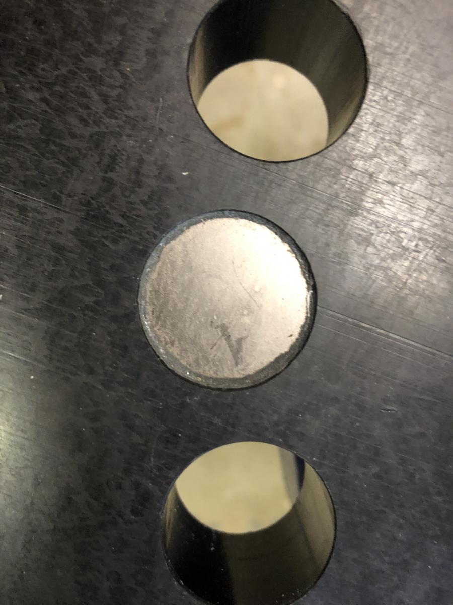

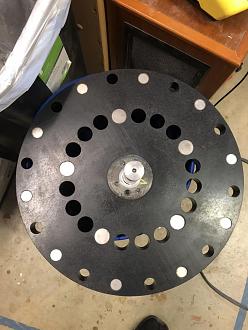

ID:	510443 All glued in magnets removed from rotor. Soaking in acetone to remove glue. All the ones currently in the rotor are North, so will install five South to have a N/S ten magnet rotor with LOTS of space between the magnets. If this solves the problem, will look at having sleeves made for each magnet.
