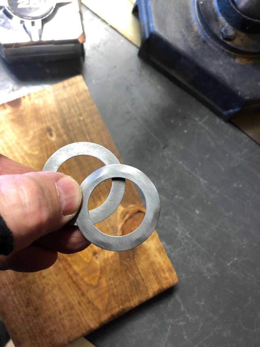

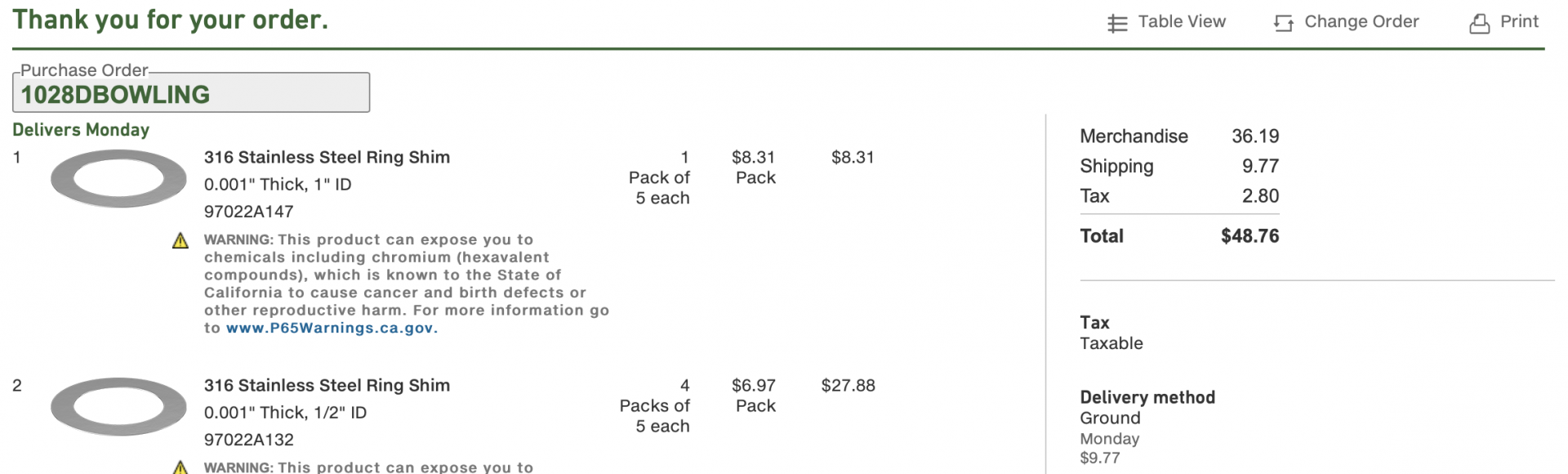

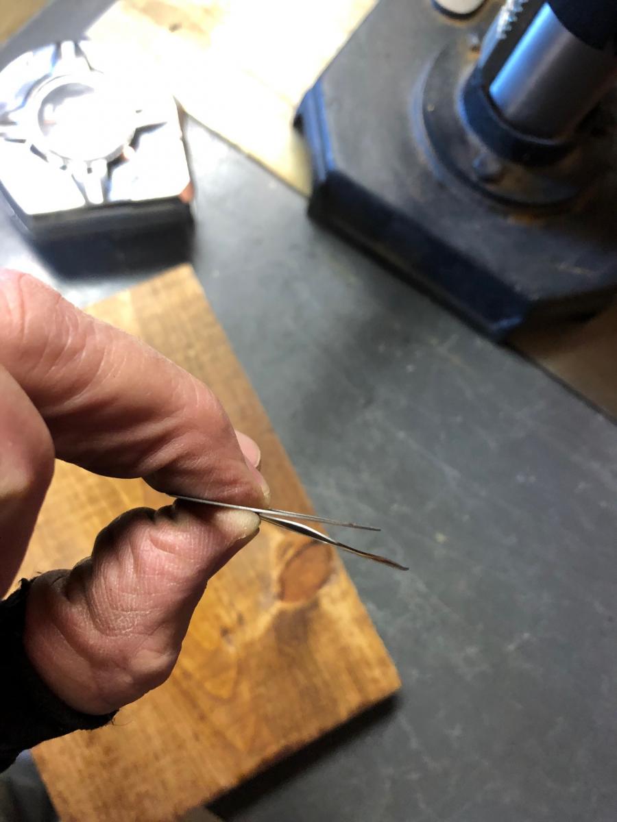

      1. I need to order spacers/shims, that fit on the 1" rotor shaft.
      There are currently two spacers about 2" long, (one on each side of the shaft plates that hold the rotor in place) that set the spacing between the rotor and the bearings. I need additional space or the rotor rubs against the coil holder on one side. For each spacer I place on the rotor shaft that moves the rotor away from the coil holder, it increases the distance between the two coil holders. This means I also need four spacers that go on the four bolts that hold the two coil holder blocks together (held apart by a spacer that would no longer be long enough.) I will start looking for them on line as soon as I post this. It also changes the alignment of the bolt holes that let me bolt the frame to the coil holders as I show in the video.
      Click image for larger version  Name:	McMaster-Carr.png Views:	0 Size:	441.4 KB ID:	507907
      Here Monday.

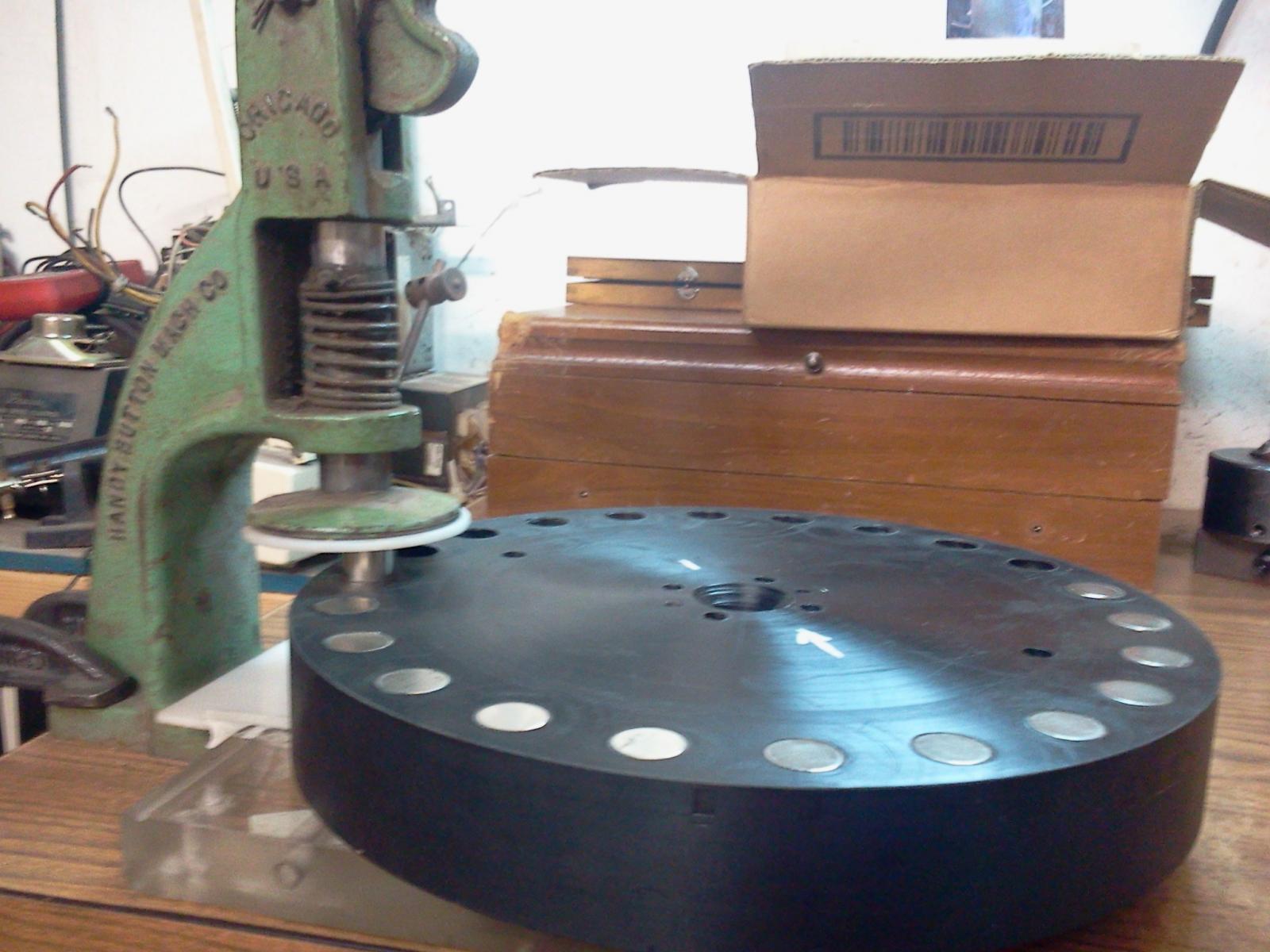

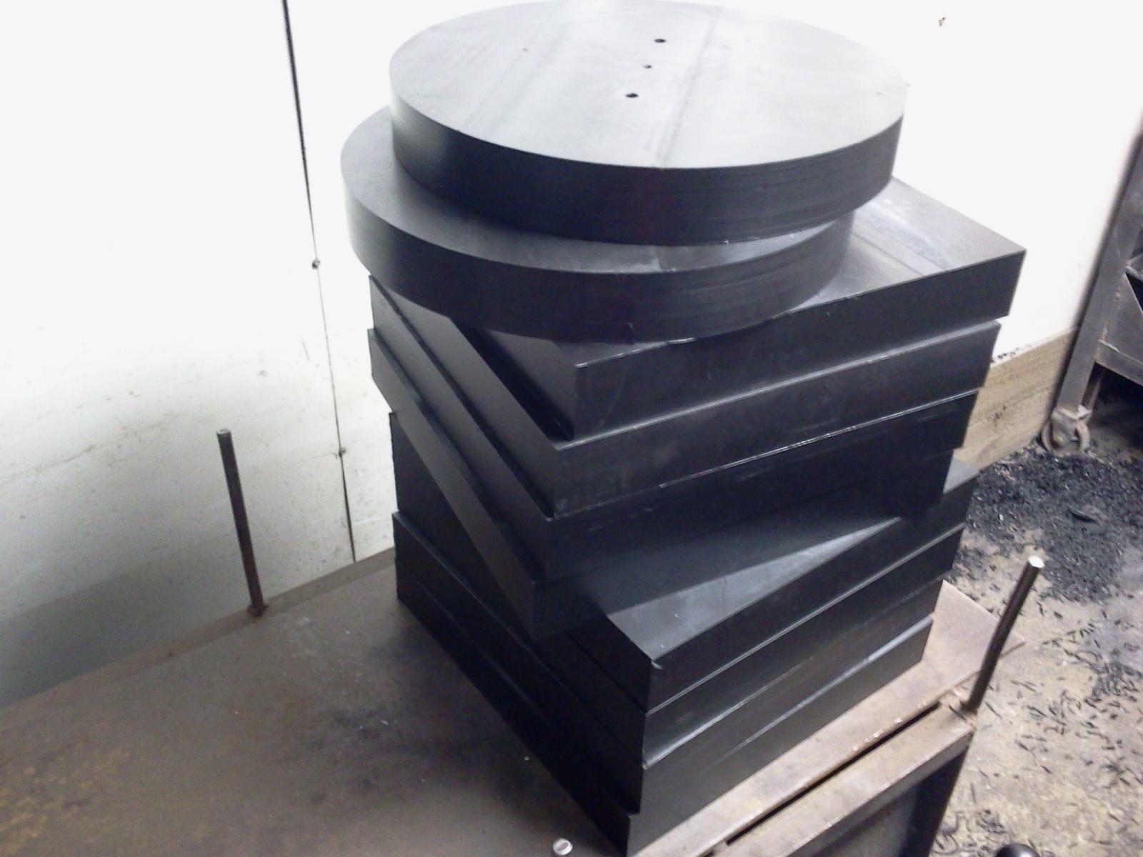

      The NEW rotor has:
      24 3/4 x 3/4 North/South magnets on one side of the rotor as generating magnets
      24 3/4 x 3/4 North magnets as repulsion magnets
      48 5/8 x 1/4 linking magnets
      24 3/4 x 3/4 North/South magnets on the opposite side of the rotor as generating magnets
      24 3/4 x 3/4 South magnets as repulsion magnets
        Here Monday.

        The NEW rotor has:

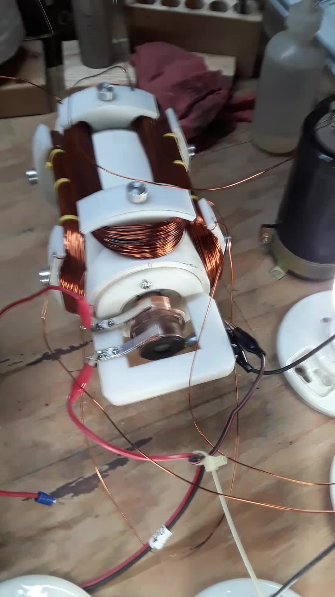

                  Here is a basic motor/gen I was playing with, proof of concept so to speak. It's actually based around what was called a Simplex motor back in 1890 but it has no iron in it - all air core so there are low losses. I show it running with a 0.6 watt input and a 1.2 watt output. It would be interesting to get some feedback of what people see with this motor. Specifically, if its seen as overunity, Cop of 2, or something other.
                  Dragon, do you have some kind of schematic of how your motor is setup? Motor, coil, caps, input, output, loopback.
                  • The shims go between a piece of steel and the bearing in the place that matters. The bolts in the four corners will be shimmed as well, but that is a steel shim between two pieces of plastic, and isn’t critical. It should be a fairly simple operation once the shims show up. By next Tuesday I will be ready for all the new coils and can start testing. That’s when I’m going to need the help looping this thing. Got lots of ideas. Have had several suggestions. I’m trying to figure out a way to do it with what I have without spending any more as I have already exhausted my budget for the next two months. It all depends on exactly what the new coils output with this 24 magnet rotor.

                            Where are you measuring input and output voltage/current?
                            • Originally posted by pmgriphone View Post
                              The input is C1 to the motor, the output is the power the motor is using to run. AC difference across C2 C3 and the current through the motor coils. The motor requires 1.2 watt to run as it does but only requires 0.6 watts to maintain it. The caps C2-C3 are pre charged to 13 volts, C1 is used as a push to imbalance the pair. C2-C3 never discharge, simply exchange energy back and forth similar to a tank circuit so C1 is the only one discharged. A diode can be used from C1 positive to C2 positive which will charge C2-C3 pretty high which is a huge benefit to the energy being moved back and forth. If you do use the diode you must make sure C2-C3 is sized 5+ times higher than the working voltage from C1.
                              It is not overunity in any way, shape or form. A Cop factor can be used because we are combining 2 different known energies for the end result. The Cop factor cannot be thought of as a way to "loop" it as some would say.... a cop of 1000, 10,000 or a million isn't unity. The actual efficiency of that motor as I see it would be 50%. It is still "loosing" 0.6 watts from the main supply source while supplying 1.2 watts to the motor.
                              The cost to build the motor was around 30 bux + time and was meant to be a proof of concept, designed to easily adapt other coils to the base without having to build a new motor from scratch every time I had a new Idea. That motor has been a few dozen different variations. As well other motors have done the same.
                              There is a lot more to it but for now I'll leave it there ....
