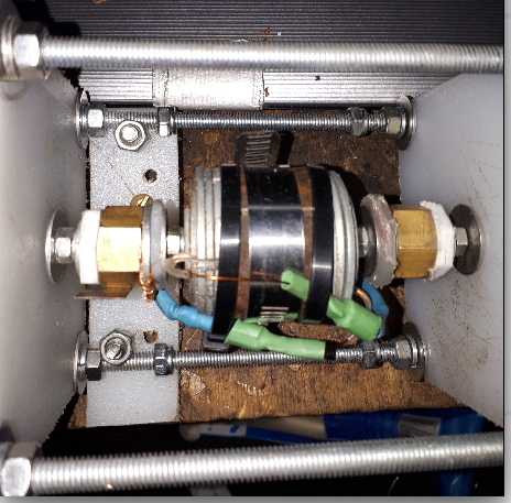

          Here's a look inside before it gets bolted up.

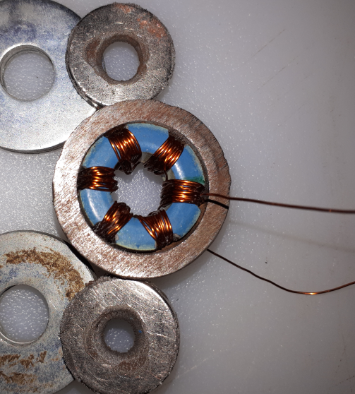

            A Bit more about this build, now it is nearly ready for testing. Ive stayed with the concept of a wound torioid sandwiched between two magnets, N or S facing inwards or opposing.
            Having come to the conclusion that flux cutting wire while entering the toroid makes opposing currents to flux cutting wire coming out of the toroid, giving a net result of zero, I should say something about the strategy this build uses to attempt to overcome this issue.
            It seems to make sense to me, that if trying to magnetically shield the wires in regions where induction is not want wanted, the best place to do this the outer face windings where there is more surface area to play with, in terms of making lower reluctance pathways around the wire.
            Thats why Ive gone for the outer flux guide and end guides, to draw the flux outwards where the windings are embedded into the toroid. Because the magnets I have at hand overhang a bit in the middle any stray flux should be drawn into the toroid through the inner face, so that is a bonus.
            Sometimes I wonder, did I back the right horse with this build, in terms of, lines of force rotating with the magnets, and will my attempts at shielding the areas of the toroid that cause cancellation, be enough to even show a voltage of any description. In terms of dimensions of components and strategies for shielding, there is so much room for improvement.
