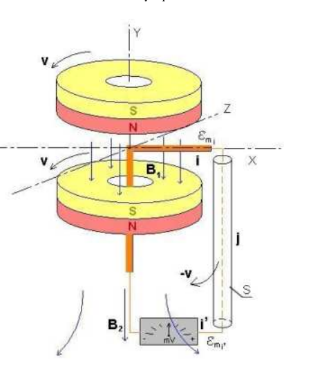

                          Thanks, I am just using the typical Scientific approach of "discarding of non relevant events" or "filter" in order to reach the essence or main cause.
                          As per your diagram, you are rotating both magnets (above-below) while the "U" shape conductor is static, correct?.
                          The way I see your above test is that it STILL brings the question as "What part of conductor is generating?"...Is it the Horizontal or the Vertical?...or Are both generating?
                          Bottom line, it does not discard possibilities, but have them all as "inclusive".
                          When we rotate Disc while two brushes are static, disc geometry have very small height, so it would be disregarded as any vertical conducting paths, then we move into only TWO POSSIBILITIES:
                          1- Two Continuous Inner-Outer Rings swept and DEFINED by the Two Inner-Outer Brushes.
                          2- A Single but DYNAMIC Conducting Path directly (LINEARLY) established between both brushes.
                          I wrote Dynamic, since whether Disc is static and just brushes rotate, or the opposite, Brushes are always sweeping different paths on the metal disc. Now, let's picture a Third Ring on this Interpretation, comprehending the series of conductive paths between both brushes...And so here we only have the TIME Parameter VARIATION dictated by Brushes positioning, which is CHANGING constantly with rotation of either Disc or Brushes.

                            Hi Ufopolitcs
                            Yes, I am also more into the Maxwellian approach. Maxwell goes very deep into his analysis about molecular and even atomic spins taking place within the Coil or simply, the conductor.
                            I'd love to get my eyes on something like that. For someone like me that sounds like a difficult read and would take alot of digesting, but it would be worth it!
                            No and sort of respectively. It was really just intended to remove the complications caused by the disk and brushes and replace them with a horizontal wire or bar. Then to be used in three ways, One for each possible scenario. 1 Magnet rotates while conductor is stationary. 2 Conductor rotates while magnets are stationary. 3 Both rotate together.
                            About the diagram I posted, there are a few things I should clear up about that so that it is seen in the context that it was intended.
                            I didn't make the diagram myself, I pinched it off a PDF, that I had downloaded previously. It seems that the authors of the PDF, were a very well educated and well funded group of individuals, who were attempting to make a brush-less, simplified, homo-polar generator. Meaning that the magnets were intended to spin while the horizontal conductor remains stationary. The device itself had quite a different geometry, but that diagram was submitted along with others, to give a general idea of what thay were doing.
                            Although they are doing the right thing for science, by reporting a negative result, it seems that they were at a loss when trying to explain the negative outcome. Well, at least within the parameters of the Einsteinian paradigm. I'm not sure if it was because they didn't want to upset the cash cow, and the rest of the scientific community or whether they simply weren't aware of an alternative view regarding flux rotation.
                            Yes, I agree with that, you want to be very thorough. That is understandable. To some extent this had occurred to the authors. My guess is because of the negative result, (seemingly unexplained), they had to come up with something if they were to get more funding, so they came up with an in depth analysis of everything involved, from minutely analyzing Maxwells equations. to the such and such crystalline room temperature superconductor. Along the way they discussed the effectiveness of the mu-metal magnetic shielding, and the effects that could have had on what they would have considered to be the rotating magnetic field. I didn't see any mention of the possibility of high current eddies inducted into the vertical parts of the conductor either, maybe they thought the probability of that was so low it wasn't worth mentioning, or it didn't occur to them.
                            The picture I had posted wasn't really intended to include those levels of complication, so by rights, I should have opened it in paintbox or something first, and rubbed out stuff like the direction of magnet spin, the polarity of intended inducted currents, and the mu-metal shielding and so on. So I'm glad you pointed that out. Thanks. It was really just intended to remove the complications caused by the disk and brushes that led to the dual interpretation of what is happening with the magnetic field, and help add weight to one perception or the other.
                            Agreed the diagram as I intended it, doesn't take into account the points you have raised either. It wasn't intended to be a comprehensive tool for the study EM induction but more of an attempt to force one party or the other to come up with more and more creative objections.
                            Now I am starting to see the need for why they had to go to open circuit analysis. The pioneers had to be very meticulous and you have adopted that attitude as well. I think that is to be commended.
                            I don't think this is the response you might have wanted, or that you will find it particularly satisfying, but as for the parts of your post that I haven't commented on, it is not because I don't agree with them or don't acknowledge them, I do !!! , and think they could turn out to be extremely consequential, but the last few days has taught me that it is not good for me to post the first thing that just pops into my head, just for the sake of it.
