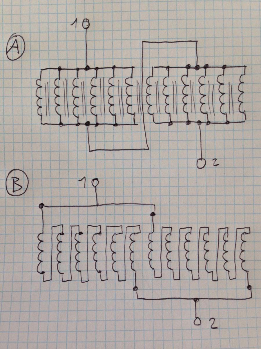

            Dave, ok, it's actually still not what I thought. I thought you meant six strands connected in parallel are in series with the other six strands that are connected in parallel with each other. Then I reread your sentence: "...so it appears I only have six strands on the coils". So is it A or B of the attached drawing?
            Mario
            • Originally posted by Turion
              Mario,
              Sorry, your picture is hard for me to make out on my phone, but I don't think it is A or B.
              The coil is wound with 12 wires in parallel. When I finish winding the coil, I take a single wire and put it in series with one other wire. That gives my one wire twice as long. I do this six times in total. Now I have what appears to be only six wires on my coil because there are six beginnings and six ends.
              So I end up with six strands in parallel. Each strand is composed of two wires that are in series.
              Okay thanks Dave and Mario I misunderstood the strand numbers that
              Dave has also Mario. So holding to the coil amounts of 3000 feet Dave
              MIGHT have 250 feet per strand so 2 in series is all Dave needs to SUUL
              or 500 feet. But the part that really blows me away is that under normal
              conditions if I put another 500 foot section in parallel with the first 500
              feet you wound expect that the resistance would thrown out things.
              These parallel series Tesla connections are very strange indeed. Then
              to realize that 2 strands in series is 500 feet but must be bifilar
              because it won't act the same as a straight 500 feet is a hard one
              to wrap my brain around too.
