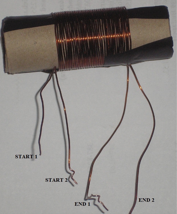

Just out of curiosity, I have built a single layer, air cored bifilar coil from enamelled copper wires putting them side by side (no twist) on a 3 cm OD paper bobbin, wire length was 2 x 210 cm from wire OD=1 mm (AWG 18), it gave 21 turns. See attached picture 1.
Measured inductance between Start 1 and End 1 is 8 uH and also 8 uH between Start 2 and End 2.
Measured inductance between Start 1 and End 2 (the two windings were connected in series aiding phase) was 30 uH.
The ratio is 30 uH/8 uH= 3.75 this is close to 4.
Measured capacitance is 270 pF between either Sart 1 and Start 2 or between End 1 and End 2, (the not being measured wires were freely floating, of course).

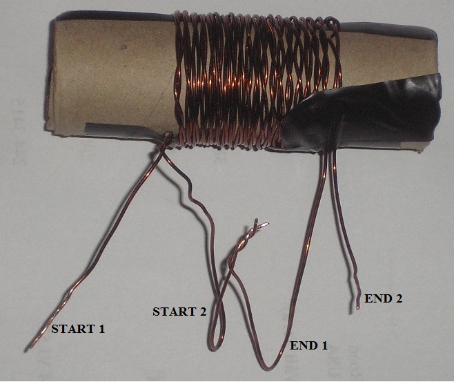

Then I unwound this coil and twisted the same two wires, roughly by 2 twists per inch and rewound it onto the same bobbin, to have 21 turns again. See attached picture 2.
The measured capacitance was only 230 pF between Start 1 and Start 2 or between End 1 and End 2. But this smaller capacitance versus the above case stands to reason because the angled wires could not have as many facing surfaces as they had in the side by side, very close guided to each other case.
The received inductance between Start 1 and End 1 was again 8 uH as was also between Start 2 and End 2. Likewise, the measured inductance was 30 uH between Start 1 and End 2 (winding were in series aiding phase).
IF somebody has confusion what a bifilarly wound coil connected in series aiding phase means, well it means that the end of the first wire is connected to the start of the second wire if you label the starts of the two parallel guided wires as start 1 and 2 and you label the ends of the two wires as end 1 and end 2. This means also that you have to prepare in advance two wires of appropiate length from two different rolls and always guide them in parallel while making the bifilar coil. (Of course you can cut twice the needed length of wire from one wire roll too and then guide the wires also in parallel while winding.)
The series aiding phase connection is the same you show in the above picture.
So the answer to your question is that with this single layer air core bifilar coil there is no difference in inductance between a twisted and the side by side guided (not twisted) winding styles. IT is possible that for a multilayer bifilar coil the twisting introduces some change in inductance because the capacitance between the twisted wires will be different from that of the side by side wires. The capacitance between the two wires is transformed in parallel with the bifilar coil so it has the tendency of reducing the overall inductance. Notice also that using ferromagnetic cores the capacitance also changes between the two bifilar wires (usually it increases the capacitance between the two wires).
