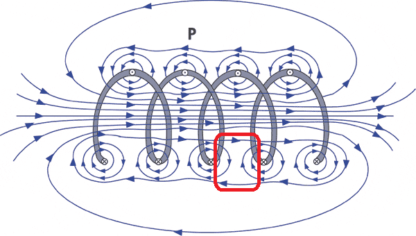

    Bob, you've lost me.
    In the highlighted region below, how can this be considered attraction?
    You are meaning electrostatic attraction correct? Not magnetic?
    My thinking is if the voltage/current ratio is specifically chosen, the electrostatic force and the magnetic force are in perfect balance. At this point we have something rather unusual taking place.
                  Hi Dog-,

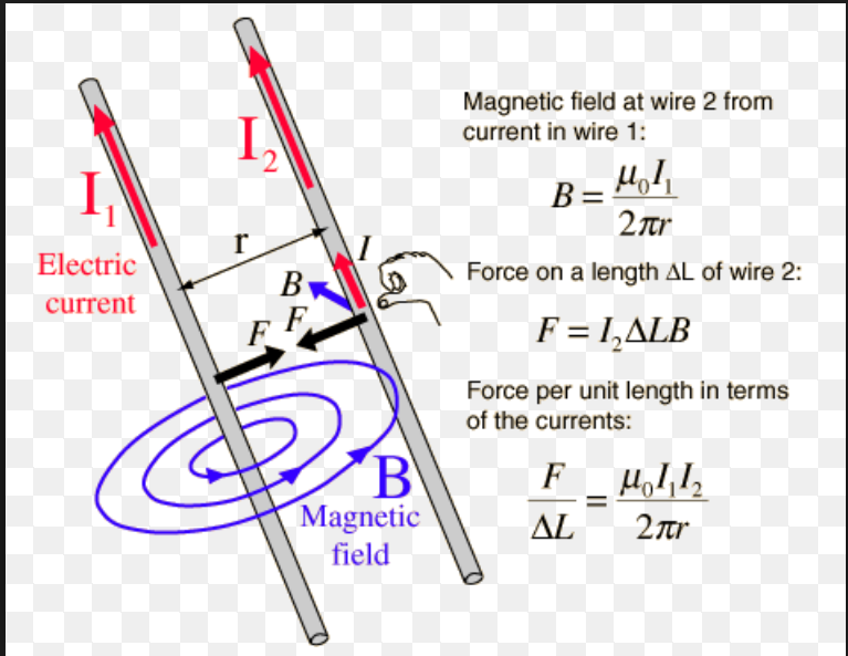

                  Mind if I comment? These wires are attracted to each other when carrying current. Here are a couple references:
                  Principles of Magnetism | Magnetic Products and Services
                  Forces between currents.
                  Hope that helps,
                  • 1 wire (as i a coil) vs. 2 wires (as in the picture)
                    Hi Dog-,
                    Hope that helps,
                    There is a simple way to verify how the force acts between turns: wind a few turns on single layer using a cylinder then take the cylinder out. Lay the coil with all its turns loose on the table and energize it with a battery. Do the coil's turns spread or come together?
                    Regards.

                      I would say, "It depends."
                      Are the magnetic forces dominate or the electrostatic ones?
                      Erfinder is on to something, something I know I have overlooked. If you take the individual windings of a coil, their "interwinding capacitance" is on the order of fractions of picofarads. I for one have always ignored such small capacitances. Bad assumption.
                      I think we truly need to re-evaluate the geometry and possibly the materials we have been using.

                      • Between the turns in the image I posted you will experience repulsion.
                        Don't take my word or anyone's word for it, perform the necessary tests and see it for yourselves.
                        The field relations between the turns in the solenoid are not the same as those between two parallel conductors carrying current. In the former you have one conductor carrying current and in the latter you have two....the comparison makes no sense.
                        It is not my job nor anyone else's job to get into why they are not the same, again here simple tests that you make up and do yourself yield all the information you will need for clarity.

                            Both these conductors carry current, I1 and I2. If one has no current, then the I1 * I2 product is zero and there is zero force.
                            edit: It doesn't matter if I1 and I2 are the same current or if they are from seperate sources.
