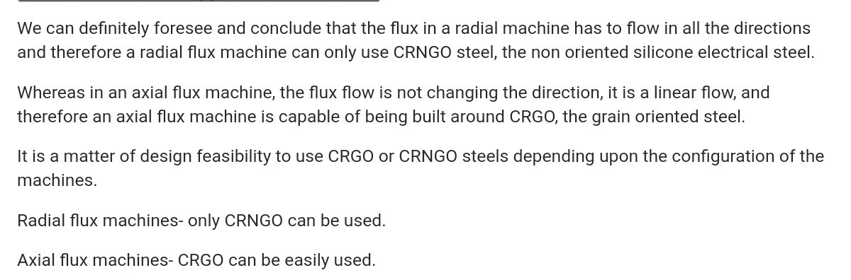

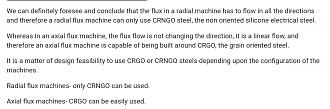

      The best core I can find for an axial flux design is laminated.

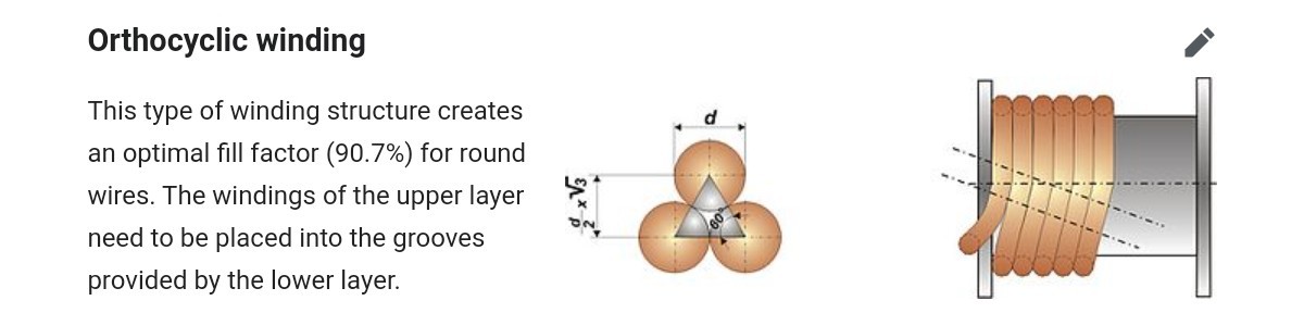

      Also consider the "fill tactor"

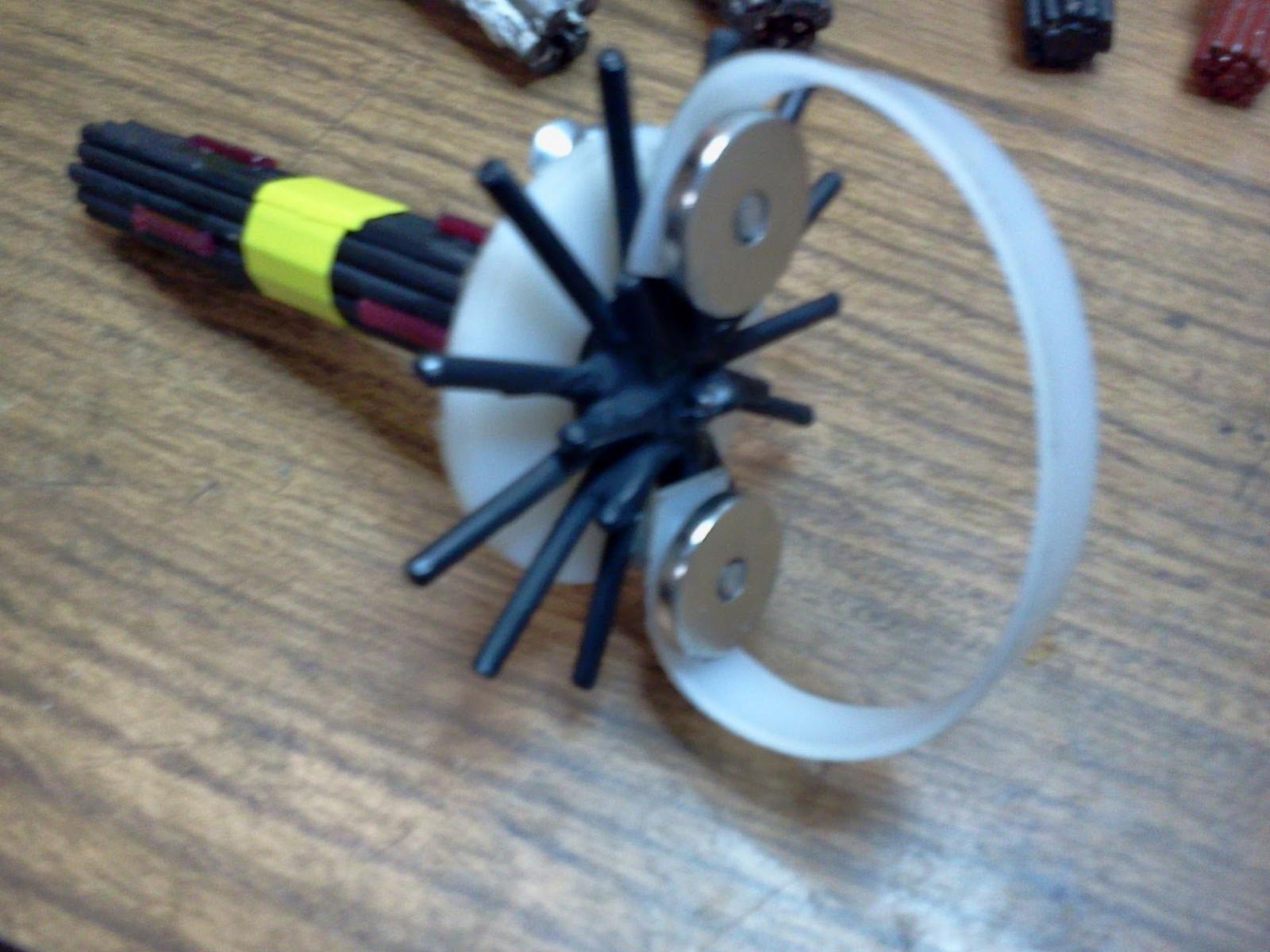

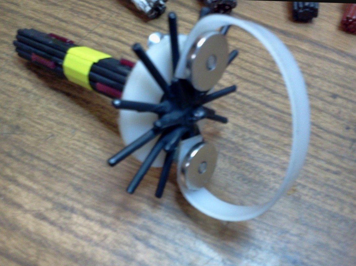

      • Here is a picture of the current core he is working with. Click image for larger version  Name:	A165BAA3-52CC-4A9E-80CB-8CE6DAD30C57.jpeg Views:	0 Size:	161.5 KB ID:	504096Some of you seem to think I feel like I am the ultimate authority on how to wind coils or what core materials to use. PLEASE! I have used what I could get my hands on, afford, and have always been limited by the tools I have available in my shop. I have ALWAYS said that more research needed to be done on core materials, and the big project my machinist is working on RIGHT NOW is a coil winder to wind 12 strand coils.
        My machine is just a prototype to prove TWO concepts. I never believed I have all the answers. You look at what I have done and see all the shotrtcomings. Fantastic! Let’s figure out how to fix them and output even MORE power. I’m all for THAT! If I can get far MORE out than in with hand wound coils and “iron rods” for core material, just imagine what can happen when some real technology is applied to this design by people who aren’t working out of a garage trying to accomplish three other projects at the same time. I have the house I live in to maintain, the one I am remodeling, and I’m 66 years old. Who do you think maintains the house I bought for my mom who lives 3/4 mile from me. She’s a bit older than I am. This project deserves the attention of people who are committed to its development, which is why I disclosed it here instead of keeping it to myself. And did I get a bunch of people doing replications moving the work forward? A couple. But mostly I got cheerleaders or critics who build nothing and don’t contribute a damn thing in any meaningful way. In fact I waste MORE of my time responding to them when I could be trying new things. So have at it guys. Wind coils correctly. Use laminate cores or metglass or ferrite or bamboo. I don’t care. Whatever works and produces more output.

                    • Turion's resilient and he'll keep plodding on 'till he gets there. I didn't realise that this photo was of an actual core.
                      I would think the radiating spikes are an attempt to dissipate heat and there are a couple of neutralising magnets and a carrying handle.
                      One thing I haven't quite worked out is why there is a number of taps on each coil. Are they used for adding capacitors?
