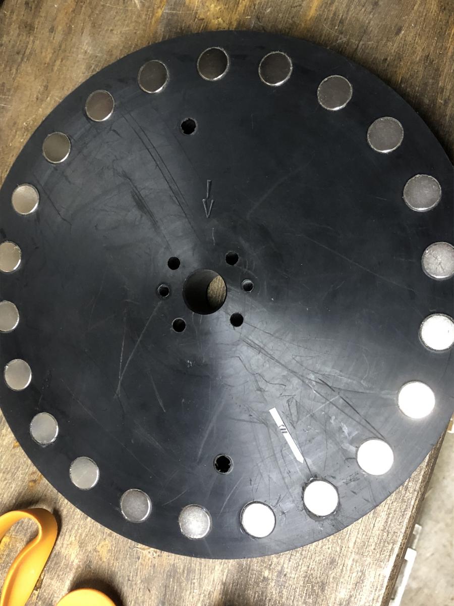

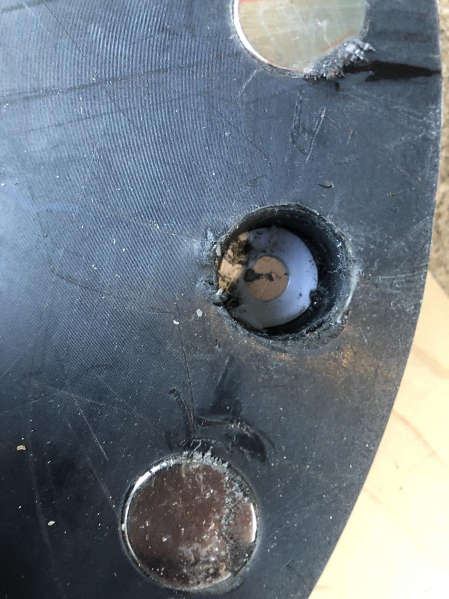

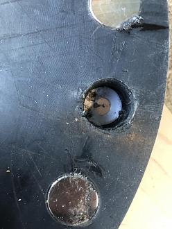

        Ok boys and girls. I got some good news. Was able to get that dang magnet that was sticking up too high out of my rotor and replaced it already. It involved a lot of careful work with a masonry bit and a punch sharpened to a needle point on the grinder and driven in at angles once a straight hole was started with the bit. Sucked the pieces out with the stack of 10 neos I have to do the opposition magnets. They had more pulling power than what was left of the broken magnet as long as I made solid contact. You can see that F*%#! white plastic spacer down in the hole.
        Replaced the magnet with a new one (the white arrow in the picture) and all is good. My replacement magnets will be here Friday but I should have most of the machine together by then. Still need to figure out how to mount the motor and connect it to this new, much larger, shaft. But I’ll figure it out. I’ve come THIS far. The finish line is awful close. I cannot wait to get this up and running and see what it is capable of. When my sweetie goes to bed in a couple hours, I'll hop on down to the basement and see how much more I can get put together. Probably everything except the one missing magnet I had to use to replace the rotor magnet I pounded into pieces. If I get the first half put together, I can start working on the motor mount that will have to be built and the connection of the motor to the generator shaft. Regardless of what issues I run into, I should have the whole thing together by this weekend. Sunday I will either have the whole day free to put this together and test, because my contractor its working at my remodel, or I will have to spend the whole day hauling water for him while he grouts all the tile in my house if his son isn't able to do that job. So who knows. Getting very, very close.
