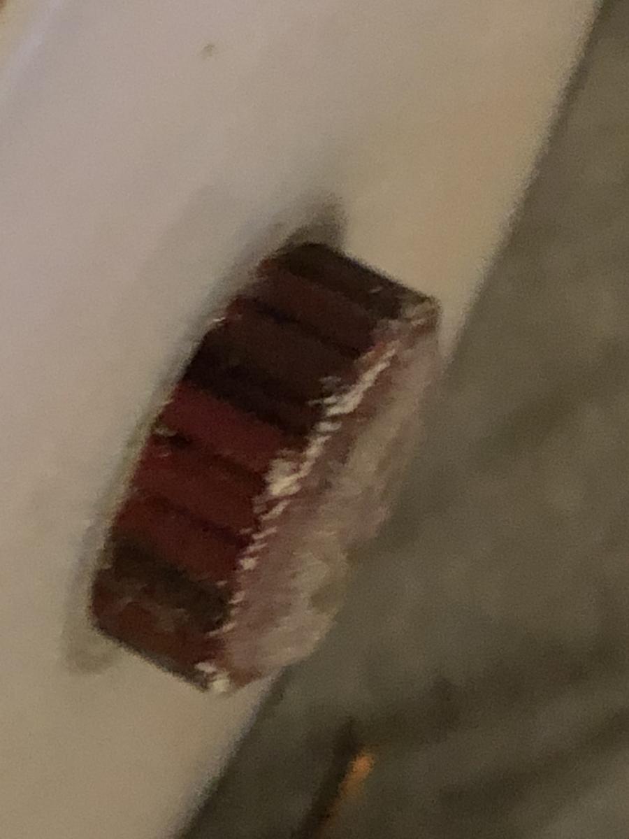

Ive used nuts , bolts and steel threaded rod as core material. With just 1 core the prime mover couldnt break the magnetic lock and its input power nearly doubled. So I used the thinnest stainless rod i could find 4 or 5 mm and wound a neat coil of plastic coated steel garden tie wire 20mm diameter and used that as the core.
The prime mover broke the lock, used a fraction of the additional power, and the same genrator coil made heaps more power.
Im that happy with them i will be using them for the duration.
