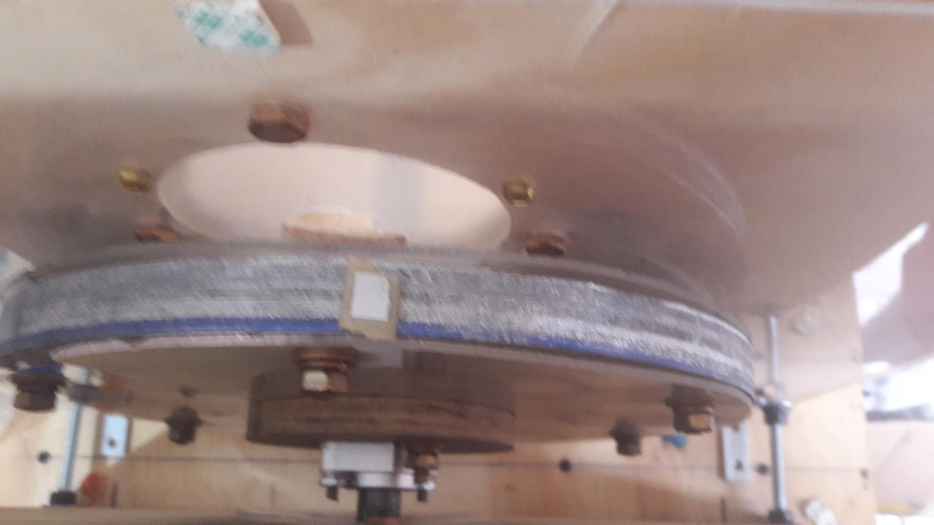

            I was working on the generator, I had to reassemble it, since I had removed some layers of it to free the rotor with the magnets and to be able to test other coils or do other different tests.

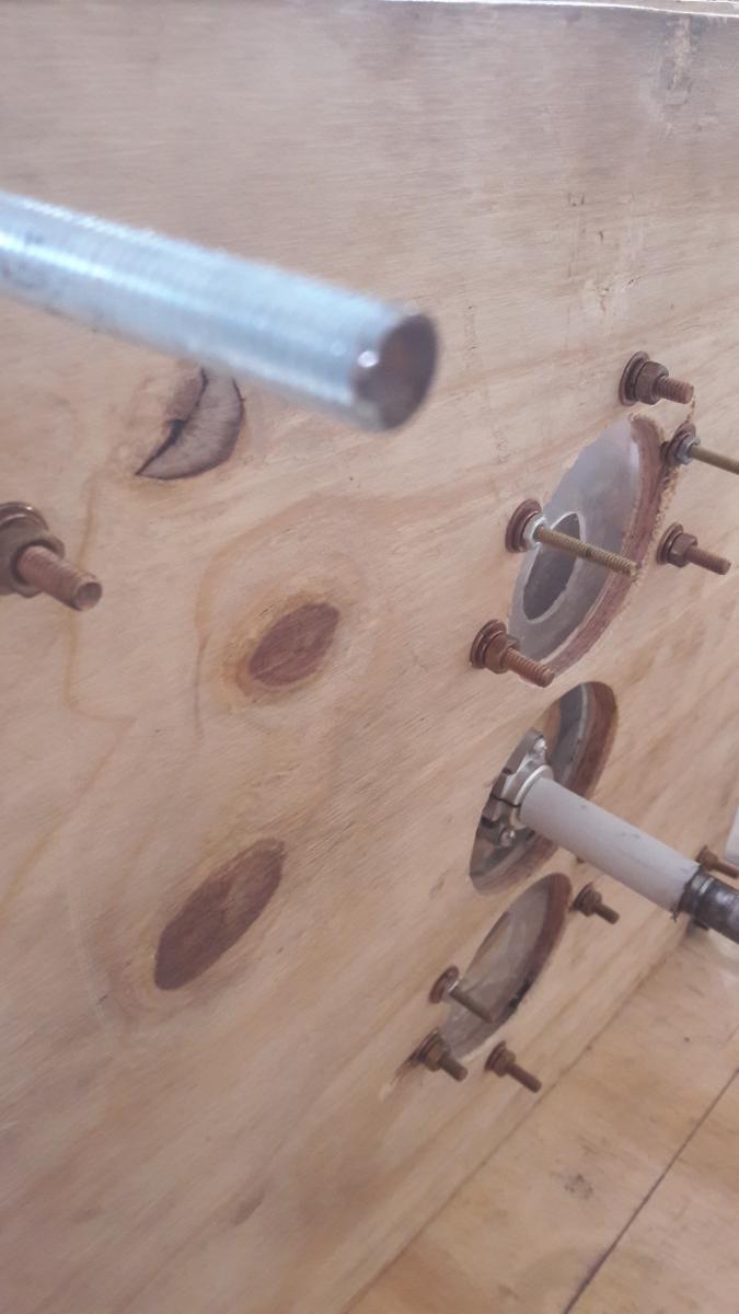

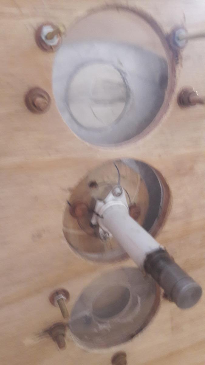

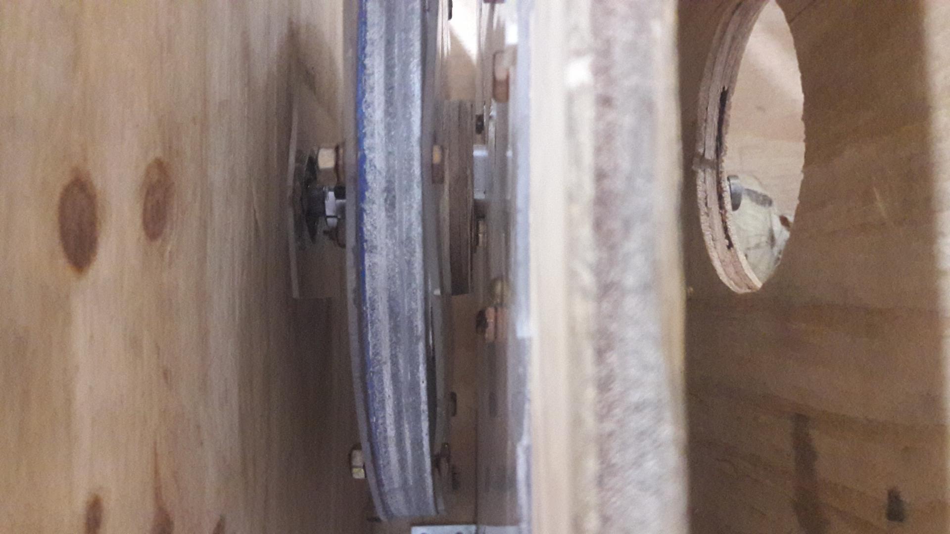

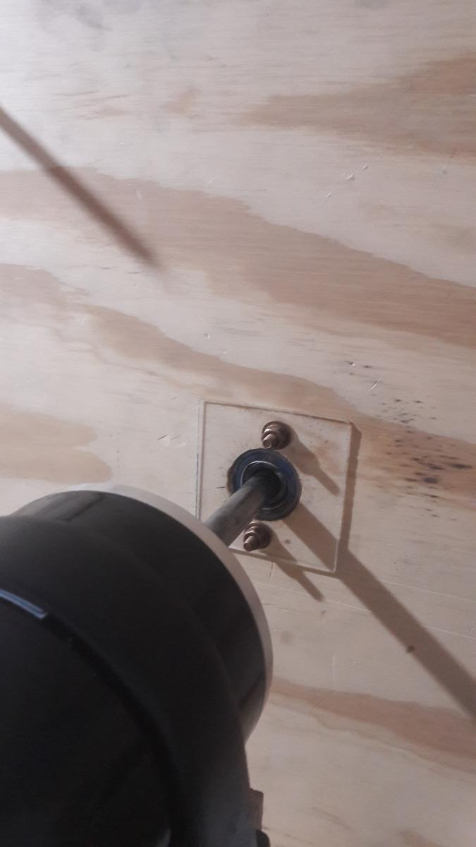

            I show you some photos of my generator, it is simple and inexpensive, so that whoever wants to build something inexpensive can do it, but that if functional, to prove concepts, I admire Mr. Dave's generator very well assembled and built.

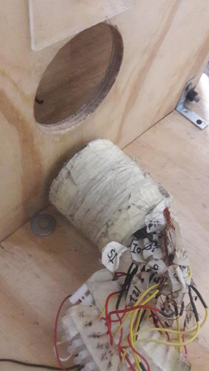

                ok I built the coil with wire number 23, 256 feet each thread, 12 threads, with the dimensions of the spool that it released,
                spool 3 1 / 2x 3, F 3 1/2, T 3, B 1, A 3/4
                The core used welding rods
