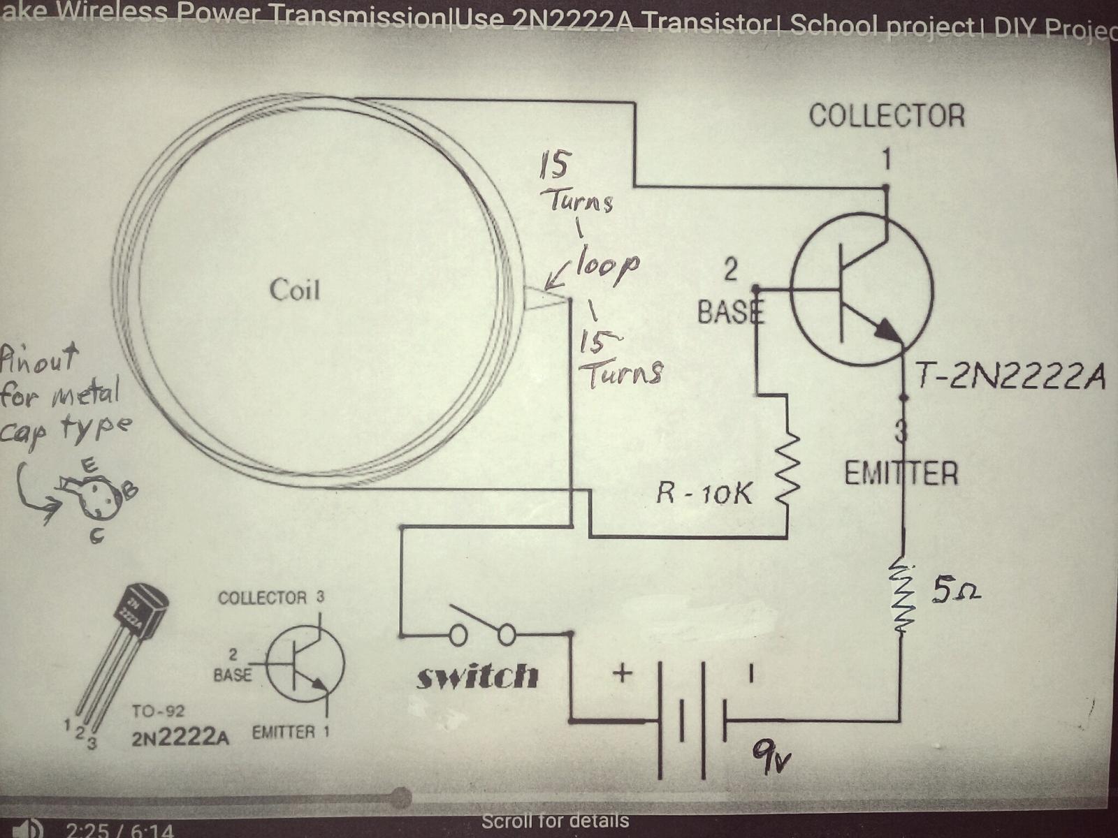

BroMikey, I don't think that I will be vanishing too soon as I have no intention to try to make money or go into business making anything that will upset the applecart. I'm retired and I want to put together stuff that works for me and mine. Going up against big business to sell a scooter mod is not my idea of retirement. I prefer eating, sleeping, and sex without having to look over my shoulder to see if men in black are intruding. It spoils the mood.
Here's another short video: https://www.youtube.com/watch?v=69CT...ature=youtu.be

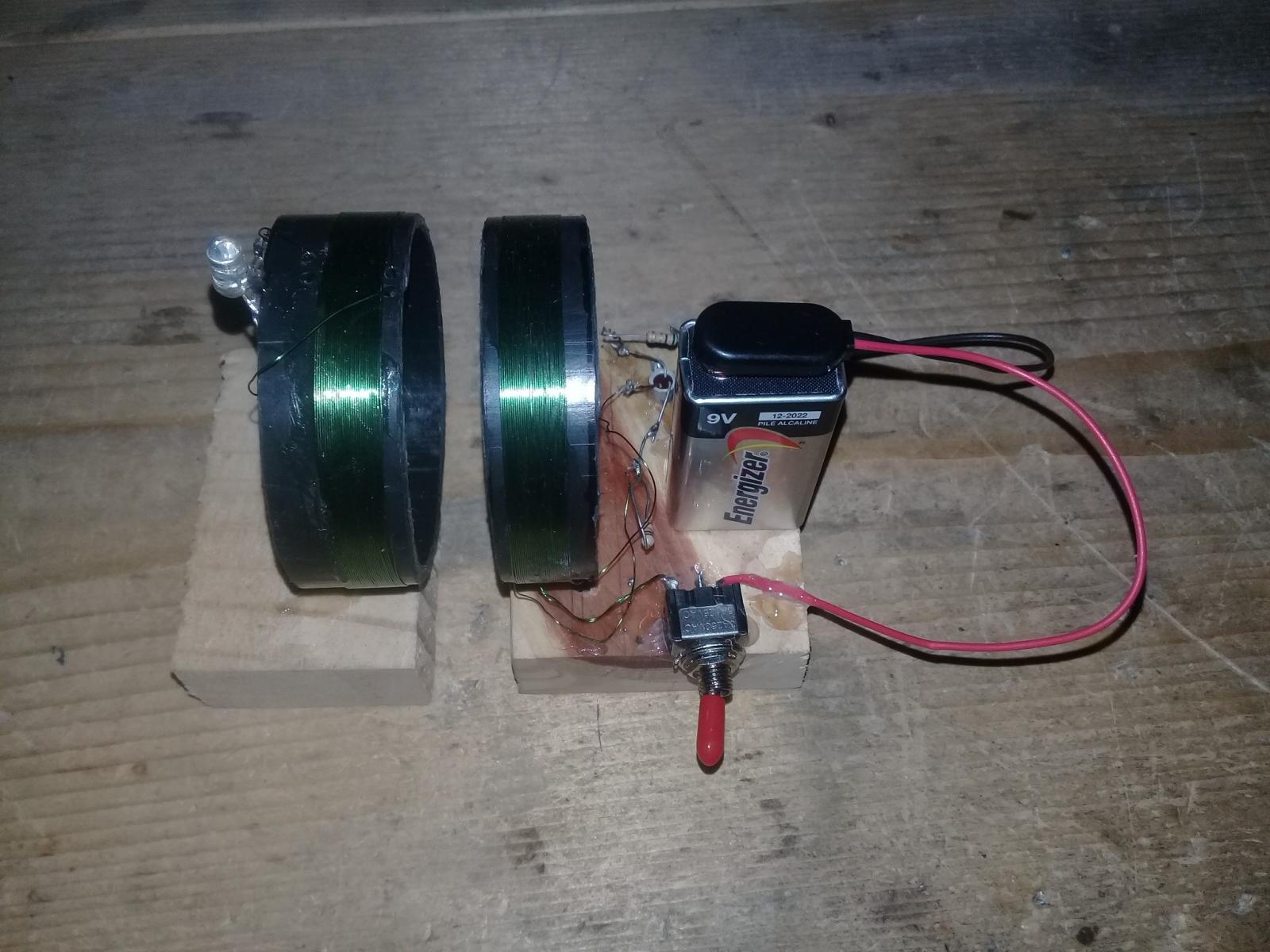

I added a 5 ohm resistor to the circuit because the battery dropped off too quickly. The amp draw must have been excessive. After adding the resistor, the LED was still extremely bright, maybe too bright. I may add more resistance (I tried 10 ohms and it wouldn't light at all).
I can't wait to show this around. I think young and old alike will enjoy it.

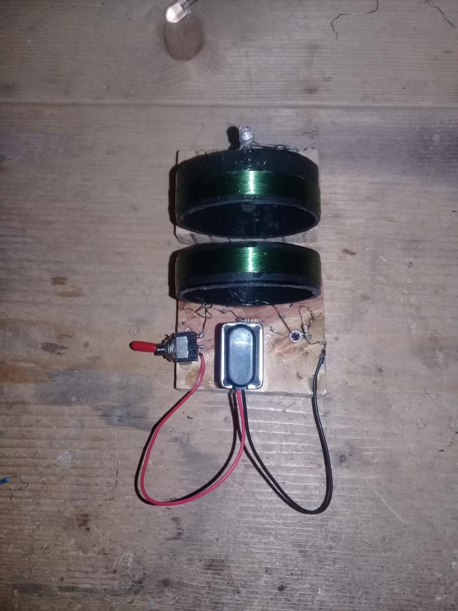

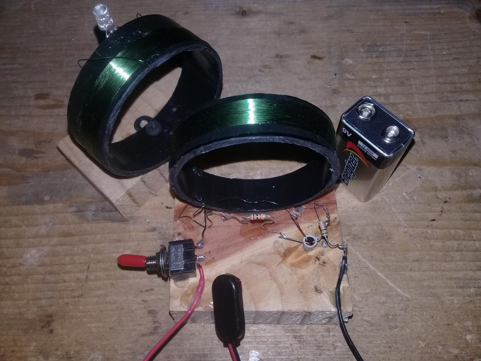

I should have included a little bit more info in the last post. In winding the coils, for the transmitting coil you wind 15 turns, then make a loop (which is only there as a center tap that goes to the Positive battery post), then continue another 15 turns in the same direction as the other 15. This is a pretty clever way to trigger the transistor.
The secondary coil with the LED is just a straight 30 turns with a 3mm LED across it. This is a very simple project...if you get lost in it, you might consider taking up knitting (just kidding, if you have a question, I'll gladly answer).
Bob

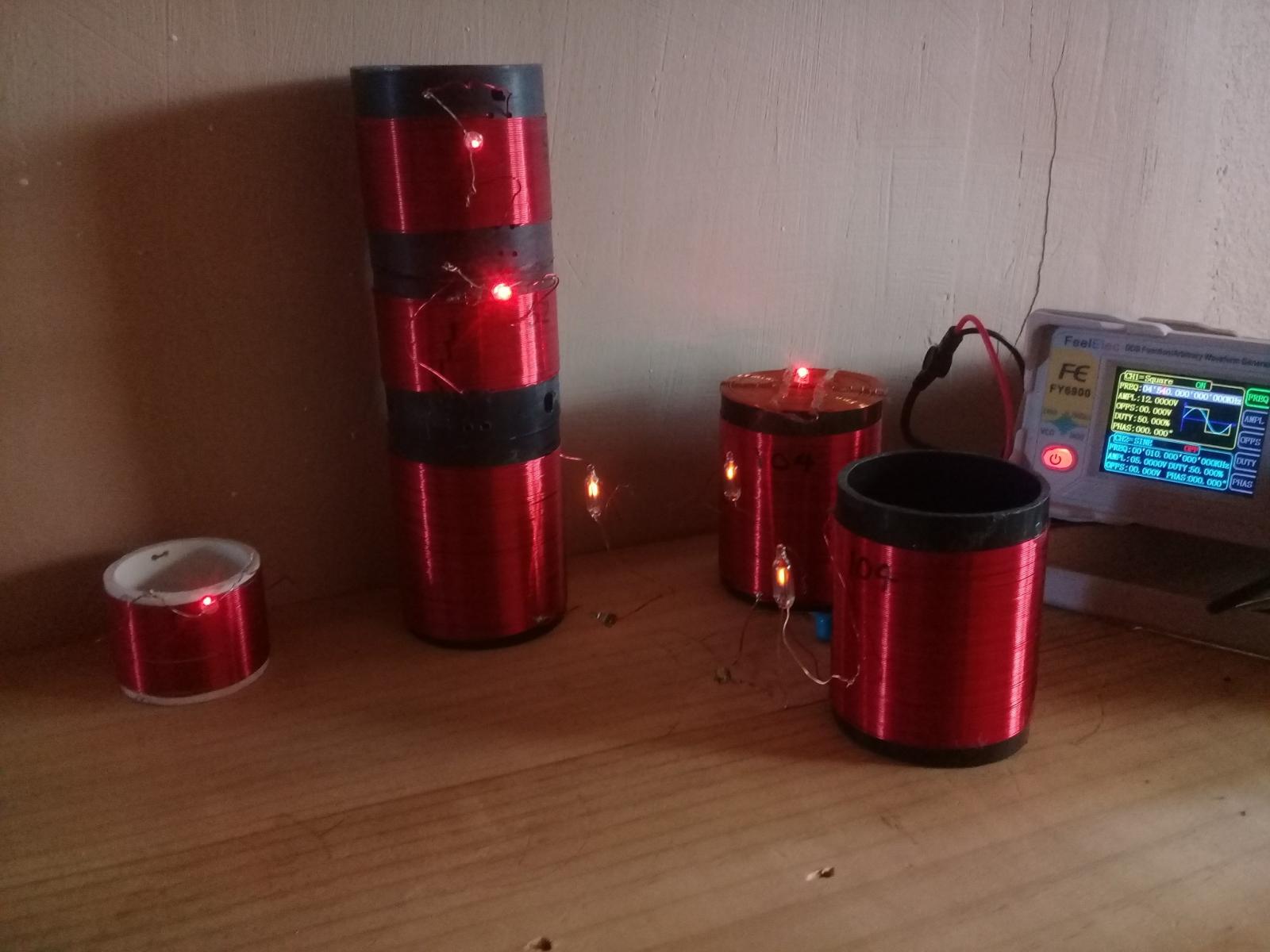

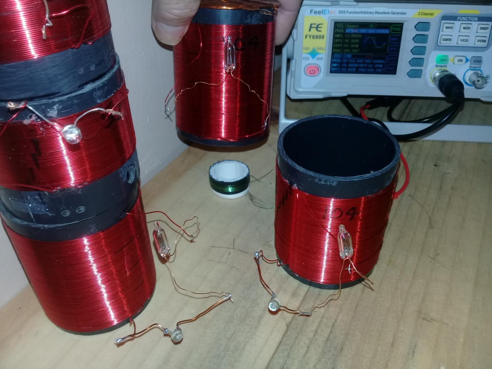

Here's a couple of pics of a setup that I've learned from. The little green coil is the Primary that is sitting inside the coil that I am lifting. The Primary is 13 turns of 30AWG on a 1.125" core. The black coils are 52 or 104 turns of 24AWG on 2" PVC (2.375") and the white large coil is 52 turns of 24AWG on 1.5 PVC (1.875"). (13 x 4 = 52, 13 x 8 = 104)
I can't measure everything and I'm not concerned about OU at this stage, but it does show that multiple secondaries do not affect the Primary input. Also, the different configurations work and have strengths. You can "force" some effect even when things are not perfectly in resonance it you provide enough input, resonance makes the main difference and there is a range of resonance that still works well...it's not just one narrow frequency.
