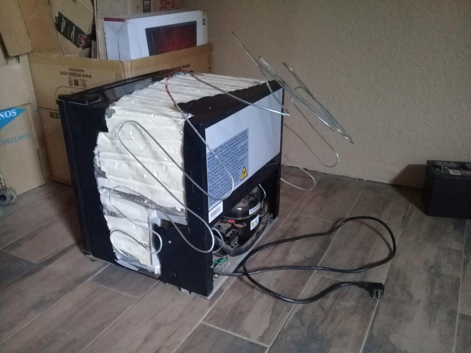

      Hello guys,
      I modified this small freezer by placing the condenser coil in water. The original setup from the manufacturer had it buried in on the insulation beneath the metal cover. This meant that the heat released from the condenser coil was trapped in with the insulation. I removed the coil (without opening or breaking the freon system) and placed it in a 5 gal. bucket of water which is way better than air for conducting the heat away. The unit has been running for 2-3 days and the water has stayed between 73 and 78 degrees. The inside is at -28. That's cold enough for me.
      I had done the same thing with a small chest freezer that I bought at Home Depot and had placed the bucket outside under the house so that it was out of the sun, heat of the house, and the Earth could also act as a heatsink. With a lid on the bucket, I never had to add water. I also swapped the thermostat out for a refrigerator thermostat. The run time was originally about 30-45 minutes. The modification lowered it to 7 minutes. I had also added 2" of rigid Poly-Iso insulation on the four sides.

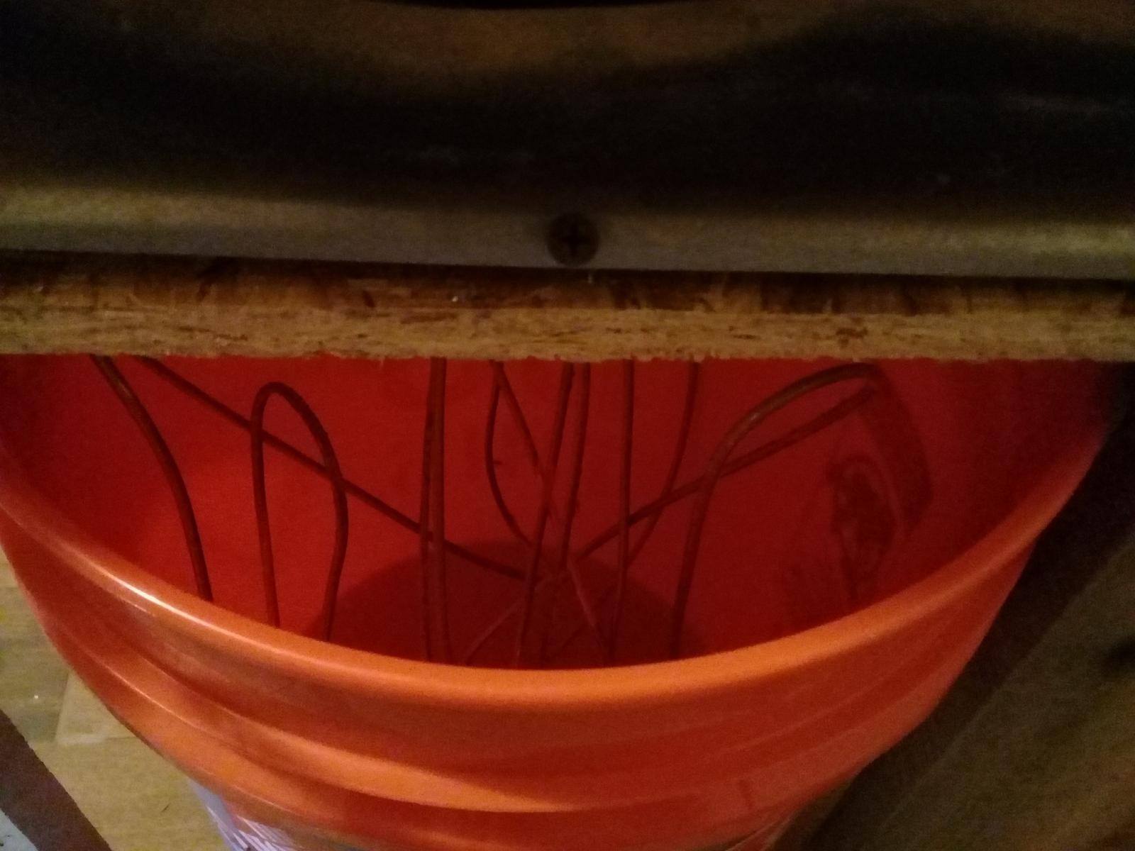

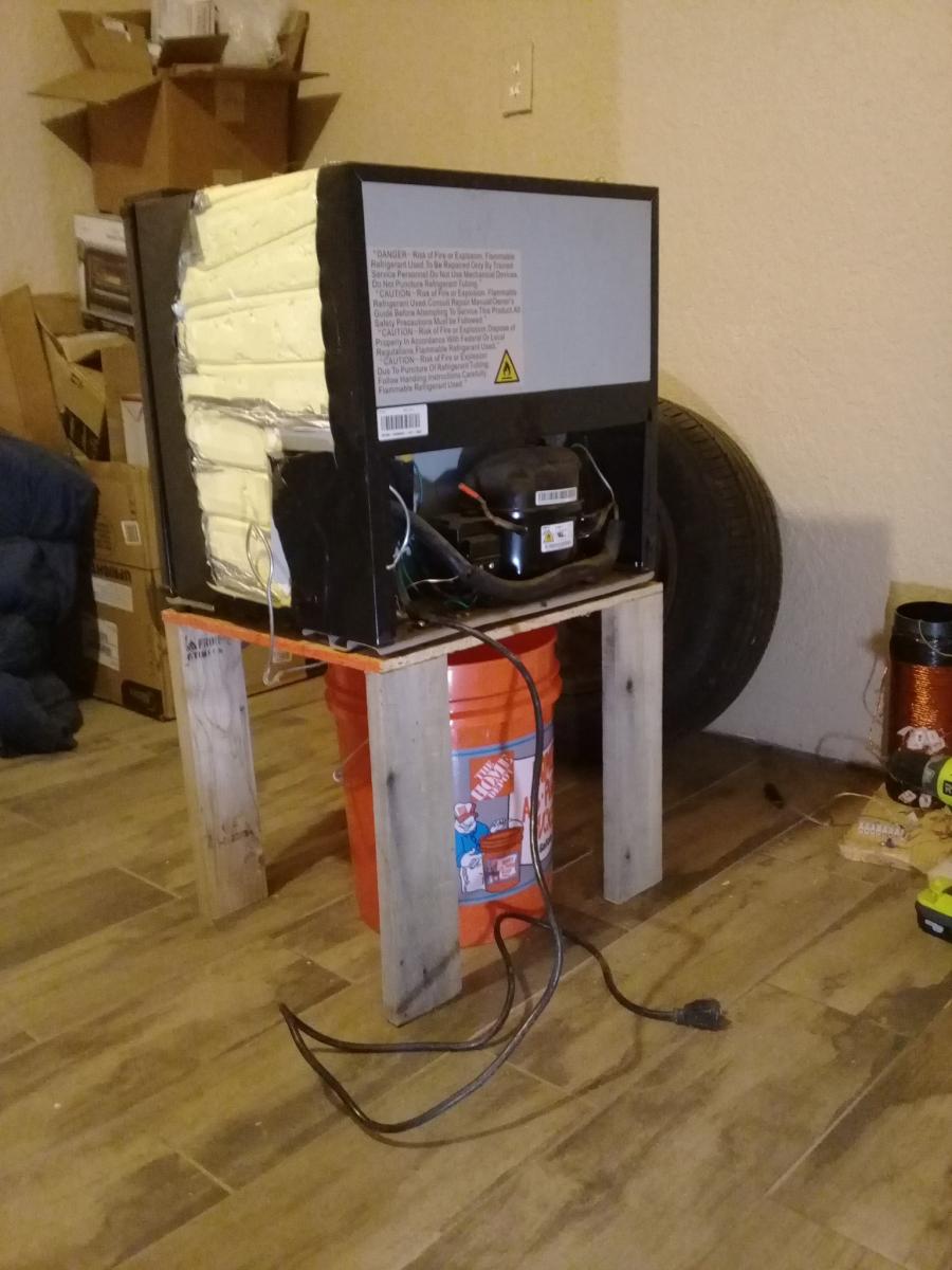

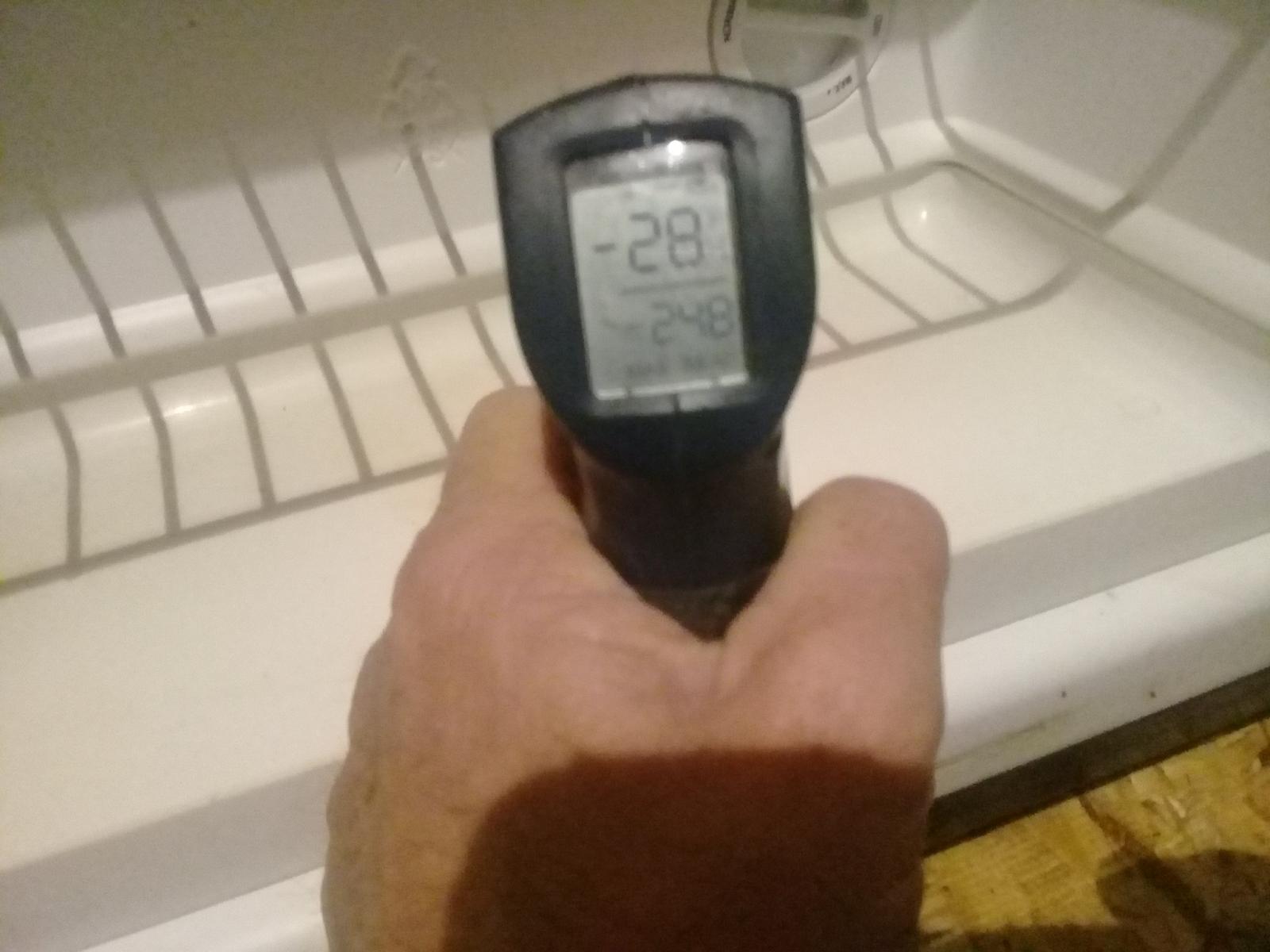

                OK. I finally got it. I think that I was unaware of the Upload Attachment button at the bottom. I kept pressing the Attachment button at the top.
                Here's the pics. The freezer has been running fine and the water cycles between 73 and 78 degrees. I don't think that I will have any problems with the water getting too hot, even during the summer.

                • Hey Bob that is a kool setup, thx for getting us the information in picture form on how it was done. Yes evaporation cooling works much more efficiently than the factory one used in a college dorm.
                  • Better Cooling.
                    Thanks, BroMikey. The water takes the heat away from the coils more quickly and efficiently than air, but the water is not evaporating. It simply holds the heat, which eventually dissipates to the floor and air by convection, not evaporation. The water need never be replaced, if well sealed in the bucket. Because water holds energy in many different ways, when heat is introduced to it, it translates it into different kinds of energy and shifts it around. So basically, water remains cooler than the heat introduced to it would indicate.

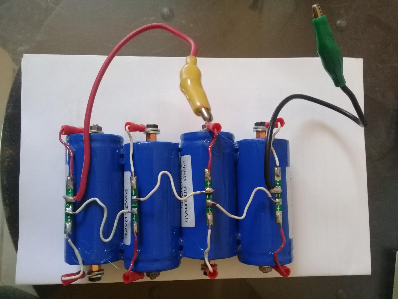

                          • LiFePO4, 6Ah Battery.
                            Hey BroMikey,
                            Yeah, the swamp cooler thing sounds great. I don't know where your farm setting was setting, but when I lived in TN the humidity was impossible...0% in the winter and 85% and up in the summer. I had a leather jacket that couldn't make it through the summer without getting all mill dewed. Now I'm in Ensenada, Mexico and the humidity is normally 45-70%...very livable.

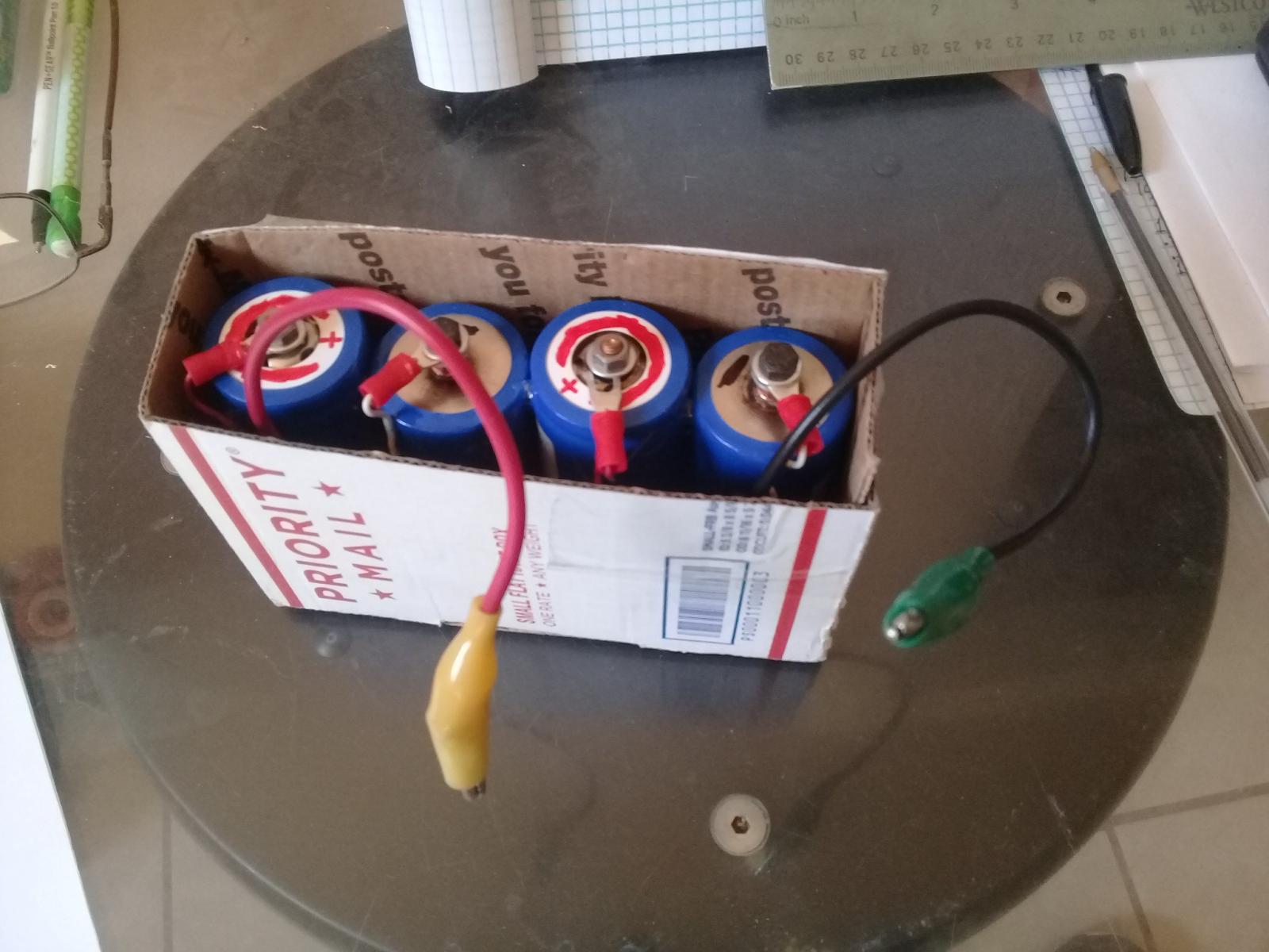

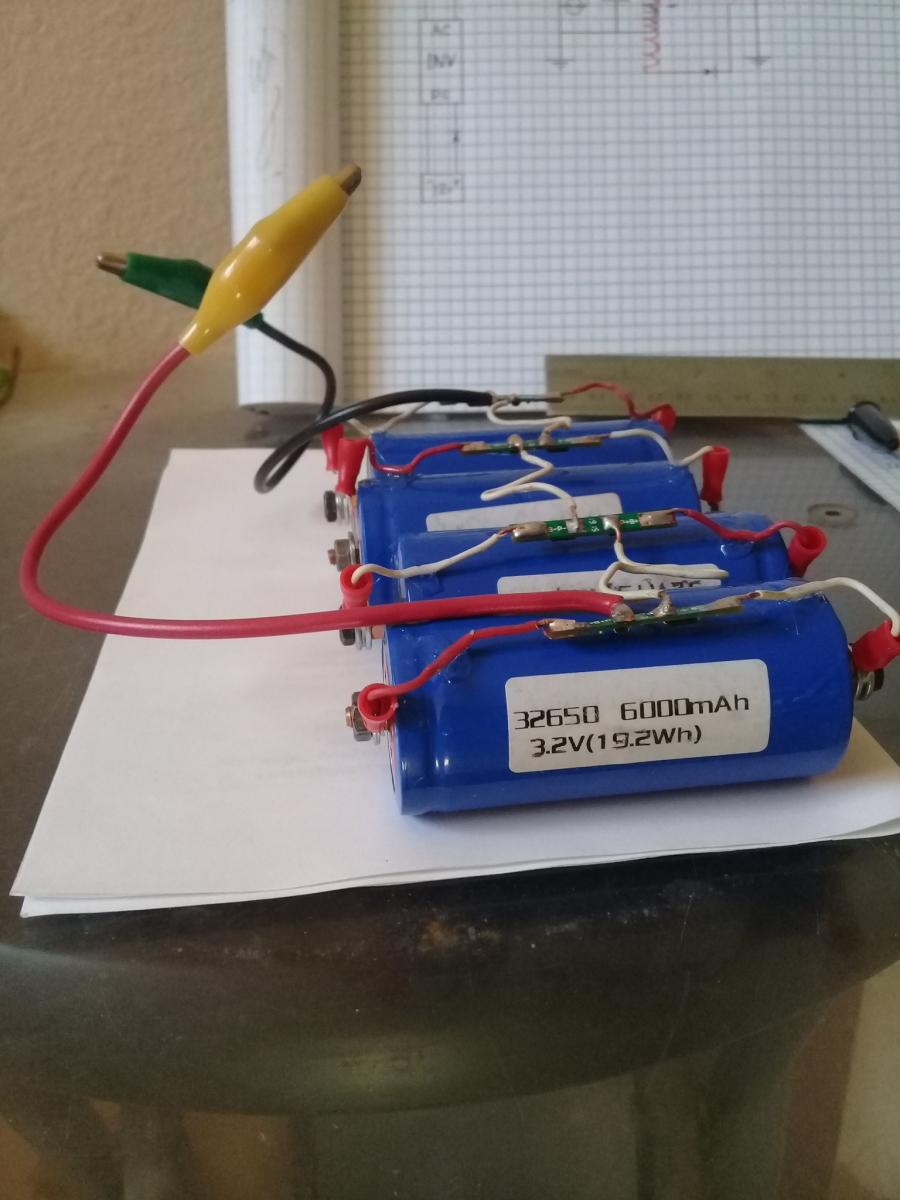

                            Here's something that I just finished...a LiFePO4, 6Ah battery for about $35 (of course, the price might change depending on the box ). These are the first that I have had and I don't know much about them, except that they have less impedance than LA batteries (not hard to do) and they don't explode like Lithium-Ion.
                            Enjoy,
                            Bob

                              good project, BobFrench
                              it can be done with a window air conditioner, adapt the chiller duct to a water bucket,
                              Now if cooling in this way saves energy, we must invent it
                              thanks

                                Nice batt's
