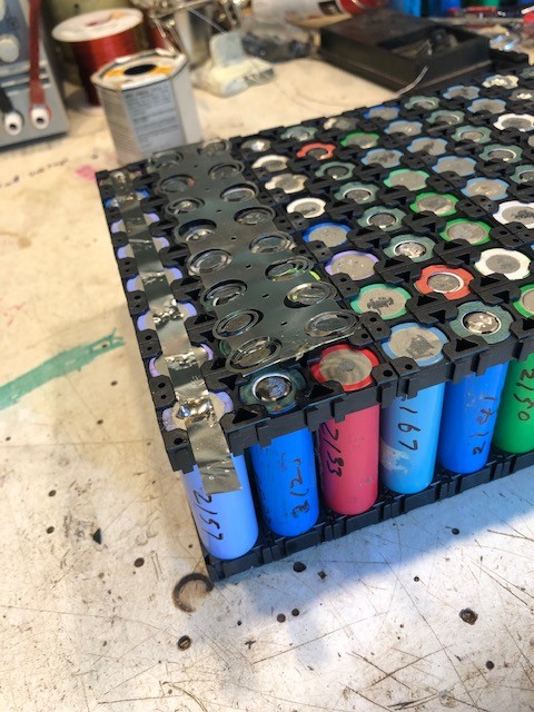

                        • This is the lithium setup I'm reassembling to use as a 12volt battery for experiments. It's a 3s 8p for each 12 volt segment. Notice the top of the "brick" where I started spot welding the tin connecters to the batteries. 3 in series with 8 in parallel. The next to bottom picture is what these batteries were with a BMS on each segment or group of 3s 8p to make the 12 volts. But I took them apart to make the 24 volt stacks in picture below with the UPS pictured to the right. Each stack has 7s 10p or 70 batteries that charge up to 29 volts +-. A 60 amp BMS is installed in each stack. The above brick has five 3s 8p 12volt with 5 groups and I'll leave the BMS off if I hear it from you guys it's ok to do so.
                          Click image for larger version  Name:	IMG_5875.jpg Views:	0 Size:	108.2 KB ID:	510900
                          I am waiting to finish this setup or brick but waiting as I charge my spot welder which is a hand held type not a bench type. Yes I should've waited and kept at lest one brick assembled but you know.
