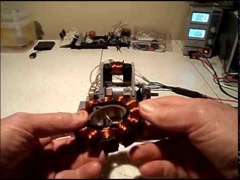

  • First thing I am going to do tomorrow is put in a second core of the new permalloy, since I have lots of those, and see what the combined voltage two coils is. If I recall, I got 96 volts out of a coil pair, yet I am only getting 33 volts out of a single coil. Then I will put in a coil pair of the iron coils and compare.
    I will work on trying to get the longer core to fit in the hole. If I can do that, and the voltage goes up significantly, that is where I will start. If it does NOT, I will unwind a coil and replace the three strands of 1,000 feet with 12 strands at 250' each, and I can see how the combinations affect the coil performance at different speeds with the new core material. I have several spools that have 600-800 feet of #23 on them that I can cut into either 500 foot strands or 250 foot strands, since right at 3,000 ft of #23 is what fits on a spool.

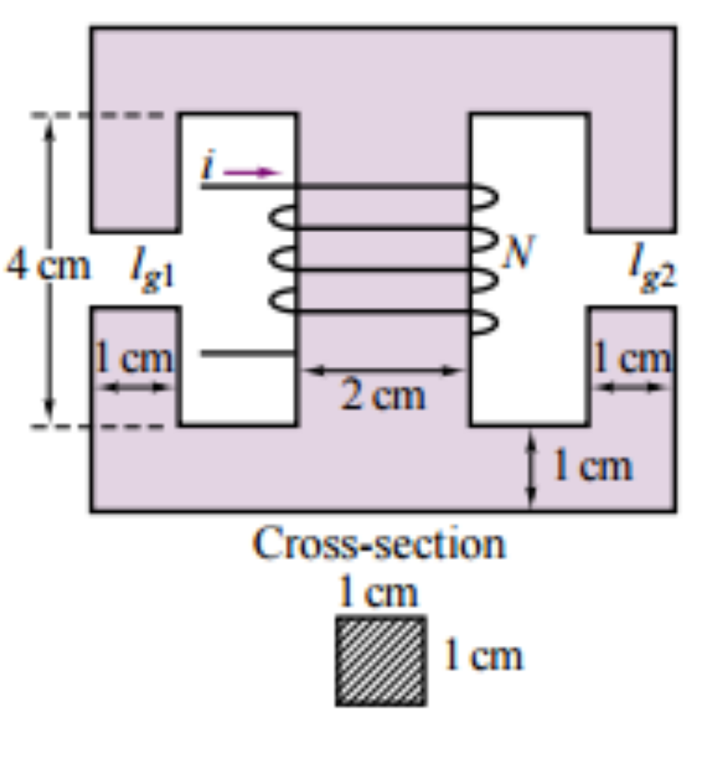

                    Study and understand Ampere's Law and it becomes obvious. Hint. Why are E-I cores used in transformers?
                      Stop asking everybody useless questions and answer yourself if you are so willing to teach. You do not display any ability to help folks understand what planet you are on, any given day. Make statements that you can back up. Asking questions about unrelated facts is disjointed and chaotic.
                      You still have the floor. I will let you know if you are correct
                      • Flux
                          Ampere's Law.
                          ​​​​​​__________
                          So it's the current through the magnetic circuit rather than current around the magnetic branch (as most assume from term 'Ampere Turns').
                          So, compared to C core, this configuration utilizes the 'turms' twice.
                          This is why motor and generator coils are wound around poles instead of the frame section as seen on early vintage dynamos. It took a few years for the pioneers to realize how to save half the copper.
                          But some folks even nowadays have to see it on their bench. So build it and see it for yourself.
                            Ampere's Law.
                            It took a few years ........to save half the copper.
