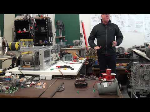

        • Here is what old man MadMack taught us about cancellation of rotor magnets
          • ReGenX Coil Critical Minimum Frequency Operation
              This video is the ultimate proof that his invention has no use.... his effect occurs when he is pump 385W into the prime mover. Then he draws 3A at 12V (36W) and the input power goes down to 360W for the prime mover.
              To get the same 3A at 12V without acceleration, he only needs to put the prime mover input power at about 60W.
              So in the first case, he is wasting 360-36=324W. Efficiency is 36/324 = 11%
              In the second case, he is wasting 60-36=24W. Efficiency is 36/60=60%
              In any case, again, input power consumed is much greater than output power out.
              Time for Thane to be picked up by an UFO so they can teach him the real overunity principle.

                  The prime mover is not run by the battery! It has its own power supply (a variac) and the meter shows the power consumption of the power that is going into the prime mover.

                        Not sure what you are on BLMey, but the first time the voltmeter is shown is here
                        After that, Thane shortly connects his coil to the battery, jumping its battery voltage up to 16V, then he switches his coil off again and the voltage drops back down (as it wants to go back to the 11.08V charge that it originally had).
                        Also, the only other thing that is hooked up to the battery plus pole is a small gauge red wire. That wire couldn't even carry 385W/11.08V=35A of current if it were to drive the prime mover. This is again proof he is not driving his prime mover with the battery.
                        The grey box with turn knob on top that you see is the variac he is using to drive his primer mover and to adjust its speed.

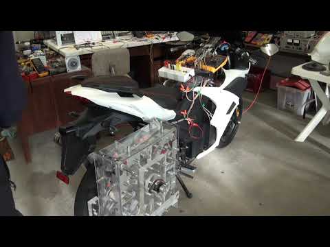

                                You still believe it requires power to rotate mass at constant speed and likely blame Issac Newton for blindly listening to his professors and not thinking outside the box, don't you?
                                And are you referring to this video done by Thane Heinz posted by you? Here:
                                What is Thane supposed to have proved with that demonstration and lecture? Follow this, maybe watch it and take some notes.
                                Up to around the 3:00 marker, the bike is running, wheel up at idle, 670 RPM, -.53A and 76.9V on the battery.
                                He then increased throttle. Now the tach shows 3536RPM, -6.0A and 74.8V.
                                Then he switches in RegenX coils. It speeds up to 3575RPM, -5.4A, and 75.1V.
                                When he shuts it off, the camera is still focused on the ammeter and voltmeter. As you hear the wheel slow down to a stop, the ammeter display drops to essentially zero however the voltmeter value increases steadily to 76.6V at which time he moves the camera.
                                So the current, which he claims is battery current, is -.53, -6.0 and -5.4 Amps. Always a negative value. It's negative before he turns on RegenX and stays negative after he turns on RegenX. It was not charging the battery before he turned on RegenX and was not charging the battery after he turned on RegenX, as proved by the sign (-) of the current not changing before and after engaging the generator coils by his switches.
                                Another telltale indicator that the battery was not charged is the voltage measurement. His first reading at idle was 76.9V at -.53A, next it was 74.8V at -6.0A, then with RegenX, 75.1V at -5.4A, then finally, at 0A, 76.6V, which we'll call open circuit voltage or resting voltage. The battery was definitely not charging at a voltage less than its resting voltage.
                                The whole video is ridiculous. His instruments disprove his narrative and claims. He doesn't even recognize this. That is why I call him an idiot. That is the only thing his videos prove.
                                His own instruments show that the battery never charges during the demonstration. Explain that.
