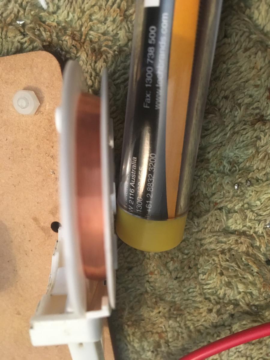

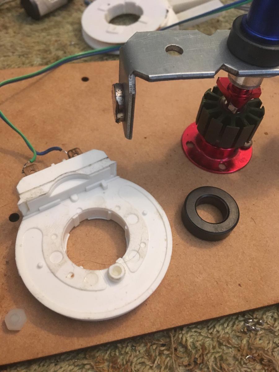

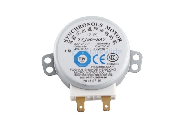

hi all, the turntable motors in microwave ovens have a nifty ready made coil inside that isn’t that hard to get to. the geometry of the winding is said to be pretty efficient for building small pulse motors. i got 2 here. one said 21vac on the back and measures about 165 ohms. the other says 220-240 vac and measures 14.5 kohms.
the ferrite ring in pic2 has an od of about 18.6 mm and with a bit of tape around the perimeter will fit in the coil snug. i haven’t tried that yet but as an air core it spins my rotor up to about 36 hz. 1080 rpm for about 8 ma @ 12v. the high impedance one can’t sustain rotation, but what i want to try is spark gaps 180 dgrs apart on the rotor with a high voltage source and the 14.5 k coil pic 3 in series aircored with the coil mounted in the stator, or with the addition of a hv cap it could be a hv ac charge pump with the right spark gap setup.Last edited by voltan; 06-12-2021, 03:08 AM.
