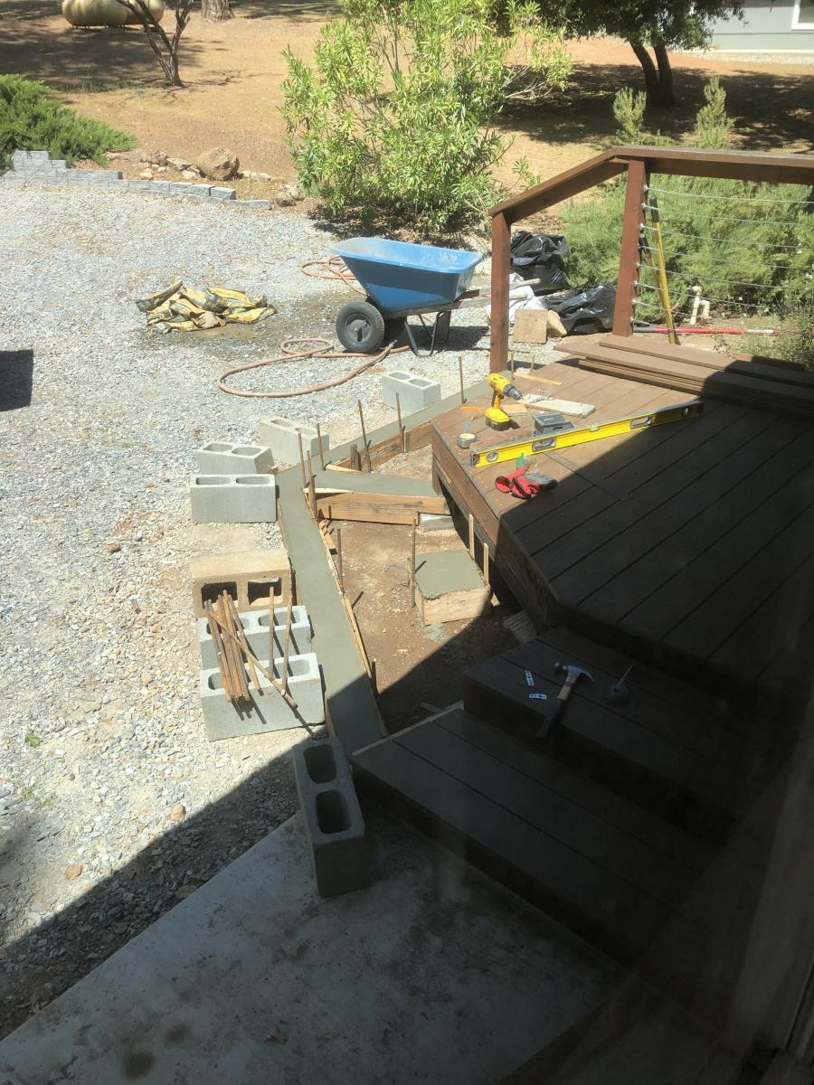

                You were right! I was doing cement today. I have no clue why adding magnets has that effect. I have never seen that happen. Click image for larger version
