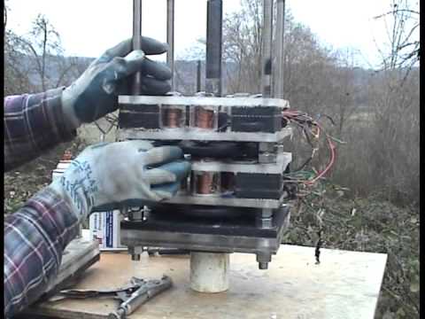

    • This guy is a mechanical genius. If I had the money to hire people he would be up to bat. He just needs a mill and lathe. Listen to the end of the video where he talks hows easy the rotor spins and doesn't "latch up" or cog.
      • What a gift Doug has to engineer mechanical devices. And patient. See video on cogging which is a key element to this work. He is showing a lot of magnets interacting with cores of a double rotor system and spins up with 1 finger. "Strange but it almost wants to run itself."

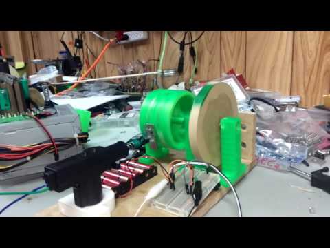

            • 7th graders pulse motor, 4-5 watts input to turn rotor 4000 rpm for large 8" disk and many heavy magnets. Now add regenx coils

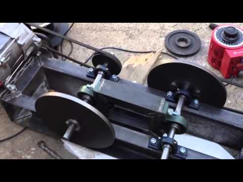

                  • Here is the real deal, he didn't want his belts giggling so bad that they pop off so he made a secondary giggling bar

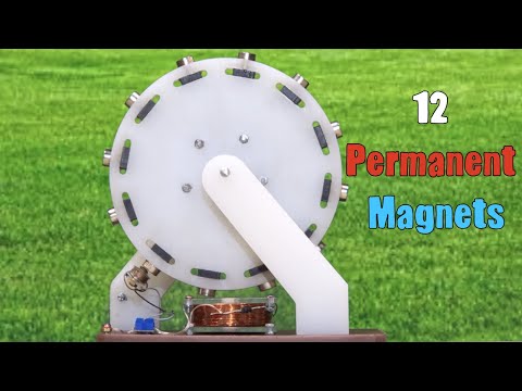

                    • V-Gate magnet motor
                      • Will be a good watch to see just how long the bearings in the bar last. Not long at that kind of treatment.

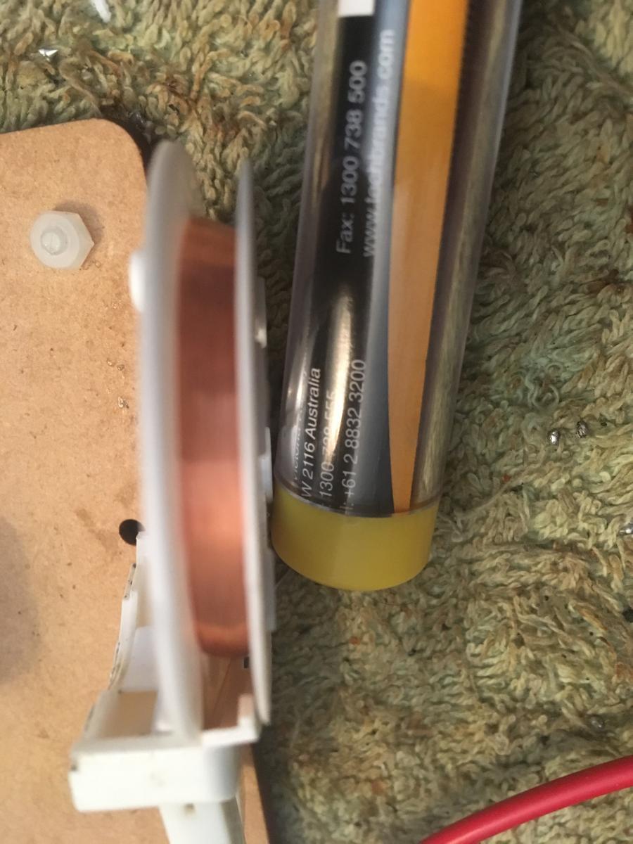

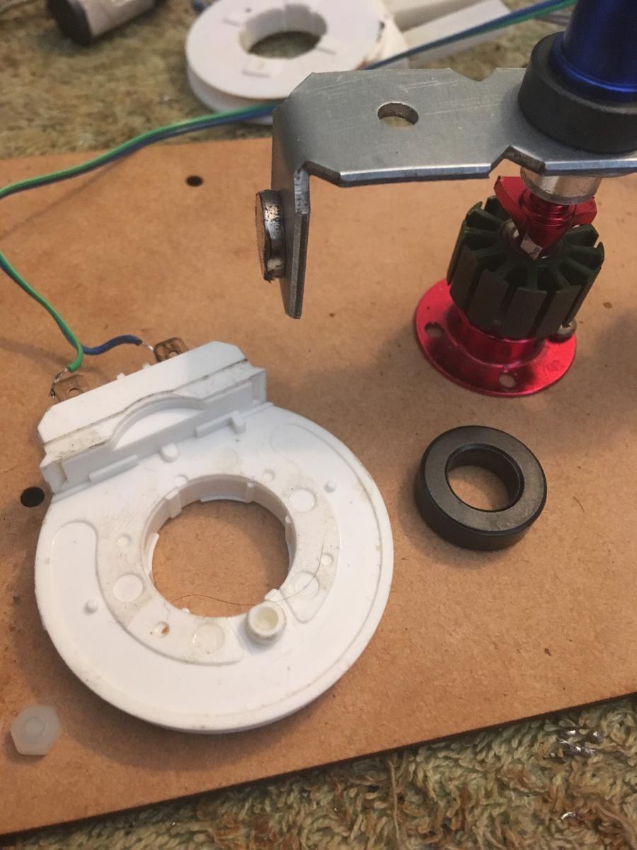

                          • hi all, the turntable motors in microwave ovens have a nifty ready made coil inside that isn’t that hard to get to. the geometry of the winding is said to be pretty efficient for building small pulse motors. i got 2 here. one said 21vac on the back and measures about 165 ohms. the other says 220-240 vac and measures 14.5 kohms.
                            the ferrite ring in pic2 has an od of about 18.6 mm and with a bit of tape around the perimeter will fit in the coil snug. i haven’t tried that yet but as an air core it spins my rotor up to about 36 hz. 1080 rpm for about 8 ma @ 12v. the high impedance one can’t sustain rotation, but what i want to try is spark gaps 180 dgrs apart on the rotor with a high voltage source and the 14.5 k coil pic 3 in series aircored with the coil mounted in the stator, or with the addition of a hv cap it could be a hv ac charge pump with the right spark gap setup.
