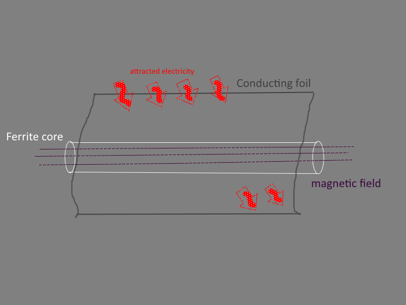

          in the above proposal using a large foil is a good option :
          the simple drawing show the ferrite core, your magnetic field lines, now there's as much attracted electrons along the foils, it's like emulating the serial ETBC behavior ! but we can't use the S-ETBC in a ferrite rod only ring is suitable for this, the reason for this is the variable inductance created along the rod so each ETBC will oscillate in different frequency but the effective way is to let it oscillate in the same frequency , using a large foil in a relatively long rod is a great option .

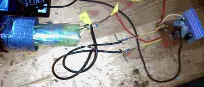

                just starting building again after gathering some missed electronic pieces, the first step is building a working Mazzilli driver, since it's stable and powerful driver in other hands the MOSFET remain cool, the frequency can be adjusted just by changing the tank capacitor that feed the flyback transformer , the oscilloscope is needed to watch the wave form , so you can calculate the inductance needed , another simple pieces needed is coil 32 V 11 free software that will help in calculating the needed inductance , frequency or capacitance ..
                the following photo show a part from reverse engineering work :

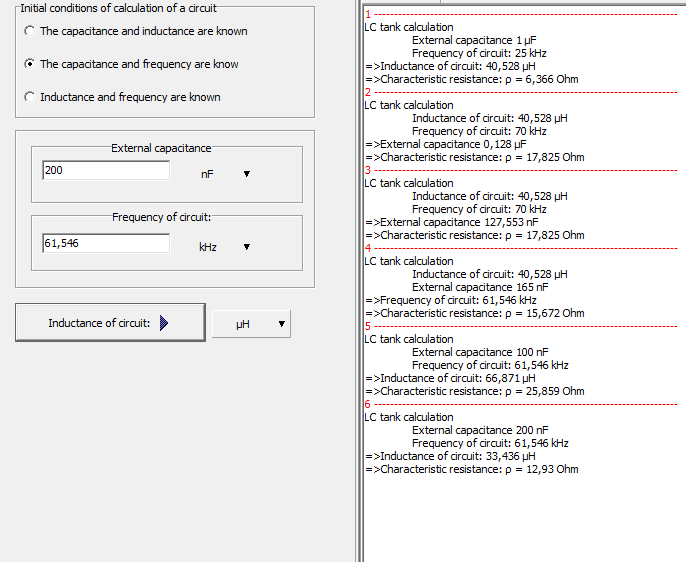

                the idea is very simple indeed, imagine you have a 200 nf / 15 kv capacitor that will resonate in high voltage, the resonance in high voltage will just create a reactive high current that needed to excite the ETBC, when you measure the frequency of Mazzilli driver here i mean the tank circuit connected directly with flyback transformer you find for example 25 KHZ , 25 KHZ is good but since you don't have more than 200 NF capacitor probably you need high inductance connected in serial with the ETBC to produce the needed inductance to achieve the resonance , here it's better to work with the lowest possible inductance so the oscillating HV tank circuit can get even higher current , another important point must be watched carefully is the high voltage leave the flyback transformer, when working with 25 KHZ the voltage will be high around 45 KV and it's very high , i didn't measured the high voltage but from arcing length it can be predicted .. anytime the frequency of Mazzilli driver is increased the high voltage will decrease due to the impedance of the first coil work in low voltage ( X = 2π F L ) the secondary coil of flyback will see the higher frequency due to the large turn number needed to create the HV again the voltage will decrease , changing the frequency and watching the length of arcing will tell you how much frequency is better ,
                now you know the value of L0 which is the first low voltage coil connected with the Flyback ( 10 turn as described in MAZZILLI circuit ) in my case L = 40.5 UH , the capacitor connected with this coil is 165 NF that will give 61.5 KHZ , the same frequency will leave the HV transformer but i have 200 nf high voltage capacitor , coil 32 software will do everything as shown in the photo the needed inductance will be 33.4 UH .
                at this point you can build an ETBC with 33.4 UH but it will take a lots of time and resources ... large ETBC will have large resistance and this will decrease the excitation electric current especially when Aluminium foils is used, the solution is to use a few turn ETBC made using a ferrite rod , in my case it's a home made ferrite core where the magnetic permeability isn't as off the shelf ferrite rods but it's just good since the magnetic field will find a path and this will help the ETBC to oscillate perfectly ,
                the important factor is the electric current , because of this we need another coil connected in serial with the ETBC , for example if the ETBC has 1UH inductance and you need 33.4 as total inductance the added coil have to have 32.4 UH as a simple calculation 33.4 - 1 = 32.4 UH .
                THIS coil will help us too much because when you put your L2 coil around the ETBC to take the power the overall inductance can't be affected too much so the resonance is maintained ..

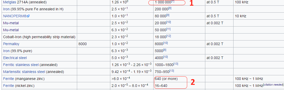

                              Copper for sure has something to do in this device even i expect it to work with Aluminium foils only, but the core is the most critical part , the following photo show the difference between relative magnetic permeability of different materials , without doubt the results will be greater at least hundreds of time when using the most powerful magnetic materials , for sure there's other option but it need a deep breath ..

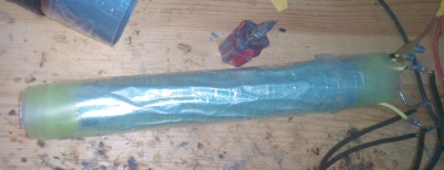

                              • this is some photos show the discussed arrangement using an ETBC around a ferrite rod, for the mazzilli to work with this design there's some parameters as limit for example in this design i used 14 NF as capacitance side of the ETBC, the inductance is 1 UH , the width of the foil is around 20 CM each foil is 50 CM length , the oscillation frequency is 1.5 MHZ, in fact this is a very high frequency and the amount of radiation seem to be high also so you can see the wave from a distance ( around 1 M you have to test .. )
                                if someone want to replicate this design it's better to decrease the frequency below 1 MHZ charging the capacitor seem to be very fast even 4700 UF / 50 v can be charged in less than 3 sec , good earth ground play a critical role ..
