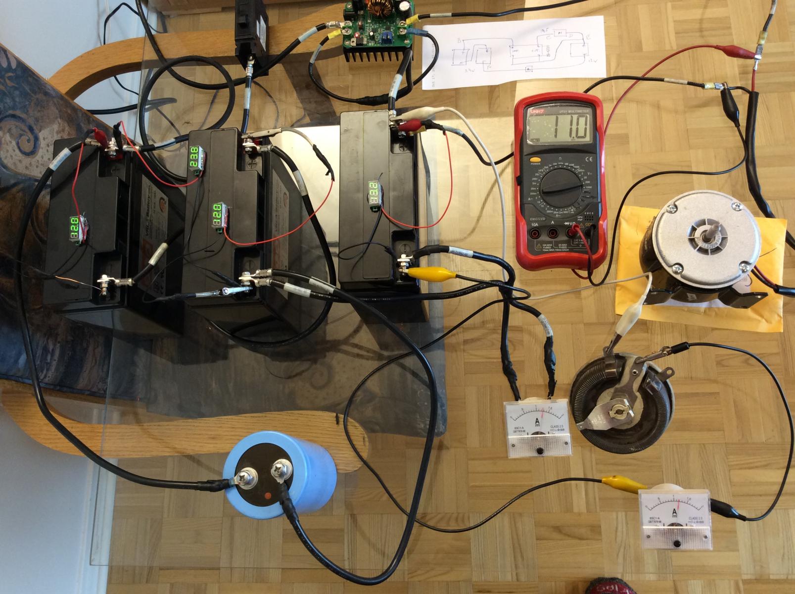

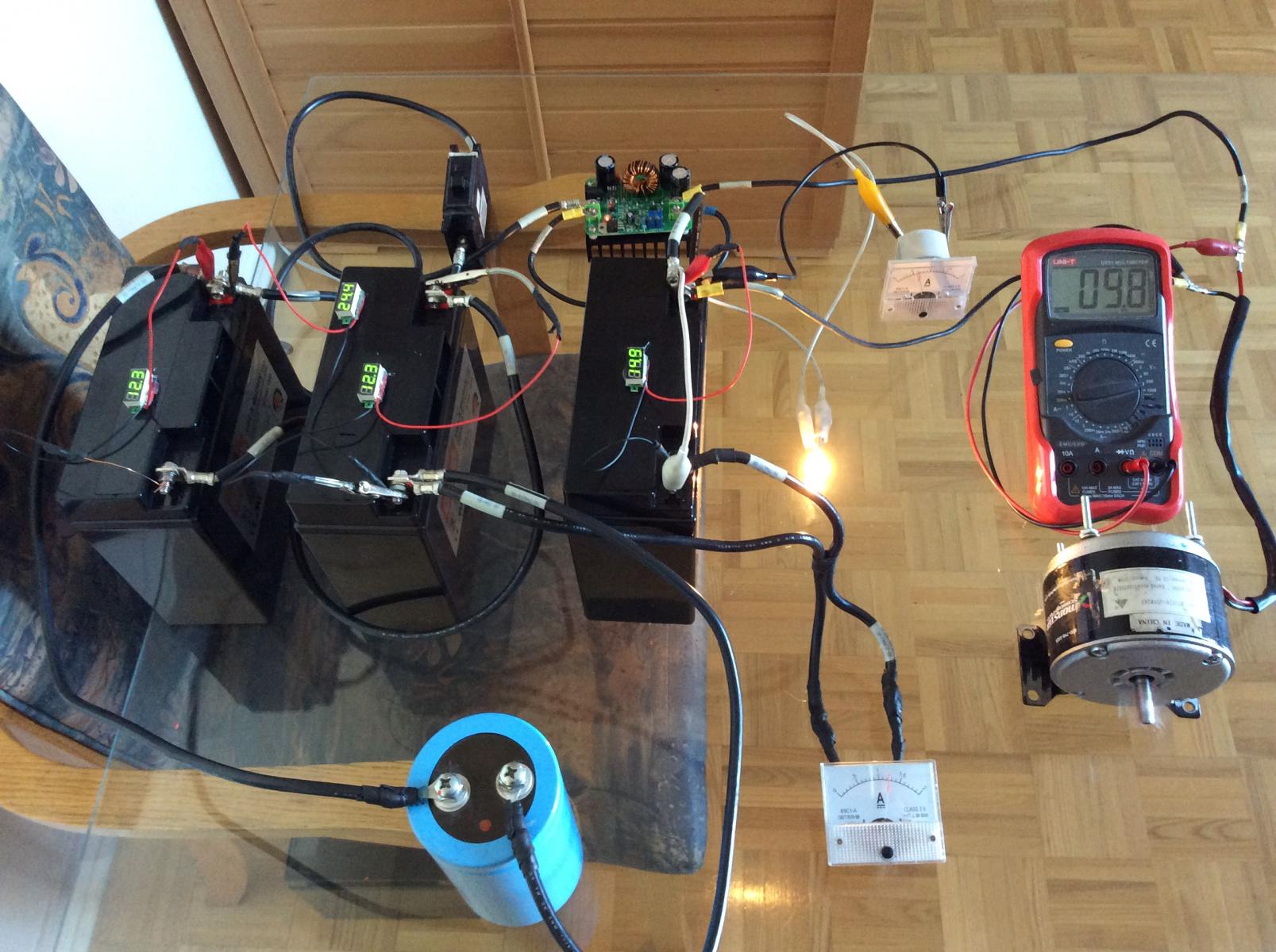

Yes, I balanced the motor. It was 40' each side of 6 strands of 30AWG, Litzed. I had plenty of room left over. Dave put 80' of the same. He's looking for his tach, but said it pulled strong.

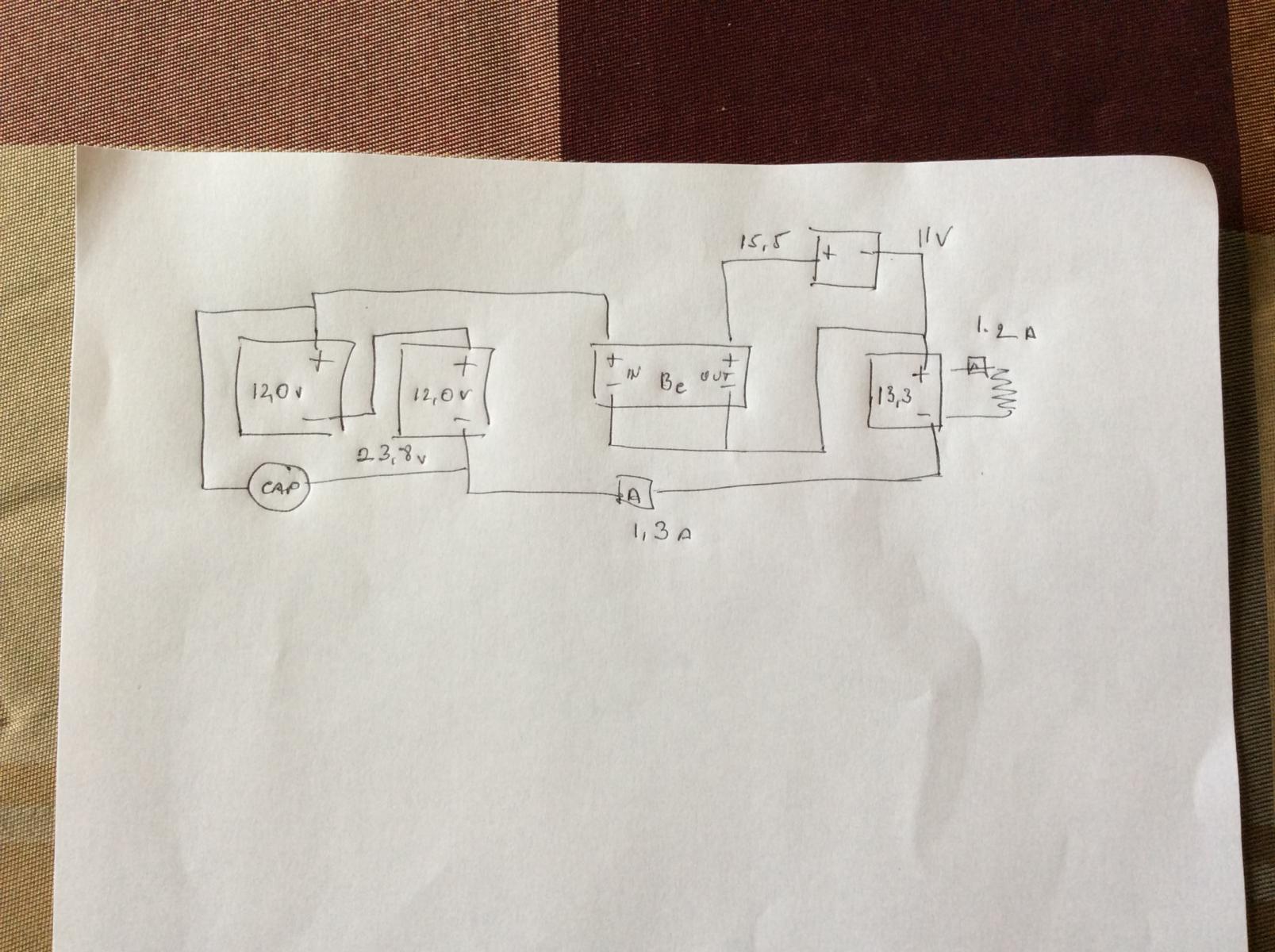

My results were done with a single Battery, about 11.98V under load. The 3BGS will run about the same, but the voltage keeps changing as Battery 3 rises. The voltage is often between 9 & 11V.
