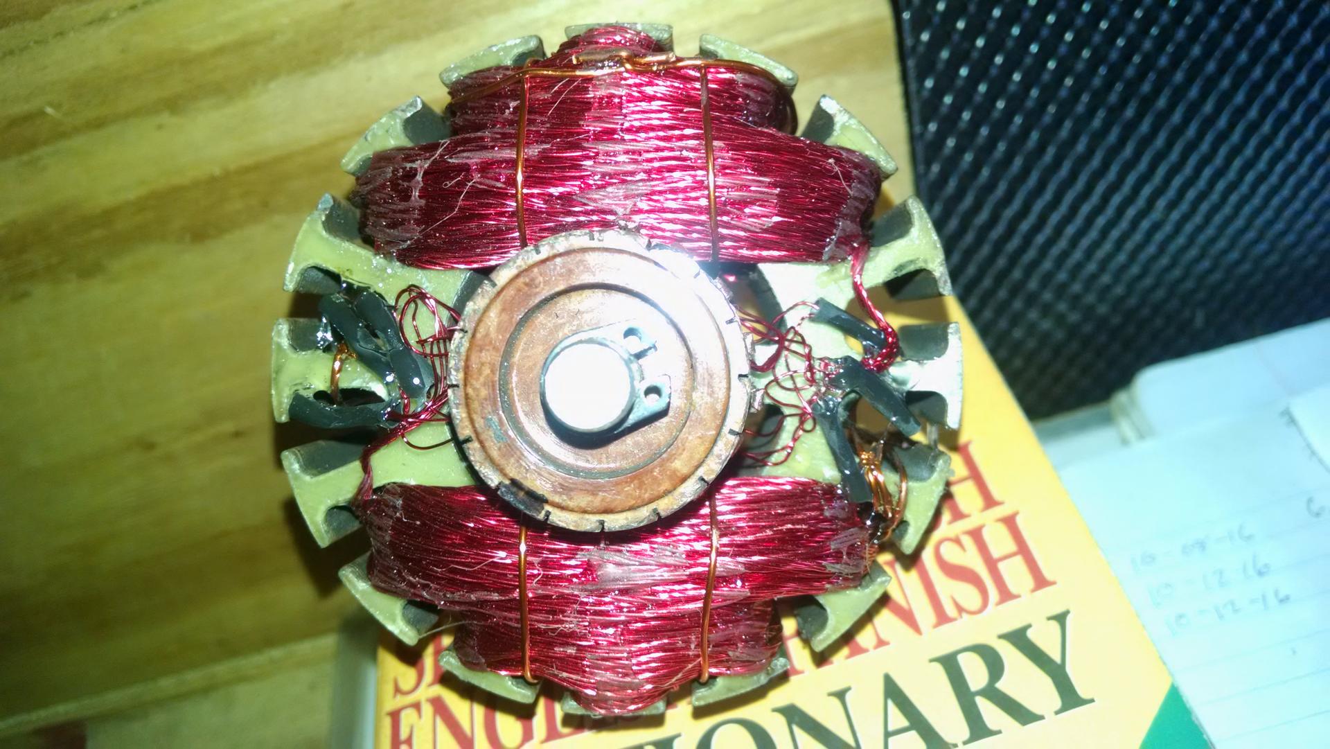

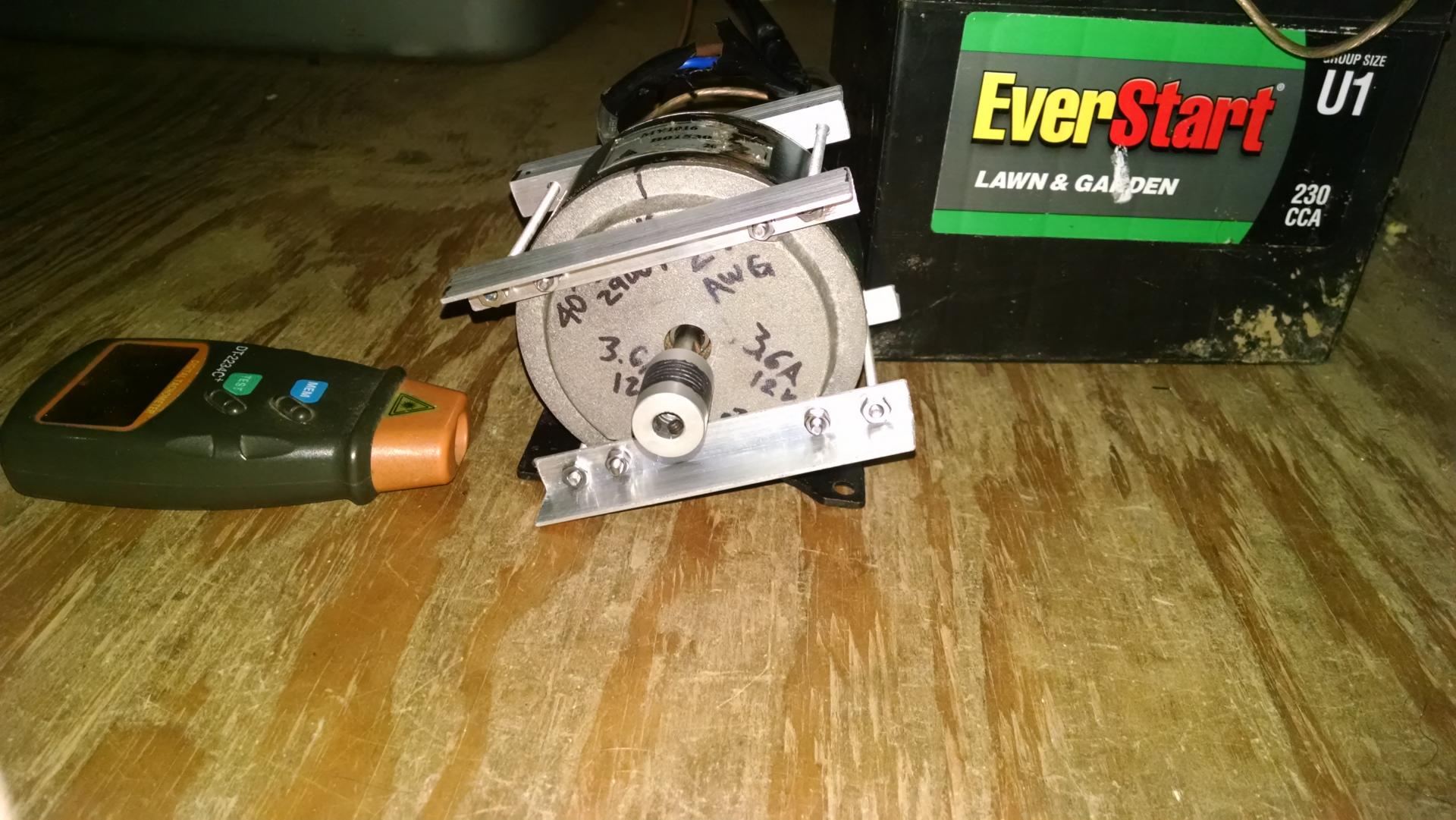

I had some time to think about it so let me elaborate. Before my timing alteration the motor was not self starter. Second and important point is that as I had it on the scope I could clearly see spikes when motor switches off and when it engages again. The negative was higher amperage drow and lack of tork. Naw as the timing is altered the motor runs stronger cooler and is practically self starter. Additionally my brushes stay clean ( I had som burn marks before). The off time is reduced naturally better tork. Now as I am satisfied having all this settled I ask myself ithis; is the sudden switch off that I am after even if my tork is reduced. As it is presently running smooth and cool perhaps I am defiting my objective. So before we all jump to conclusion I would like to have batteries in place and see results. Real reason for modifications is creation of this charging spikes and residual tork free work no matter how large or minimal is there for taking. I would be happy if the modification of timing does not hinder effects we are after.
As for your question the modification of timing is minuscule, something about one centimetre. I drilled new holes and the space in between where old screws where and bruishes plate is. You. have enough place to drill it and only difference is that lug nut is on outside. When you look at the brushes plate inside drill to the left of the present trhreded hole in the empty space to the brushes holder. Rotating brushes plate alone is to complicated because plate is riveted and grooves in plate is snug around holes, brushes space is also limited. Hope it helps.
